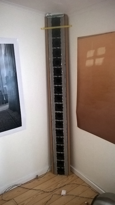

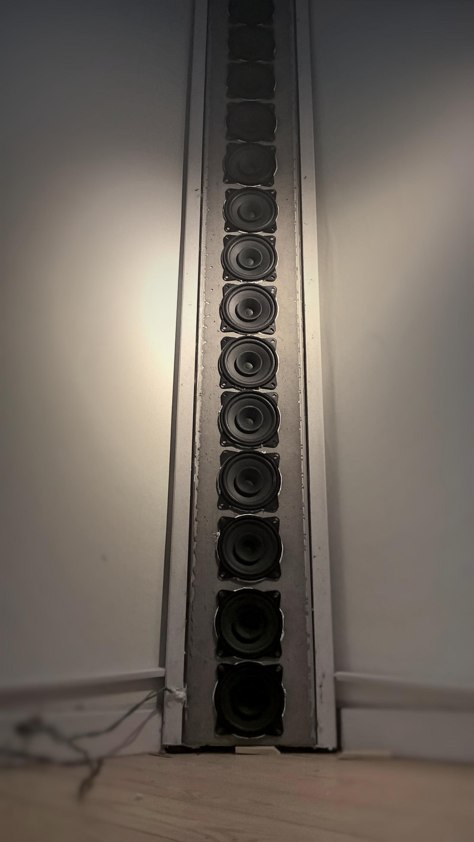

Today some tweaking. The baffles are still only "leaned" into the cabinets so no bass but some resonance? Still very positive!! Measurements in listening position.

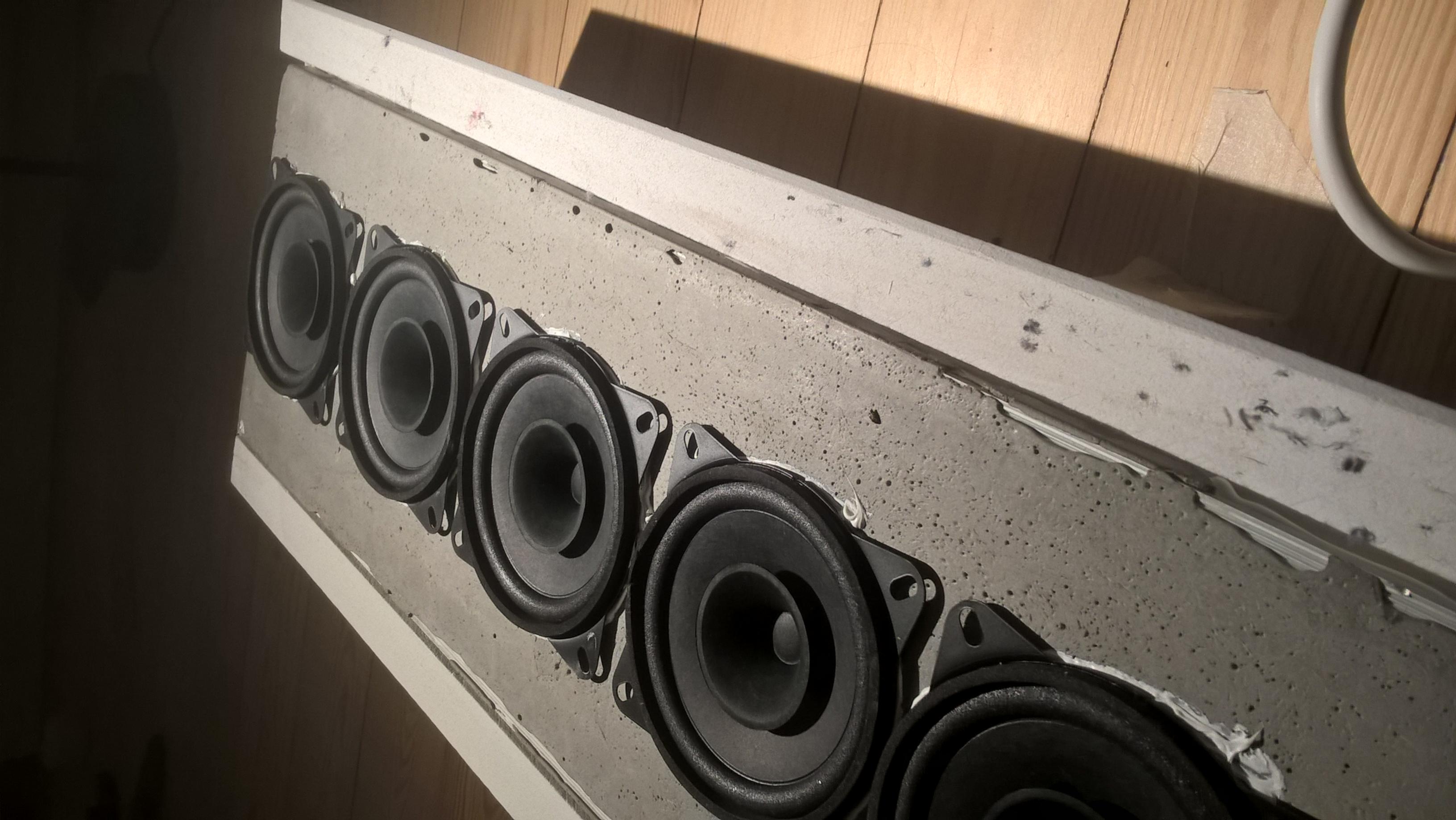

the song of 144 metallic wings....

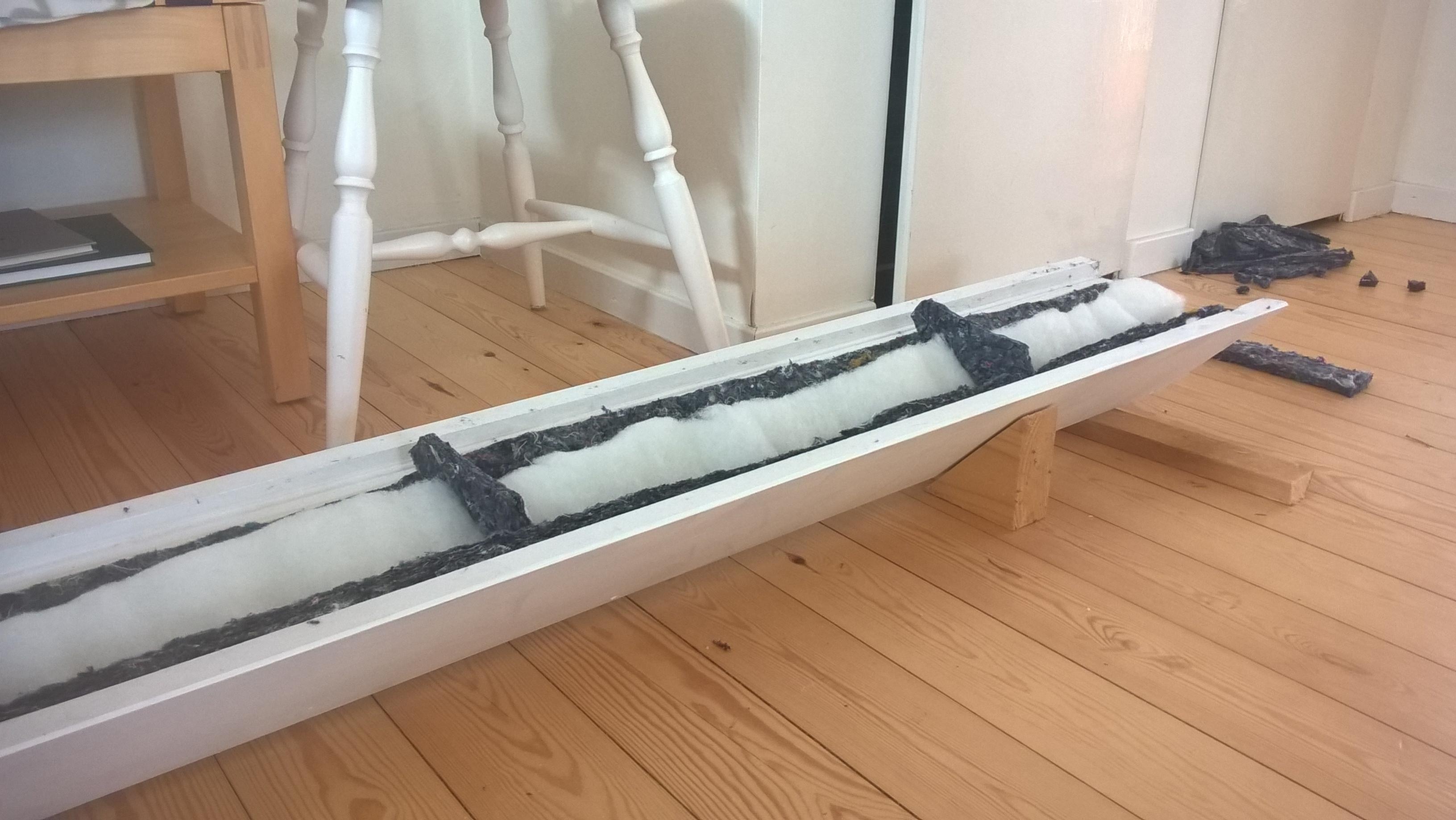

The driver has these wings for mounting and when as I have done, mounted from the front, the sit there and sing their high Q song. To be fixed. As well as the long gaps beside the baffles meeting the cabinet. This will probably elevate this to even higher stratosfärs
I hope you'll find a suitable solution. Most of the fun is just starting out, much more to come I'm sure...
Now you know why I have a gazillion bolts holding my baffle .
What is the seal between the baffle and the enclosure? Butyl rope is good stuff!
You'll find a way I'm sure. There's a lot of potential in these speakers!

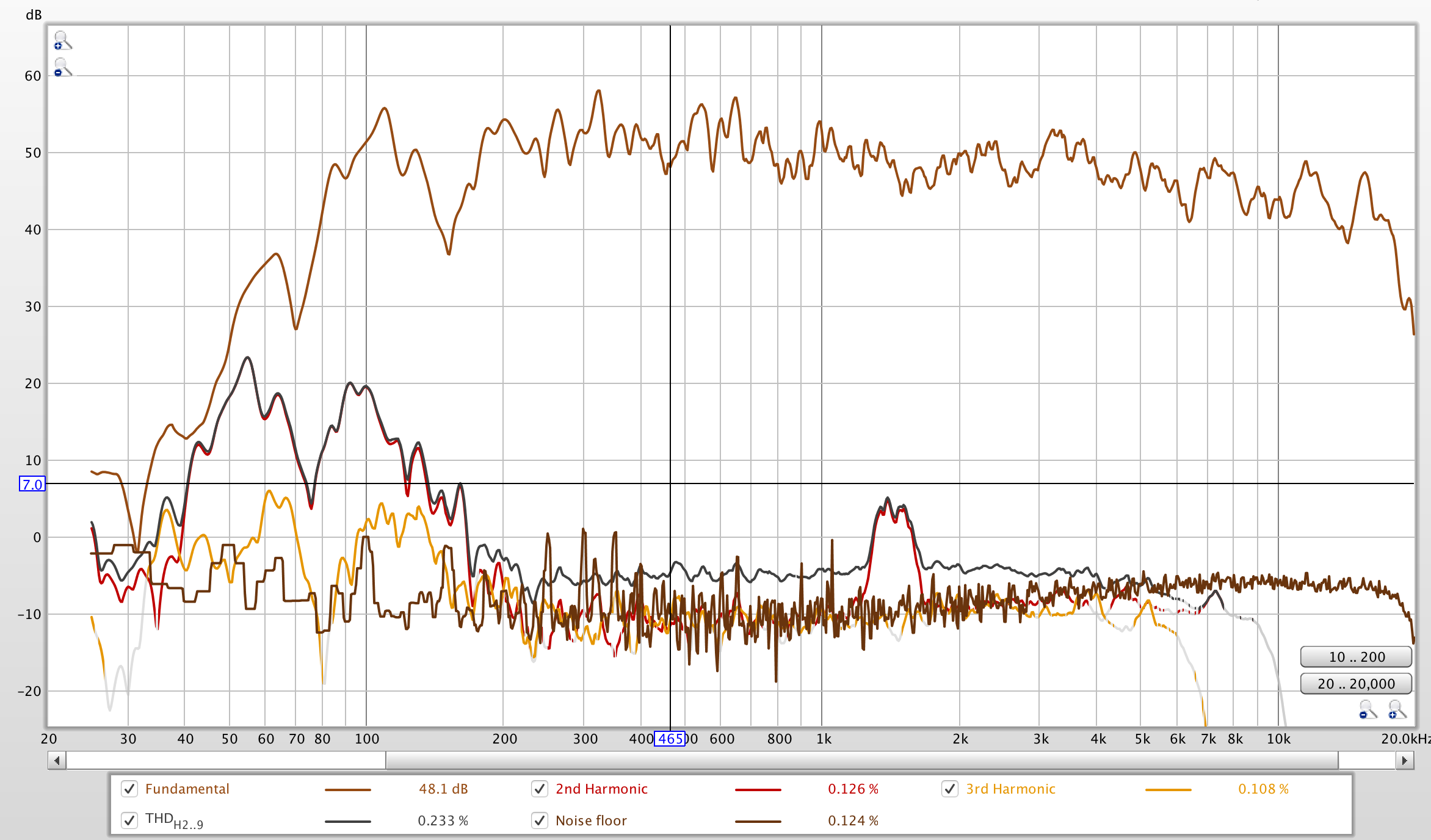

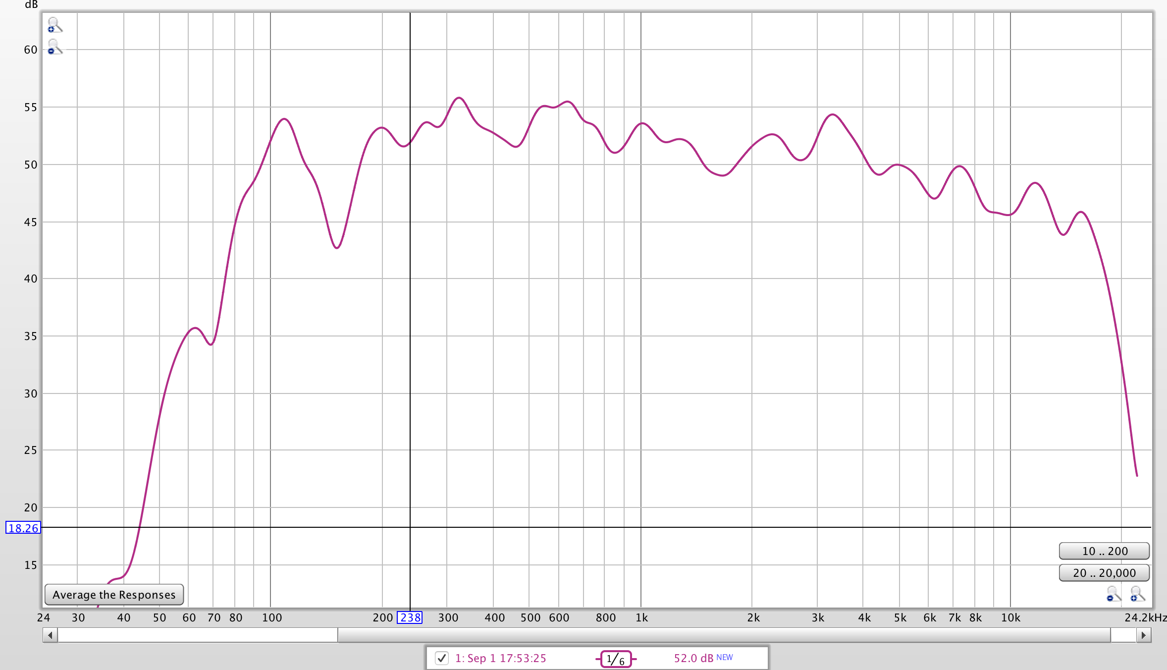

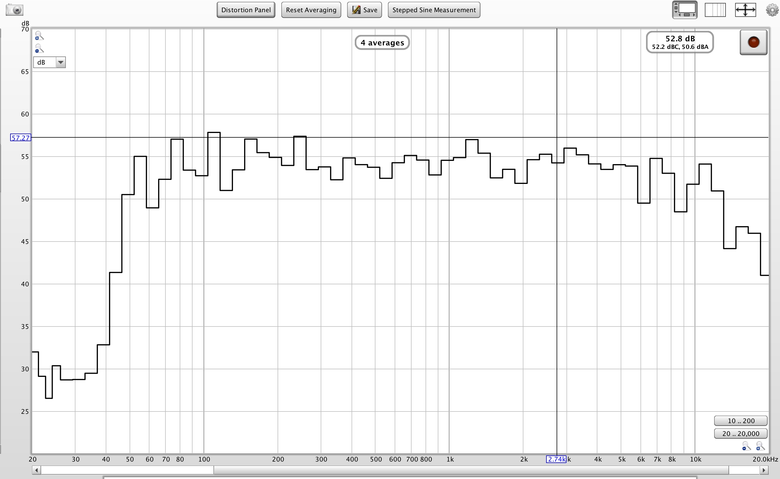

Swinging my mic (m!) around my listening position gives this...//
Is that measurement just the arrays or is there a sub as well?
- Full Range
- My FR10HM corner-ceiling-floor-array
