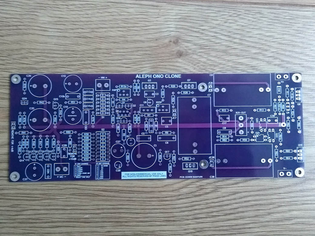

Ono: PCB layout
Here is my PCB layout

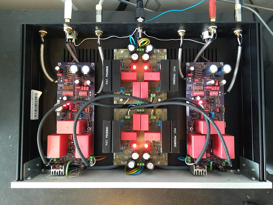

Voltage Regulator
Salas Shunt Regulator (v1.2R) producing +- 30V DC. I incorporated the K(Keantoken's)-Multiplier into the PCB, but somehow, the latter didn't work well, so I by-passed the K-Multiplier and directly connected the input of Salas Shunt Regulator to the unregulated DC coming from my filter bank, which is housed in a separated casing along with the toroidal transformer

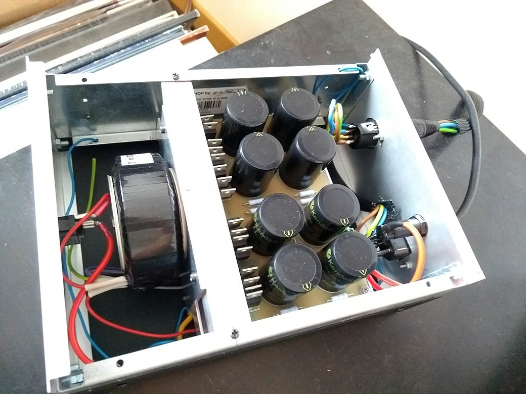

Unregulated DC power bank
This is the PCB of the unregulated DC power bank for both L + R channels. I'm using MUR820 diodes as rectifiers and Kendeil K05 electrolytic caps.
