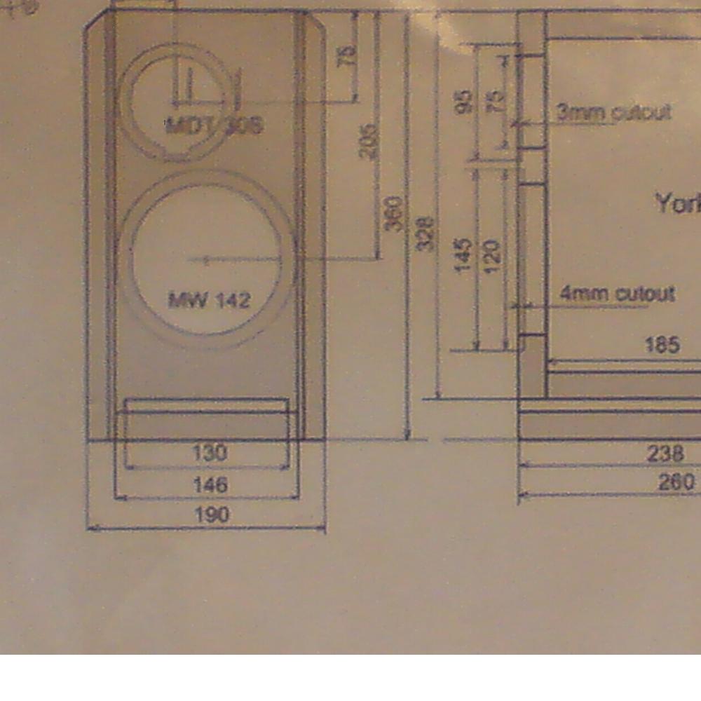

Thanks Thawach, Yeah a copy of your x-over would be helpfull, The reason I was going for a sealed box is that I thought it would be easier to design and build? (Am I wrong?) I am a carpenter so I'm confident with the building of the cabinets, I'm just working at getting them designed properly!
Thanks for that andy, Thats a big help. That looks uncomplicated enough for me to do. I was thinking about going 3-way but the moneys a bit tight just now, I'll see how I go with these and hopefully build a better set next time. If I wanted to make these speakers floorstanding, Would I just make then to the size I want and seal off the compartment for the speaker and port, Would this effect the sound of the speaker?

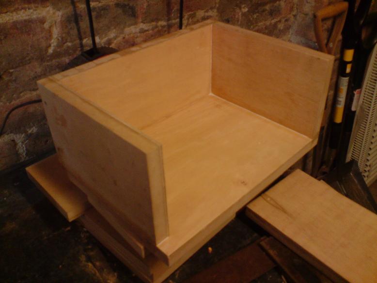

Hi there again, Just an update, Started my speakers last week, Got some pics, And a few questions! Firstly I couldint get 22 MDF from the local B and Q, So used 18mm MDF with 4mm ply glued to it, Is this likely to have any effect on the sound? The other thing was that on the speakers I am building the recess for the woofer and the tweeter come very close to the side of the baffle about 1mm at each side!. Although onece the sides are on this gives me an extra 22mm on each side, Has anyone had any expierience of this, does it just mean I will have to router the baffles onece the speakers are all togeather, Or is there a way of having the baffle removable, looking at the plans I cant see a good way of doing this. Sorry about the picture quality,

Ply on MDF should be fine.
Just route the holes after assembly, and you'll be fine.

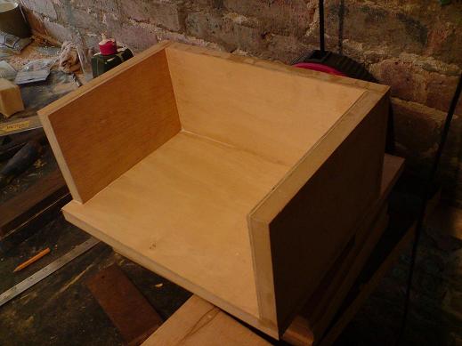

Hi again, Just got round to doing some work on my cabinets at the weekend, Made some progress, Just need to sort out my crossover,
I inlayed a piece of oak into the baffle like a strip doen the middle seams to look ok just now but i'v not painted the cabinet yet, worried about the paint being thicker than the varnish.
