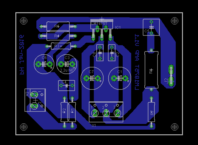

My First LM1875 amp
After lurking around in this forum for years, I'm tempted to build my own LM1875 amp.
The amp would be powered by 180VA 18-18V CT Transformer.
Here the schematic and the layout.
I adopted ESP and Daniel design, and AndrewT suggestions on others thread.
Suggestions and comments are welcome. before I etch the PCB.
Many thanks,
-- Peter

One issue I have is your connecting the small signal ground at the point where the output Zobel connects to ground and this goes through a trace to the main ground area where the bypass capacitors are. At high frequencies, heavy enough current can flow in the Zobel and cause distortion or oscillation of the amplifier. The input ground should be moved to have its own path direct to the main ground area.
Where is the output return pin?
What are you using for source? With my mobile phone, higher impedance loading on the output sounds better so now I aim for 200kohm minimum for my input impedance. You're currently at about 47k which you could increase.

Thank you for your analysis, but there is R7 to separate input ground and main ground, but if you think it's not enough, I will try to separate the ground path.
The output return will be directly connected to the Power supply star ground, Is that OK?

A 1 ohm resistor will do very little to keep induced voltage in the ground out of the high impedance of the input.
OK on the output return.
Keep the input bias resistor as you have it or even better, at the datasheet value. Any proper line in signal will have no issues and less chance of noise if the input source goes high impedance such as its power is turned off or cable unplugged.

I see a few things that I would do differently, but it's time for lunch and I'm hungry. In the mean time I recommend you take a look at this - Taming the LM3886 Chip Amplifier
Tom put a lot of good information about circuit layout and stability in there, and while it's based on the LM3886, the LM1875 is from the same chip lineage so everything still applies.

Thank you for all the inputs and suggestions, You guys awesome.
Layout had been modified, better gnd path separation, as suggested by johnr66
Will experiment with the impedance values after finishing the amp board.

Unless Rod gave a specific reason, I'd use the datasheet values. The engineers who developed the IC likely put it through a battery of tests and came up with those values based on the results.

I think he tries to separate the low level signal earth from the filter and output ground. Not wise to directly connect the imput ground to the output ground.
In some cases even a 2-3 ohm is put to the input ground before connected to the "main ground" to somewhat filter it a bit more.

Agree, in my circuit all default components using either datasheet values or calculated values from overture_design_guide.xls spreadsheet.
