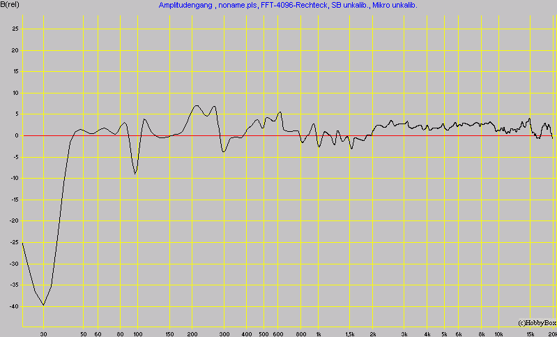

its good but i dont like those 2 10db holes!
Could easily be some room interaction or ground-bounce.

The dips down at ~100Hz and ~380Hz vary with mic. position, and look last picture here http://home.tu-clausthal.de/~tpa/port/index.html the 100Hz one is there measured at same position with completely different speaker (150mm sealed enclosure compound isophon) Must be some room interaction there.
Its possible to supress the peak at 200 to 280 Hz somewhat, i don´t really know if its better in sound now:
crossover parts count climbing, weight of crossover component reaches the weight of other peoples speakers....
I more and more have the feeling more components are fighting room response and not speaker response anymore, as measurement position does the most differences on cuves.

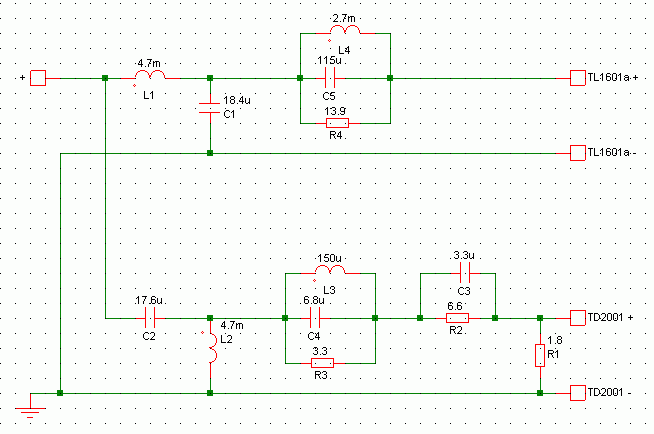

could i please have some guidance by crossover experts? is that crossover totally nonsense?

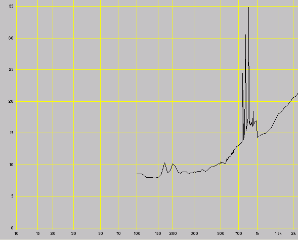

The tweeter impedance in crossover region is about straight 8 Ohms. The bass goes from 8 Ohm at ~300Hz up to ~ 14Ohm at 1000Hz.
So what was intended for linkwitz riley 540Hz is more like LR 540Hz for the tweeter and maybe 540Hz Butterworth for the bass. should i use at the bass something like 6.4mh 13.4uF instead?

Your doing and learning some really great stuff. Before your can really rely on your measurements, you need to be able to know what's your speaker and what's the room. Can you see the comb filtering in the early graphs? The log freq scale makes the combs look closer in the hi end, a lin scale would look like an evenly spaced comb.
Do you understand hancocks post? Don't "fix"room problems in your crossover.
Know this, even the early graphs are very nice! You should ignore what are clearly room distortions. Can you look at phase with hobbybox? Perhaps take a look at http://www.sat-live.com/
Then you will be able to see phase and measure with music, not noise.
