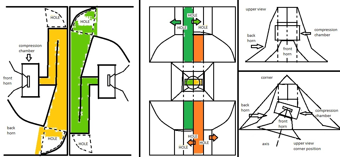

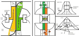

I guess this is the right place to post this...
Copied from my Autograph thread:
Look. This is a "transformer-like" evolution of the Autograph, but which can be placed anywhere (not corner loaded, in principle). The good quality plywood sheets measure here 2.2*1.2m, so I guess 2.2m is the height and 60cm the depth... We need three of these to make the core. This is a folded rear horn, split in two, mirrored horns: one goes down and the other goes up
A hole must be done in the panel to allow the horn to be completed.
The front horn is not indispensable, given the driver. Absence of front horn (present speaker with only lower bass horn) makes the speaker disappear, litterally.
I will chose AN super10, so the front horn will be there, probably.
In fact, it can be made to accomodate corner placement IF: the final shape of the bass horn has a 90° base AND we make the compression chamber connect to the throat in an angle that allows the driver to face listening position! Yeah! That would be cool.
The schematics more or less show that option.
Thank you, dear.
I can even design an air tight system to articulate and pivot the compression chamber-driver-front horn complex to the desired angle, with respect to the throat of the rear/bass horn.
I could prolong the upper bass horn to reach the roof, at 2,4m...as rooms have 8 corners, not 4...
First, I am going to modify the existing little speaker to accomodate another bass horn in mirror image and see what happens.
I need my vacation.
M.
I need my vacation.
M.
First step: build new boxes/chambers for the AN super10 and fit them into my existing rear horn loaded prototype.
Step two will be building the upper rear horn.
Step three will be building the whole new double rear bass horns, as showed on the previous diagrams.
Step four will be building the front horn for the medium frequencies.
I tell you, knowing these kind of speakers for a while, I cannot imagine how anybody could be satisfied with its sound unless one uses the front and rear horn loaded horns to increase midrange and bass, for they are very HF prominent...without using corrective passive circuit, that is...what is the point of using a full range driver if we will use some electronic components between amp and speaker anyway?

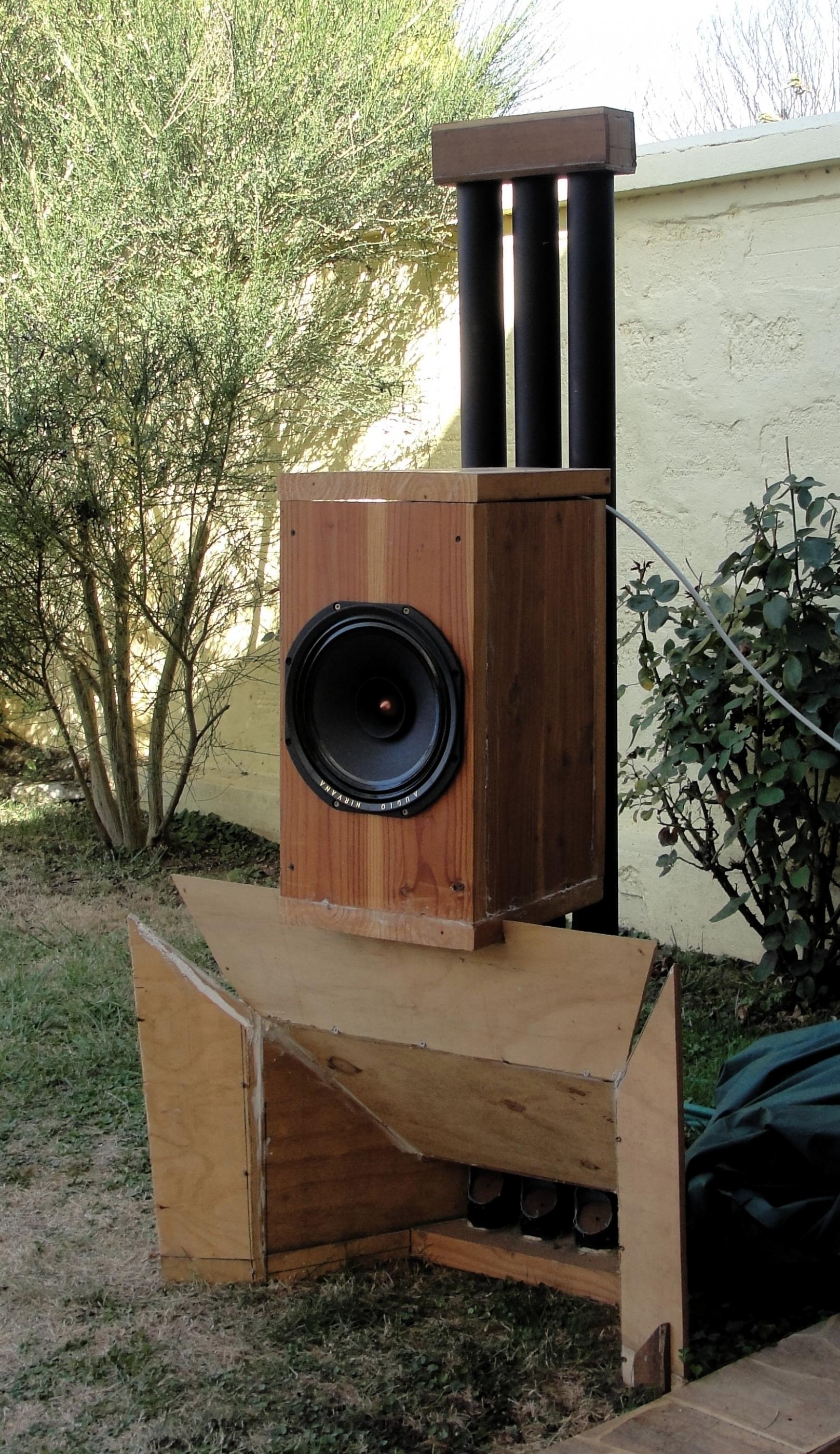

There may be some resemblance to the Panpipe BLH that is at present, just sims and design...
http://www.diyaudio.com/forums/full-range/236779-panpipe-pentahorn-blh-speaker.html
Do you have any simulations of your double BLH corner horn with front horn yet?
