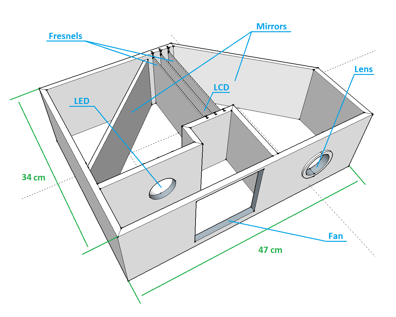

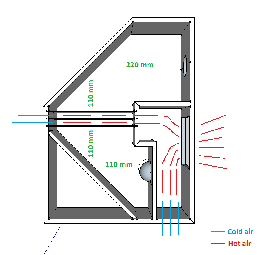

Hello. I'm new here and I'm newbie at all the projector stuff too :) So I decided to build a projector. For LCD screen I will use old eeePC 8.9 inch. The netbook will be integrated in the projector. I ordered some fresnel lens (F220 mm for back and F330 mm for front) from optolife. I wanted 150/220 mm but didn't find. I will use two mirrors (do you know where I can find?) and projection lens from OHP or from my old Mitsubishi XL8U with a broken lamp. For a light source I'm thinking about some LED - 100W for example (any advice?). Will use 120 mm fan for cooling the lamp and the lenses. I attached some shots of what I want to do. What do you think about the whole thing?
