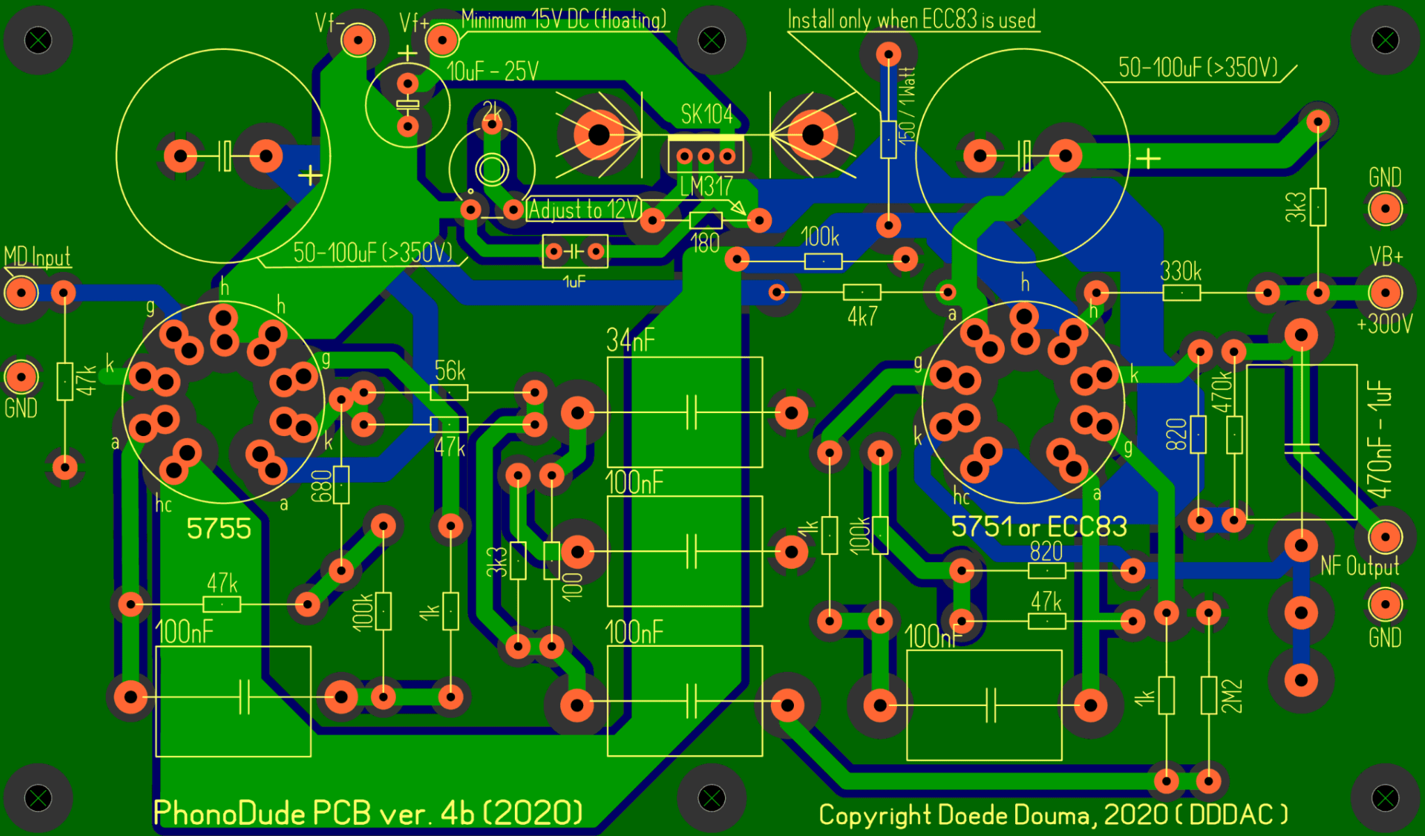

Maybe someone could make a pcb for the phonodude. A popular design in the Netherlands with many happy users. Or perhaps the Trafomatic design which was put in the public domain. I built the bigbottle when the pcb was still being sold...haven't used my turntable much....but it is a great phono stage...
.But I've been busy collecting parts for the trafomatic for years...actually think I have it all....but for folks who are intimidated by point to point a pcb would be great. Anyway..point is perhaps we can get some group buy...project together.

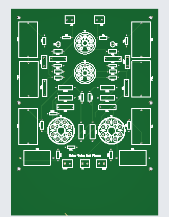

https://www.diyaudio.com/community/threads/valve-itch-phono.140635/ another one to consider building a pcb for..sell it on diyaudio store....
Just found a gerber for the itch: https://www.diyaudio.com/community/threads/valve-itch-phono.140635/post-5999918

I already did 3 years ago
