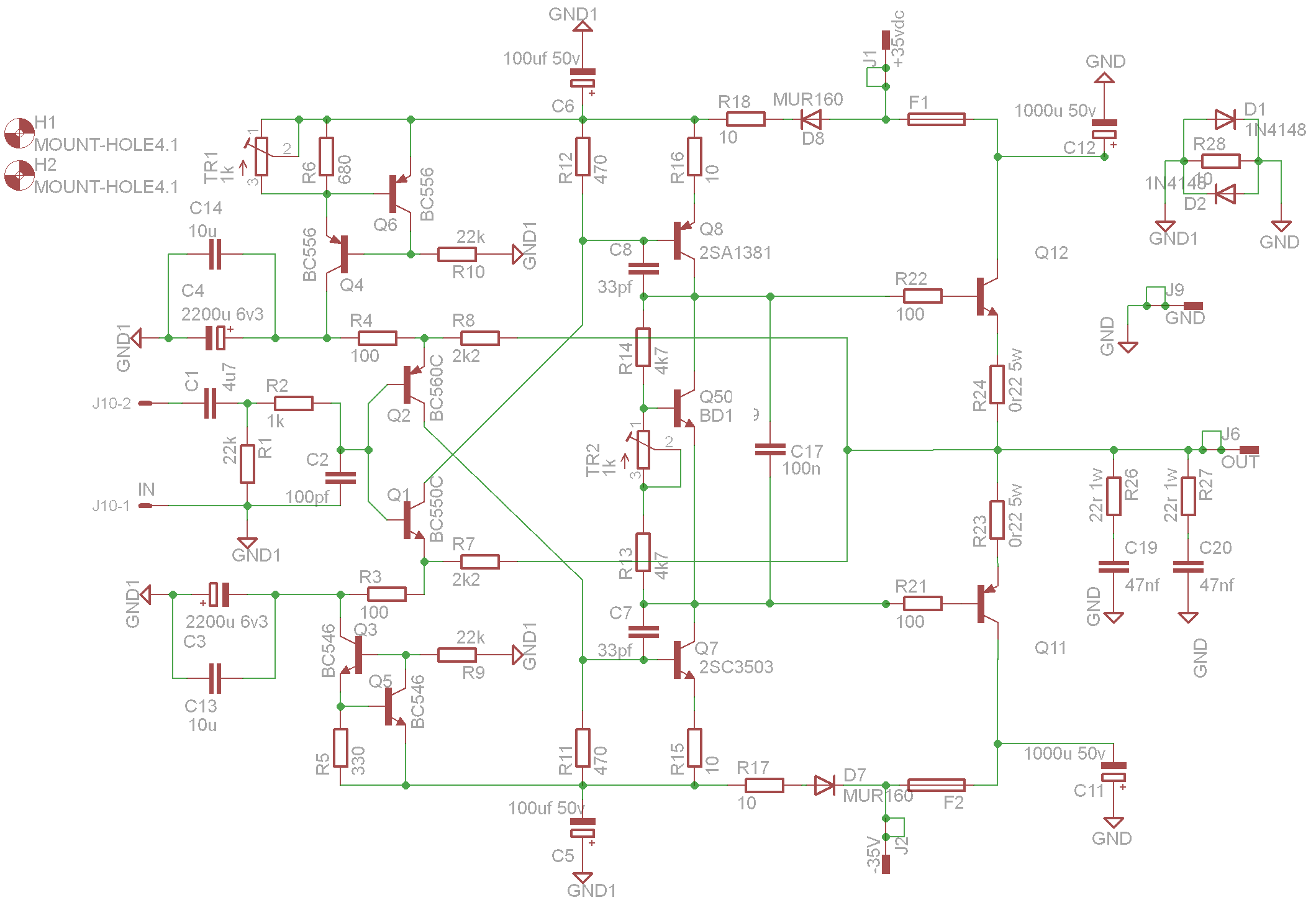

ashok you right your heatsink way too small for these amplifier
Let s go back to the beginning. The amplifier was designed to run it max 50mA bias or so..
The emitter resister supposed to be 0.33R not 0.22R.
That would give the amplifier lot of stability!
But here we come,
Increase the bias we get better sound so we push the amp close to its limit.
The good news we do not need to give up to get better performance out of the amplifier. But we need to re adjust the thermal sensitivity
With two pair power BJT does get more stable, adequate size heatsink must, we have to figure out to make the amplifier less sensitive to heat produced by the power BJTs so get less bias drifting.

AndrewT and Bigun : I think the bias is quite sensitive to temperature right now. The bias does drop as does the heat sink temperature with some air flow over the sink. So the conclusion that it is still not really stable enough is probably right. I tried some variation on the bias spreader but it didn't work. However putting the bias spreader right next to the power transistor has reduced the bias drift , not eliminated it !
I'd prefer over compensation to under compensation as it's safer !

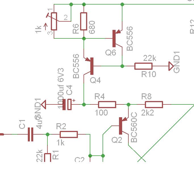

I think I have the solution or something that's acceptable for the bias drift problem.
Spent several hours chopping tracks and wires and testing the end result.
So a modified bias spreader and it's transistor mounted close to the Darlington ( any one of the two ) seems to let the bias wander +/- 15 percent or less over a period of 2 hours . Ambient is about 32 deg C and there is no air flow around the fins oriented vertically. Bias was set to 100 mA after 30 minutes and then it was monitored.
The modification is something I have seen on some Jap amps and is also described in Bob's book on Power Amp design ( page 291 Fig. 14.9 c ).
I used a resistance of 22 ohms but this is not final. The correct value will determine if it is over or under compensated.The important thing is that it does appear to mitigate the large drift problem. As expected, changing from a NPN to a PNP bias spreader did not appear to make any difference. I finally used a BD140 for further experiments.
So bias stability will be determined by a combination of , the location of the bias spreader transistor , the effective thermal resistance of the heat sink and the compensating resistor in the bias spreader.

I ran the amp hard till the heat sink got so hot that you couldn't touch it for over a couple of seconds. That would make it over 55 Deg C at the fins.
I didn't measure it.
I shut off the music and the quiescent current dropped to normal very fast and stayed stable at about 110 mA even though the fins were still quite hot.
Next I ran the fan and the bias dropped only by about 10 % after about 20 minutes.
So this configuration is going to be stable at 100mA. No doubt about that.
Note that the current heat sink is really small.
Maybe I'll make an assisted output stage and bump up the supply voltage. Should be an interesting experiment. If it blows it should make a big bang I guess !

When you tested can you post the full schematic. Easier to imagine your mode if the whole schematic is posted. Specially to those people who follow the thread.. think about to build..
Also I think about to implement the CSS front end like LC.
I'm sure that would work much better than the noisy zeners. Of course the resistor values must be calculated.

I have been monitoring the output with a scope. I did not see any RF problems until it clipped. But I will check this out with a stiffer supply soon. Have not yet looked at the square wave.
I have to get started on the stereo pcb now otherwise testing will get delayed. I'm off again after 2 weeks for a 10 day holiday!
I have been using the amp without an input capacitor all this while ! The cap will make a difference and I want to avoid using one. However I will check out different caps and post the listening results when the amp is in stereo mode.

The schematic is correct......................
I used a resistance of 22 ohms but this is not final. The correct value will determine if it is over or under compensated...................
It is an inverted version of D.Self's Vbe multiplier and importantly has the VR in the be side
It also has the D.Self resistor. Others have investigated this resistor and reported. The resistor is NOT a tempco. It is compoensation for changes in the current fed through from the VAS.
Very low VAS currents require a higher R value. I'd guess 22r suits VAS I of ~3mA.
15r suits ~ 7mA, 8r suits ~12mA.
You can check this (just the Multiplier with an adjustable CCS) on a plug board to find the optimum resistor for the current you plan to use.
The VAS transistor talks to it's complement.
In the quiescent state this "talking" is ONLY DC.
As soon as the VAS starts handling an audio signal, the "talking is an AC signal. The Vbe multiplier gets in the road and tries to interfere with the "talking". To minimise this interfering ability, you should connect the VAS to it's complement with a good audio capacitor. The AC passes through the cap. The multiplier is now left to try to maintain the correct bias voltage (DC) to keep the output bias current stable.

As I understood it , as the output power device draws more current the base current also increases. This is an additional current passing through the 22 ohms and hence reduces the voltage available from base to base of the output transistors ( = KxVbe of bias spreader - I( through 22 ohms) x 22 ) and hence the ability to reduce some current in the output stage as it's quiescent current tries to increase.
The 22 ohms does not sense temperature but reduces available dc bias voltage to the output devices as their current increases.
Bob has explained this in the book.

The amp sounds very good. Raising the bias to 100mA appears to make the mid range sound a bit smoother. Not sure if that is real . Will have to test again at lower bias. Getting tired of changing the bias so many times !
I don't see many posts on this thread. Looks like very few people are actually trying out this amp.
I forgot to mention that a regulated supply does help a lot. It keeps the voltages and current quite stable. However this can also be achieved by zener stabilisation of the supply to the small signal section of the amp. Providing a regulated supply for that stage would be ideal. Something like Ilimzin provided for his implementation of the LM7294 amp. Alternatively you could use separate taps on a transformer ( not everyone could do that easily ) .
However this amp with the TIP142/147 might not be safe with 100mA bias and +/-40 V supplies. At high volume and rising heat sink temp the power devices might hit the SOAR limit causing blue smoke. About +/-35 V seems to be OK. But at 100mA the heatsink must be much larger than what I have used. You might still need to monitor it till you are satisfied that it's playing within the safety limit under all conditions.
Considering how the amp sounds the LatFet is the safest bet but a discrete Darlington should be explored. That will be able to handle higher voltages and a 100 mA bias current and be thermally more stable.

Hi Bigun,
As you also found out the LatFet version is stable.
The Darlington version becomes unstable at high bias ( 100mA and above) and if the heat sink is small. However with the modified bias spreader ( with the extra resistor in the collector of the bias Tr ) it is stable.
But there is still one catch. The dc bias does go up with high junction temp ( while playing loud music ) and could go up enough to kill the power transistors if operating on the borders of the SOA curve. Removing the music signal brings the bias down very quickly.So with +/-40 V and 100mA or more isn't exactly a safe thing to do. Certainly not with a small heatsink like mine but needs to be tested with a large sink. I'd say the TIP 142/147 might be safe if used with a max supply of +/- 36 V and bias current less than 100 mA. It sounds very good at 50 mA too.
To get to higher voltages and current you need to use Lat Fet's or discrete Darlingtons ! The discrete Darlington is really worth a try.

Please take a look, opinion or and advise welcome on these circuit.
For the BD139 I will test a darlindton device after I power up the amp.
I do like the front of these amplifier all do several thing is different, have to be tested which is closer to my taste - like the feedback
Greetings G
Greetings G
Hi G,
With the CCS the circuit is slightly better with respect to the output offset voltage and output bias current over a range of supply voltages.
However the PSRR appears poorer if you don't have a capacitance multiplier on the input stage supply line.
Remember to add the 22 ohms on the collector side of the bias spreader transistor. Note change of base connection on that side for the power transistor. Makes things more stable.
Times up ! I'm off again on the 16th and couldn't build the stereo board or the P3A ! Time really appears to be in short supply.
Blew the Darlingtons by using it at +/- 42 V and over 350 mA bias current. Didn't really do it intentionally but happened due to a set of goofs while fiddling with the board. But it did run for quite a while in that condition ! Not bad !
The stereo board will most likely use LatFet's . I have to choose between LatFet and Bipolar. Since I need a new power amp for my new coaxial OB speaker , the LatFet would be ideal. Bass will come from a sub.
