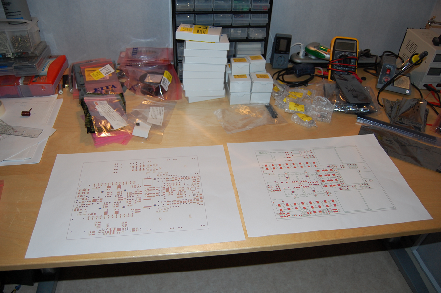

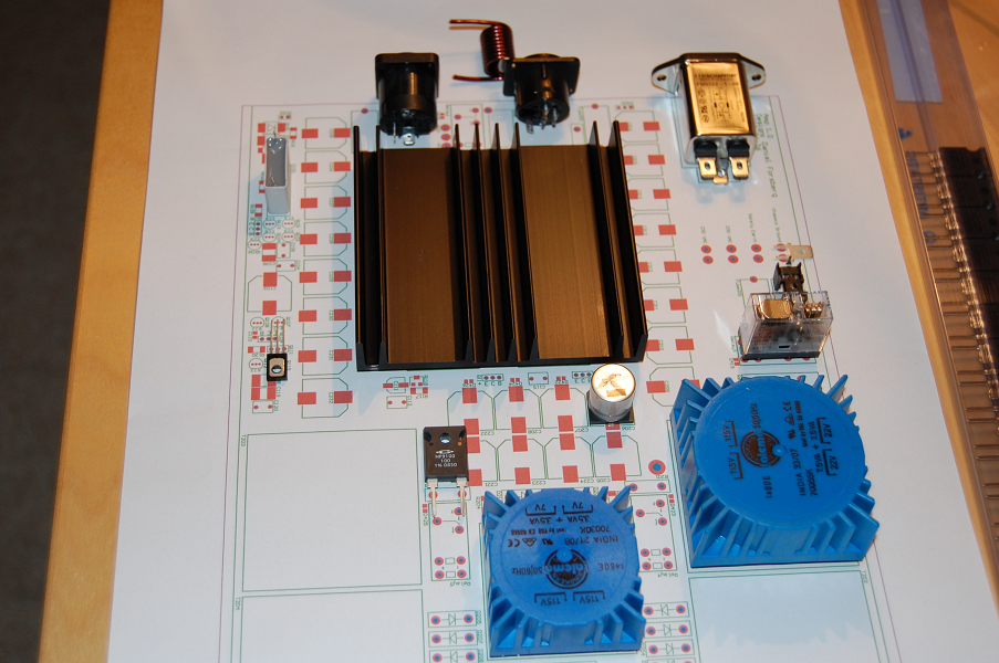

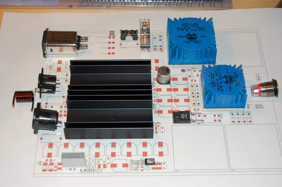

I'm going to order the components for the amps tomorrow. And when I get the components I'll match them to a printed 1:1 layout schematic to make sure all footprints are ok, then I'll order the pcbs.

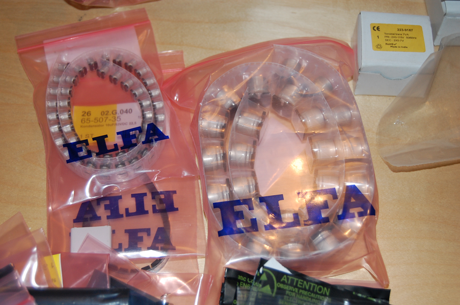

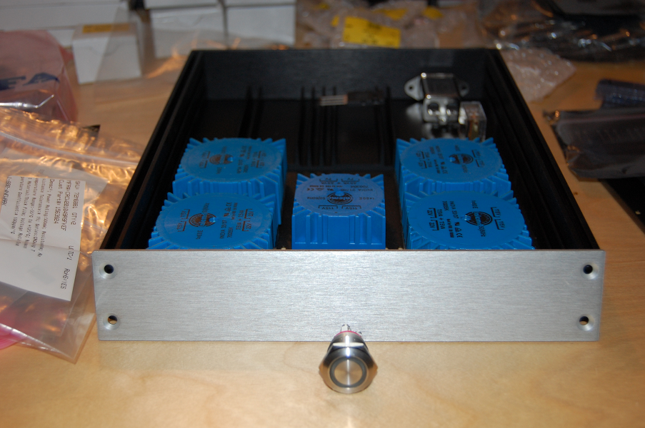

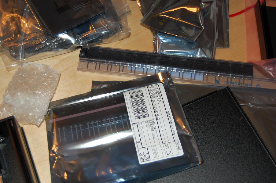

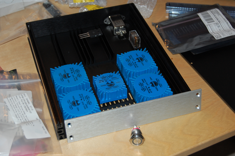

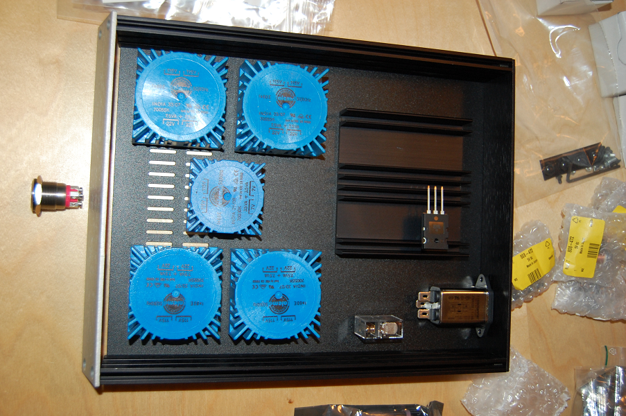

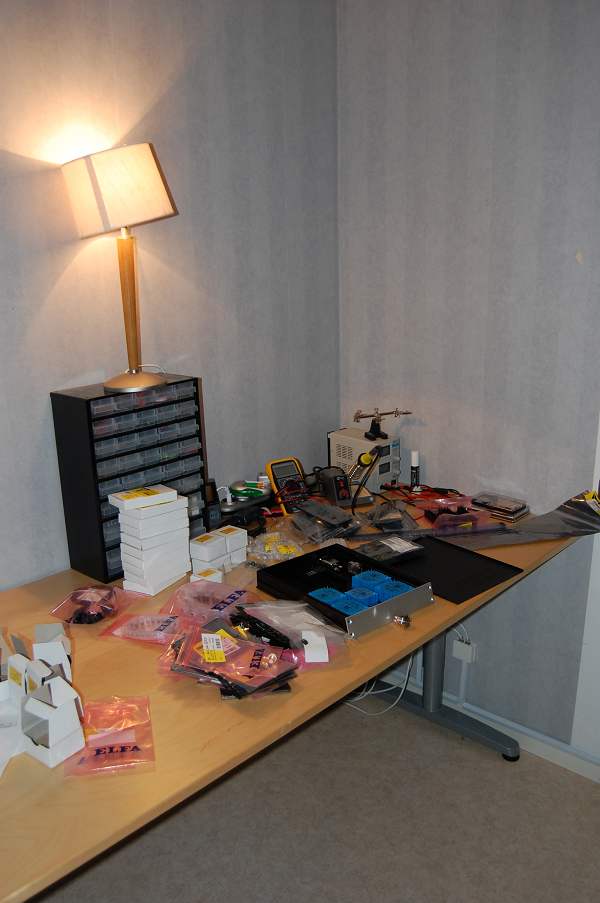

I got all the components though (except the uC) and here are some pictures in the mean time.
