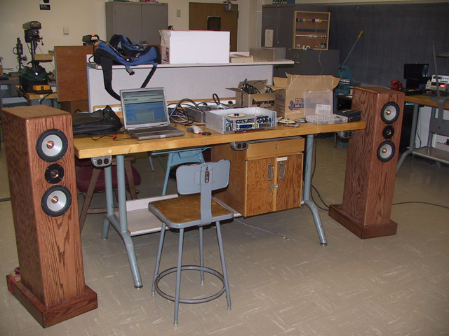

This is the same circuit that will be used with the group order. You can thank Eric (enigma) for getting me to actually take time to listen to the gainclone, and motivate me to organize a group order for others.
I helped him finish this and am letting him borrow my chassis (with power supply), and volume control until he makes his own chassis.
This thing sounds great. I hauled my Seas Thor TL speakers into lab and listened along with my cdpro2 that I am working on. This amplifier sounds great, and really kills my Leach amp.
