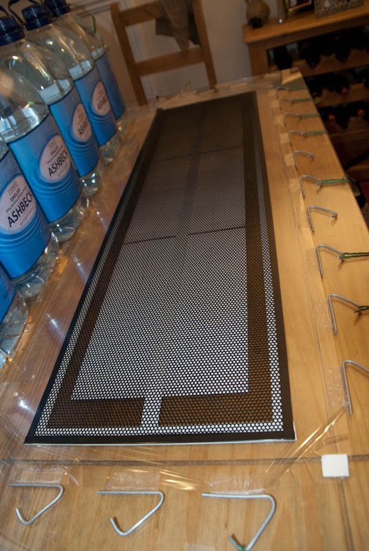

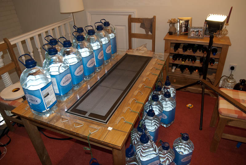

- Stretching the mylar. Hahh, that was fun! See pictures.
It worked, but I had to hold my breath. I would build a proper jig next time. There is one rule here, one must be able to repeat the process (at least one more time for a stereo system) with the same result. We want both side sound the same.

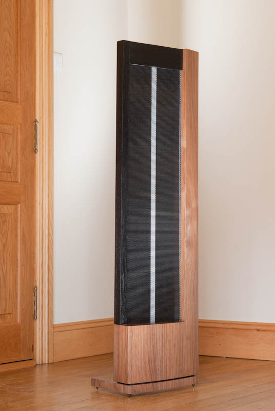

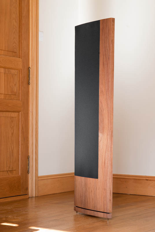

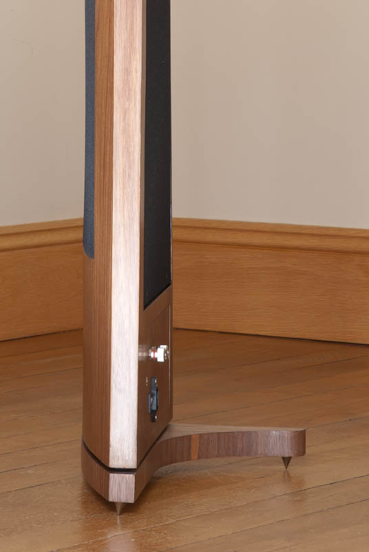

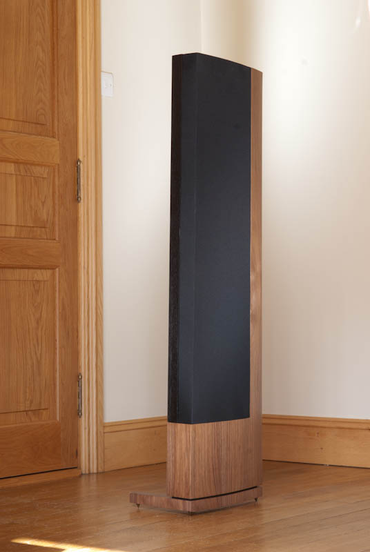

Here I took a different approach. Limited space and desire for good looking objects led me to the creation of my own design. All my projects start on the computer whether I am working on interior design, kitchen, furniture or other objects. After some sleepless night and many virtual prototypes I ended up with this curved shape. The panel is elevated to the listening position, the underneath space holds the electronics (power supply, and transformers), the curve creates and in the same time hides the necessary bulk. The physical barrier more than a necessary addition, it is part of the object, seamlessly integrated into the shape. I am very pleased with it.
Here I have to make a confession. Aesthetics are important to me. I am the kind of person who would sacrifice 10% sound quality for a more pleasing appearance. I think in this case I managed to find the right balance.
My panels are crossed over at 210Hz (still experimenting). For the low end I use Ripole subs on each side, based on the Peerless 830668 SLS-263 10" sub woofer driver.

Well done! You have excellent design sense, and those are classically styled ESLs that will never go out of style. They remind me at first glance of Sanders' SB old project, but yours are better!
