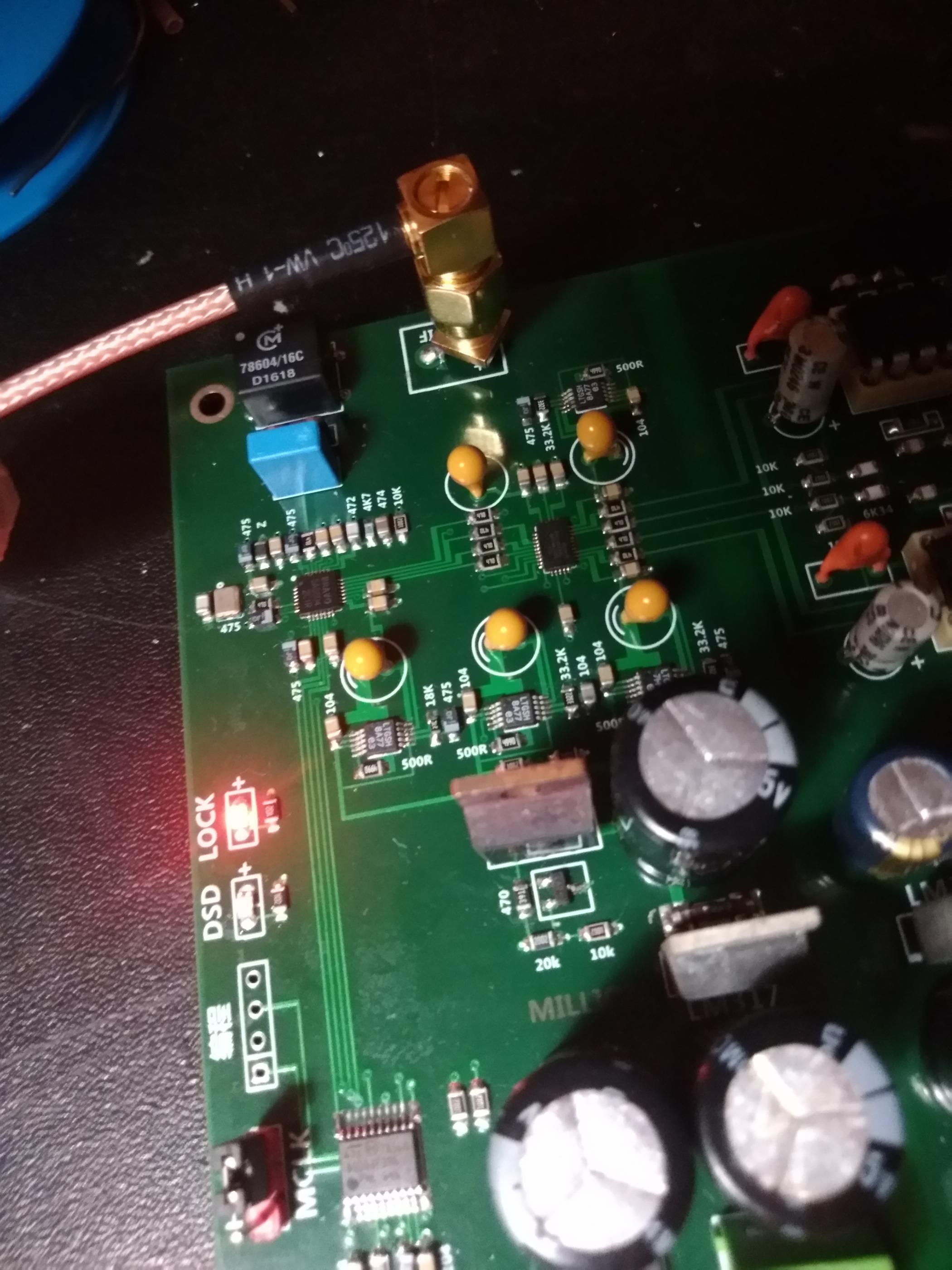

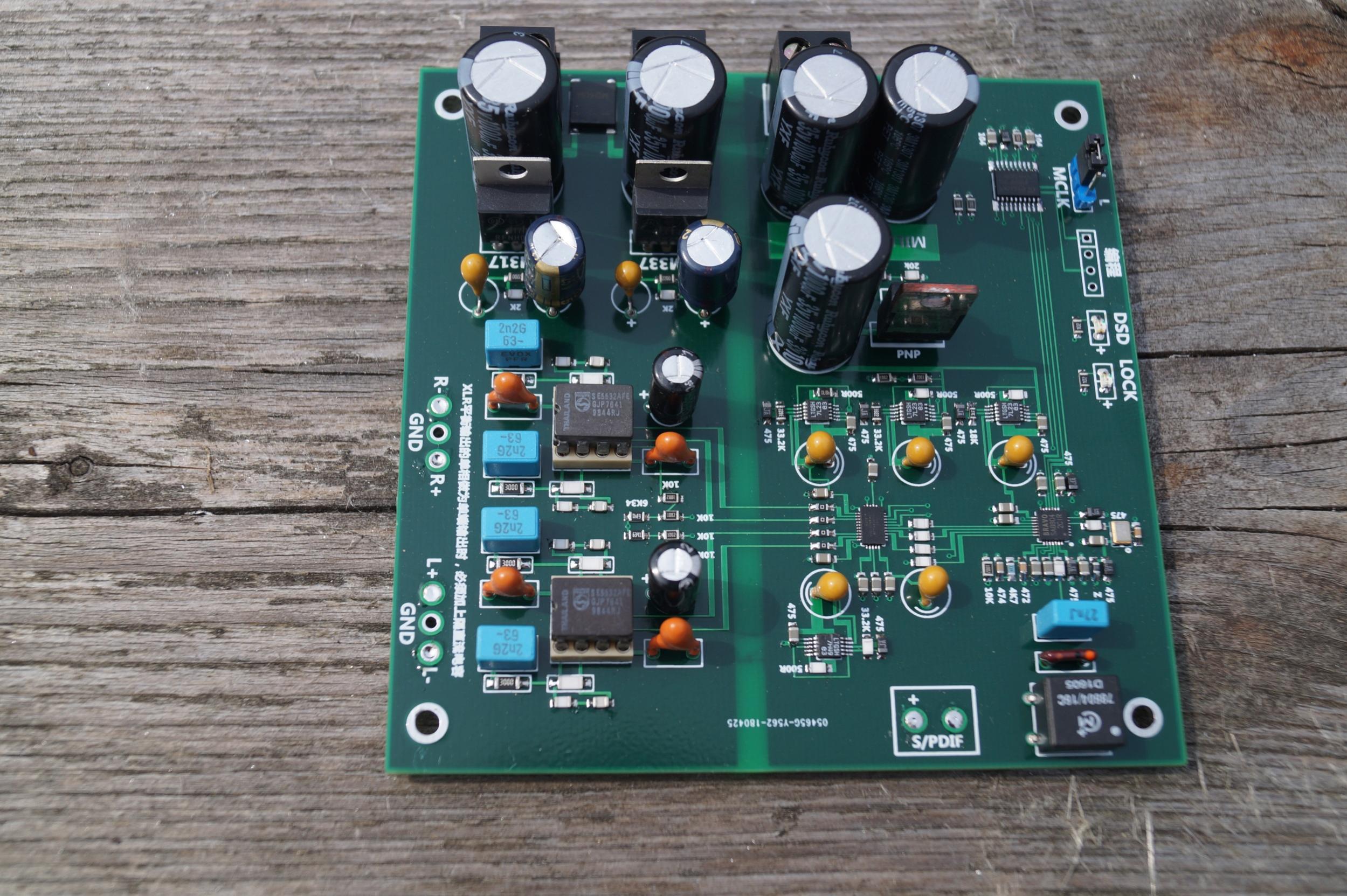

My board arrived and it looks almost identical to Democles.
681827d1526816254-es9038q2m-dac-board-y1-jpg
The bulk caps are different - mine are 5x Jamicon 1000uF 35V. The electros near the op amps are also different - branded Rubycon 3MO246 10uF 25V non polar. Rubycon's catalogue doesn't have "non-polar" caps because they refer to these as bi-polar. They look like these
Apart from that, the two boards seem to be identical.
The board has two bridge rectifiers - both marked MB40M. The datasheet says they are nothing special with a forward voltage of 1.1V and 50pF input capacitance. It doesn't give recovery time.
The PCB is clearly multiplane so I assume the ad is correct and it is 4 plane, and it's obvious the analogue and digital sections have their own ground planes so that's good news.
The power regulation for the digital section has an LM317 with a 7.5R resistor so it seems to be a constant current source of 166mA. This feeds a shunt regulator for a 7.5V supply to the four LT3042 regulators. This is very good news - the CCS + shunt as a pre-regulator should get the best out of the LT3042.
The XO for the Bravo SA8804 is marked as 12.000 (mHz) and "748". If anyone recognises the brand, please let me know what it is. Thanks!
The op amps power is +/-12.5V from a 317/337 combo. It has 220R between output and base and 2kR between base and ground, in parallel with a tantalum cap. The output cap is 220uF Panasonic FC.
This is the analogue output circuit. I have a bunch of different op amps to roll in this circuit, and I'm going to use a dual TPA6120 headphone amp with differential input and gain of 3.7 to listen to the DAC on HD650 cans. This DAC seems to have very little opportunity/need for modifications, except the power for the op amps.
Besides the brand of the XO, another thing I'm stuck on is the chinese print screen next to four empty through holes - in the top right corner near the DSD and Lock LEDs. The first character is "setting" but I don't know the second one. It doesn't mean filter or volume. DMM readings show very large resistsances between all the different holes, except the furthest ends which is 10K between them, so I guess this is the volume controller described in the Ebay ad.

I haven't measured the Vref voltage yet - curious about that too. The ESS application note has the feedback resistors at 2.7K and this board has 2.4K so this would reduce gain, and then with the 47R the gain is lower still. I'm not sure I follow your thought that this would worsen distortion or push it into clipping. I think the opposite. Have I missed something?
I hooked it up to a 50VA transformer 0-9 and 15-0-15, both about 1A, and measured voltages. It's all as you might predict based on the circuits. Vref is 1.27V so if that is the midrail, full scale output can't be over 2.54V at the op amp input. If it's more than that then I need to change the resistors for Vref - I guess it needs 1.5V to 1.6V for Vref.
Page 52 datasheet says the output R of the DAC is 774R +/-11%, Vopp is 0.906xAVCC (measured at 3.28V so 2.97V), and full scale output is 1000*Vopp/Rdac. 1000*2.97/774= 3.83mA +/-11%. That's a bit weak imo. but perhapos I was unrealistically expecting the multiple DAC output current. Anyway, mid rail of 2.97V is 1.485V.
The app note circuit has an inverting op amp with 2.7K negative feedback so gain is 2700/774=3.48 +/-11%. This DAC has 2.4K and an additional 47R in series so gain is between 2400/898=2.67 and 2400/727=3.30. i.e. 2.98 +/-12%. That's roughly 17% less, with the usual margin of error.
Given gain is lower, full scale output will be lower so I think Vref can be lower too. 1.27V versus 1.485V is actually 17% lower - same as above. So I think the designer's done Vref correctly to keep the op amp inputs exactly how they want to be at full scale. I might be wrong but it seems I don't need to change any of the Vref resistors at this stage.
The series 47R seem necessary not only to lower the gain but also because the output lines from the DAC chip to the op amps are not short enough to have no capacitance/inductance and the 47R will help isolate the chip output from the effects of the traces.
Seems like this DAC has been thoughtfully designed. But then again, I may have got my maths wrong so .... ;-)

I replaced the screw terminals with an sma and fed it an spdif signal from a CM6631A. Output from each op amp channel always measures just under 2.3VACC at 0db. The mid point is 1.15 so that's enough under Vref that the op amp output is always above 0. This coincides with output offset of 0.17V.
The PNP transistor is 64.7 degC even a full current demand from the digital section, so I'll add a small heatsink to aid dissipation. I tested the Jamicon 1000uF - voltage loss is fine but esr is 0.22 and it was 868uF so I'll replace all of them.
设置 is to program the mcu , the others are right . xo is taitien , low phase noise xo . the sa8804 is the best DIR , can output a mclk with jitter below than 15ps .
Thank you! I found this on Taiten's site - they make XO specifically for Hi-Fi and the phase noise plot is impressive.
Do you have a datasheet for SaviAudio Bravo SA8804?
I have been over the whole board checking, measuring and testing and I'm very pleased with the quality - thank you. The PCB is very easy to work with so it's been painless to make a few minor changes. It's now ready for op amp rolling. I have AD8599, OPA1612, OPA2211, OPA1642, LME49720, LM4562, NJM2114, JRC4558, OPA2132, OPA1602, NE5532.... I guess I will find the flavour I like best :)
For the digital power, I fitted 2x Panasonic FM 1,800uF 16V before the CCS=shunt, and FM 1000uF 16V after it. I put small heatsinks on the 317 and PNP.
For analogue power, I fitted 2x Panasonic FM 1,500 25V before the 317/337. 317/337 now have 120R between output and base, and base has 2x LM329 to ground. Output is +/-15.4V. The output capacitor is Sanyo 100uF 25V ESR 0.19 so it will stay stable. Its leakage is less than FC.
Vref filter capacitor is now Wima MKS 4.7uF.
SPDIF input is through an SMA socket.

I forgot to say that while going over the board I noticed 3 other differences. Democles has 0R resistors on the DAC output, I have 47R. I also have 127R on the op amp output and Democles has 30R. I also have a different film cap in the spdif signal path after the transformer.
you could change the 47r if you want to use oR , after
there are alotof you can do on the board . also you can add a dirver for a output transformer , or a amp lpf .
i can send the datasheet to you , please give me you email .
Thank you - I've sent a private message with my email address.
47R is fine - it isolates the chip from the the traces and it has very little shot/thermal noise (about -150dB). Norton's theorem means the op amp sees it as part of the I/V structure. Overall, I think it is a better choice than 0R for this PCB but perhaps 15R or 22R might be best.
I am very pleased the output is differential with one RC low pass filter. I might lower the frequency of the filter pole to 120kHz-150kHz, and I plan to add a transformer and a TPA6120 amp with a potentiometer volume control so the DAC is always at 0dB. The output current isn't very strong so I won't use any digital volume control.
