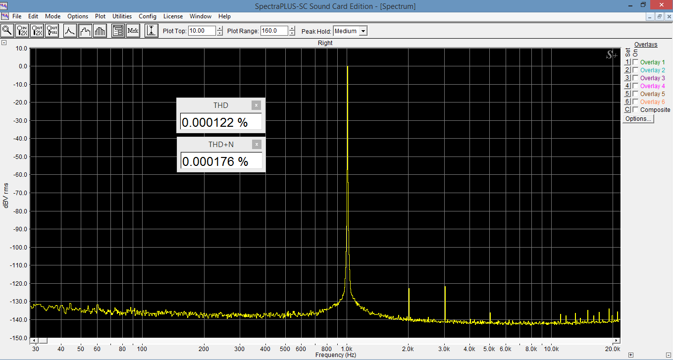

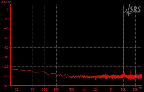

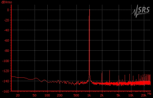

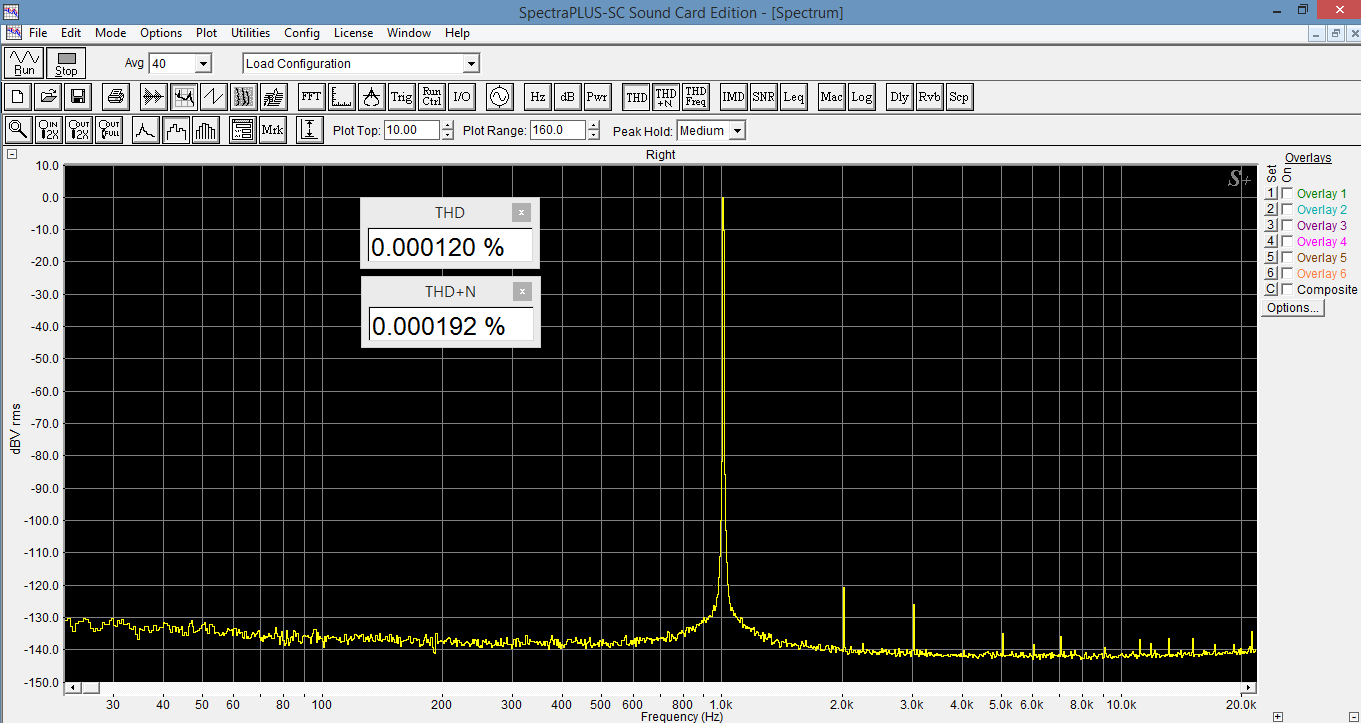

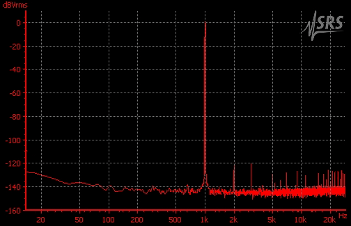

So here are some measurements from MisterRogers good friend that owns a very popular audio company. The measurements of my Blackbird DAC were taken from a Stanford Research SR1 audio analyzer using the original I/V design. The last THD pic is from my new IV_1 with the headphone section added. I made some minor layout changes that appear to have lowered THD some compared to the original I/V board design.
The first THD pic is at a sample rate of 44.1Khz, then 96.0Khz, 192.0Khz, and 10Khz at 44.1Khz. The last pic of the new IV_1 is at a sample rate of 96.0Khz taken using my modified EMU-0404.

Al,
I'd say at those levels we are most likely seeing a lot of the EMU's ADC
distortion and noise. I have the 1212M with higher spec AKM ADC and even
it would only have slightly lower noise but similar distortion components.
Job well done - exceptional performance.
