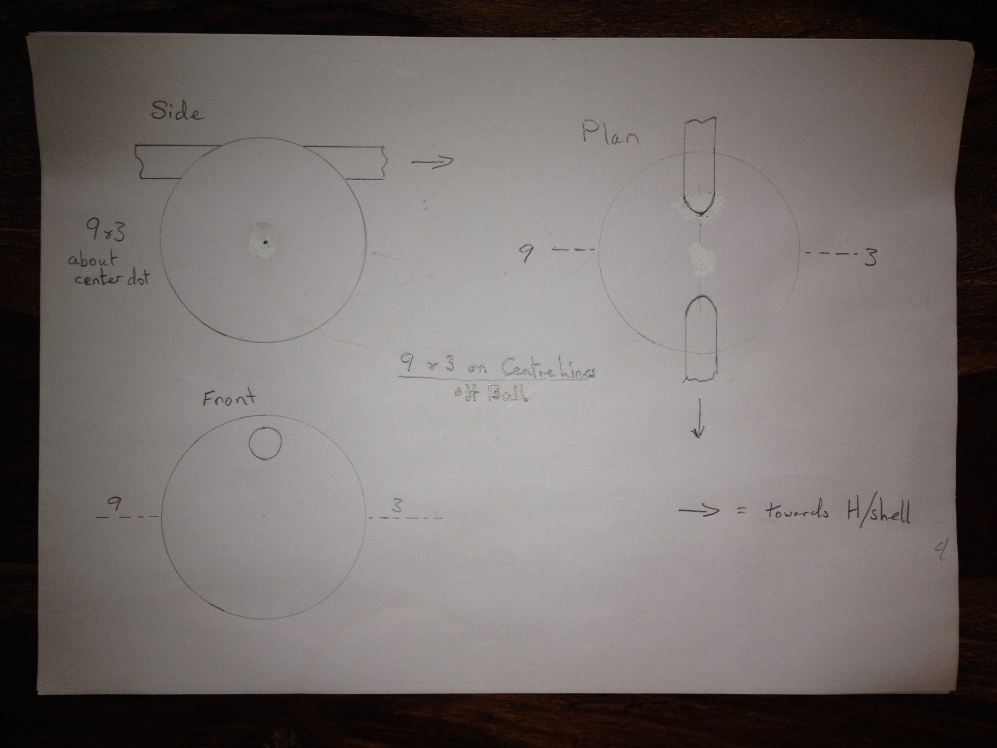

Ok hear is a drawing of the Ball,
The Arm tube is fairly obvious & can go anywhere in the general area of where its drawn.
Now the main thing hear is the position of the side Ball fixings (in relation to the arm tube) for the Strings either side of the Ball, hear marked as 9 & 3.
I have read that they do NOT go at these points i.e. 9 & 3, but a bit lower or a bit higher or a bit forward of these points ????
Cant recall where I saw it.
If anyone can clarify this please do so Using the drawing.
Please use 9 & 3 points as a Reference, in Side, Plan & Front views.
regards Jay

Checked my holes and they are not at 9,3 so here's hoping.
I will put my entry holes for the cable to the side to stop them dragging down too low near the record surface.

15" a bit ambitiose try a 12" first you can always extend later, when it sorted

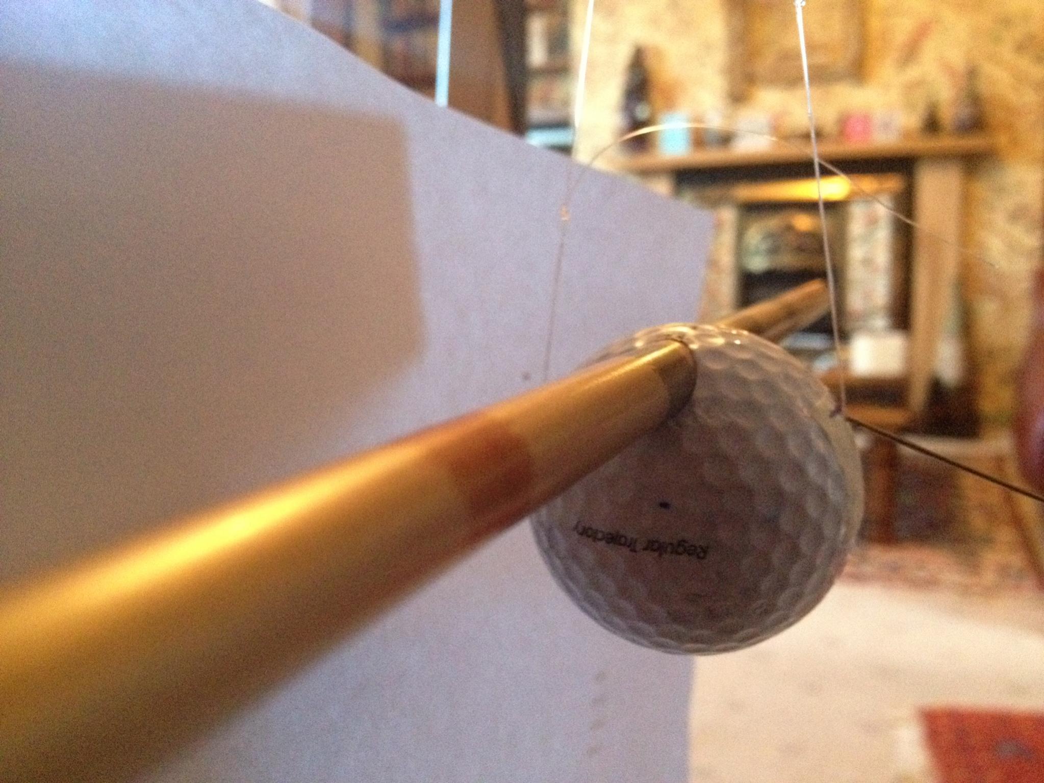

Still Ive got two holes in the Ball now.
And two tubes through it.
I don't think it matters how far OUT the string is from the ball but aesthetically IMO it looks better close to the ball.

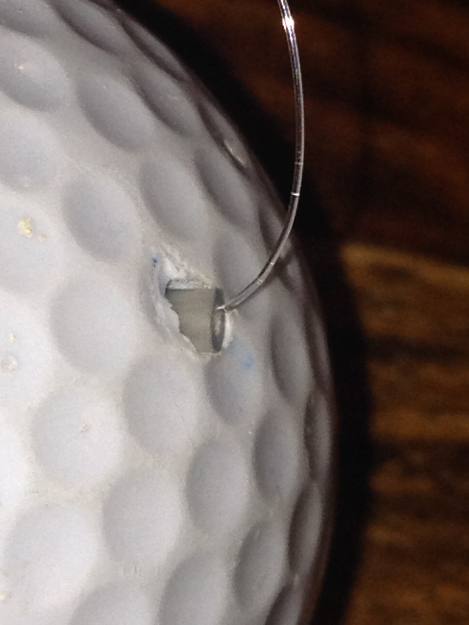

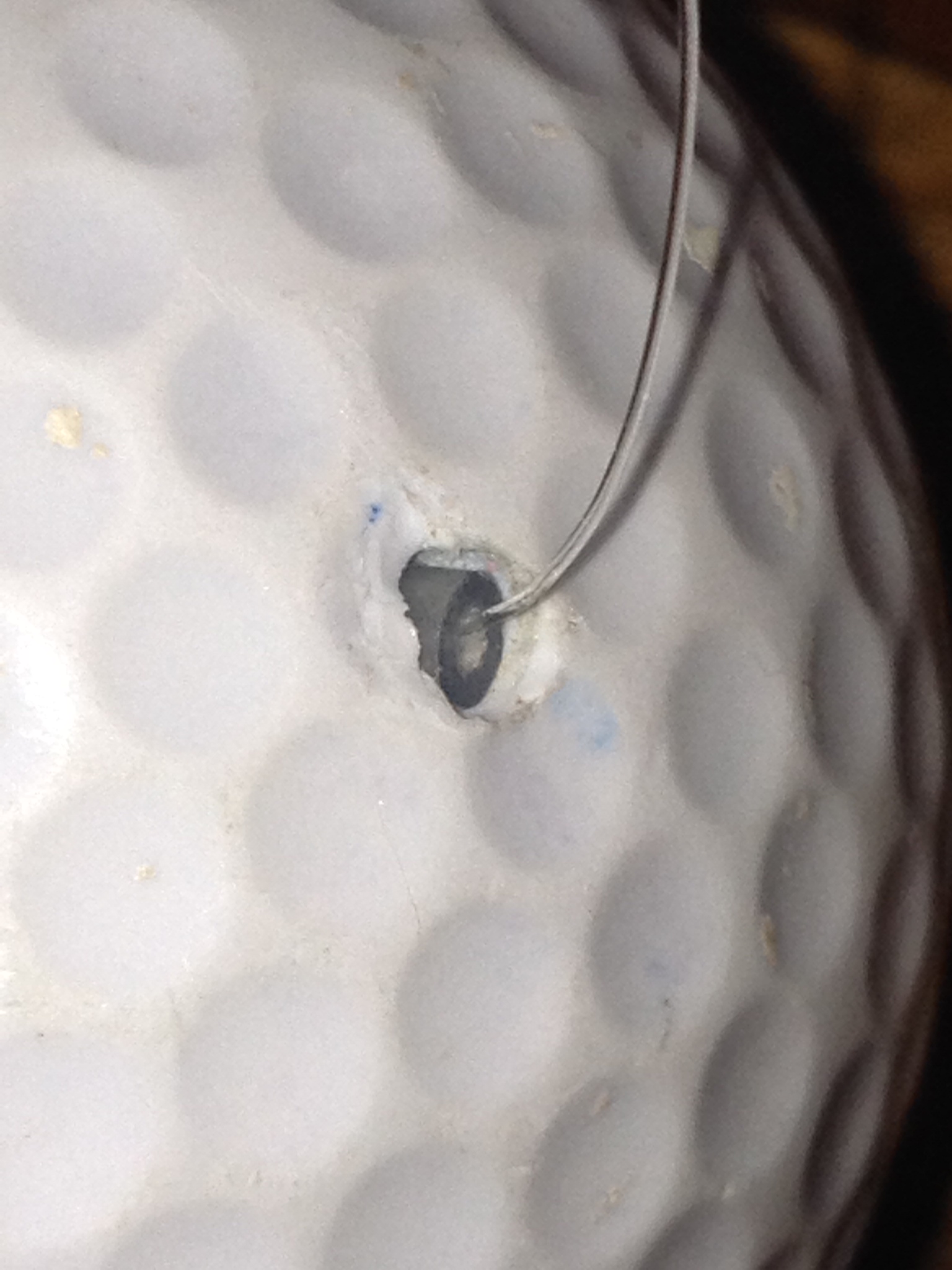

I haven't attempted to smooth off the inside top edges of the small tube. I most likely will, so it will reduce the opportunity for ware on the string at this point. It will also be glued in some manner, as will the string.
