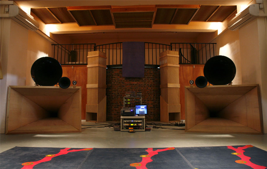

Hi Wigginjs, it's nothing special just a regular PC's motherboard digital out (75ohm RCA). We were using a PC with Lynx 2 (aes/ebu out) but that's kinda broken... Sorry, no pics of the PC, I'm away at school right now.
MaVo said:Great System, one cant possibly wish for more
Thanks MaVo, we're happy with the drivers, need to upgrade to better PC source and power amps next.
WALTER BURKHARD said:Goto System 5way
Hi Walter, Goto drivers are nice but too expensive! My 505TT is the cheapest low-mid model... I don't like Goto's hypex horns, the throat end is too long for my taste (got I tiny bit sewer pipe sound) I plan on building a 140~150hz tractrix.

Hi Keith,
I'm really impressed by your system and its corresponding listening room. And what impressed me much is such a family dedication: father and son working toghether to get a dream true!
Maybe I am loving horn sound as much as you but having just an ordinary living room and little kid around I'm in a relatively standby and just dreaming of systems like you did.
Playing about 5 years with horns (see my effort here: http://forum.audiofil.ro/index.php?topic=524.msg19714#msg19714 ) I developed a personal view of the relative importance of parts in such a multiway horn system.
Personaly, I'm not affraid of the coloration induced by any amplifier, SS or valve, horns have a lot of lovely coloration that cannot be spoiled by any decent amplifier but only by a really bad or defective one. In 2x5 way system like yours, with expensive high sensivity drivers (GoTo ), firstly I would be affraid of induced brum and accidental overpower. So, to solve your multiamp problem just keep an C-Audio amp for sub-bass duty and use a multiamp like this http://www.monacor.de/typo3/index.php?id=62&L=1&act=8&act_sub=21&artid=5596&spr=EN&typ=u for the rest of the channels. You'll get balanced inputs, some HP and LP filters, all around protection and great packaging.
Good luck in your efforts and please keep us informed how is going on. All the best!
Dorin

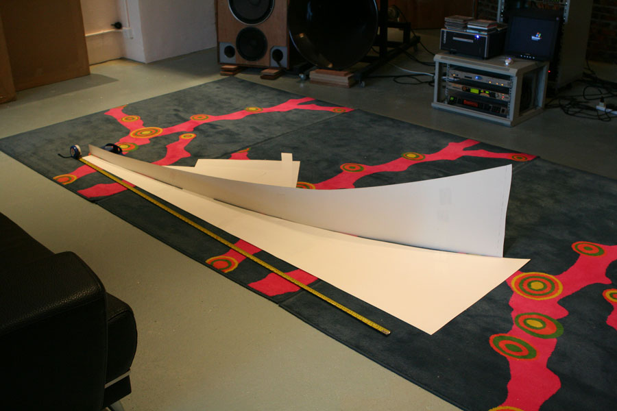

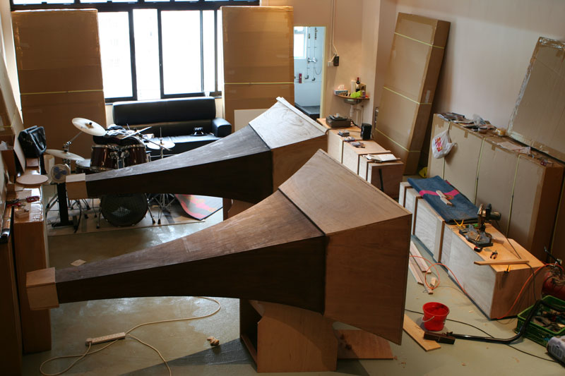

WALTER BURKHARD asked me about constrution drawings from the midbass horn, I'll be answering here...
I used Hornresp to design my 1/2 space 53hz hypex (m=0.6) with 5" throat, the mouth is about 40" x 64" (102cm x 164cm), and length is 8' 8" (264cm). I can't say that I was super accurate when I made this horn but I did my best with the tools available. Construction drawing would be the exported file from hornresp and the paper template I made (see picture).
What is the advantage of a 1/2 space horn over 1/4 space? I mean, theoretically - of course. But we all live and listen to music in boxes called living rooms, not in open space. No?
