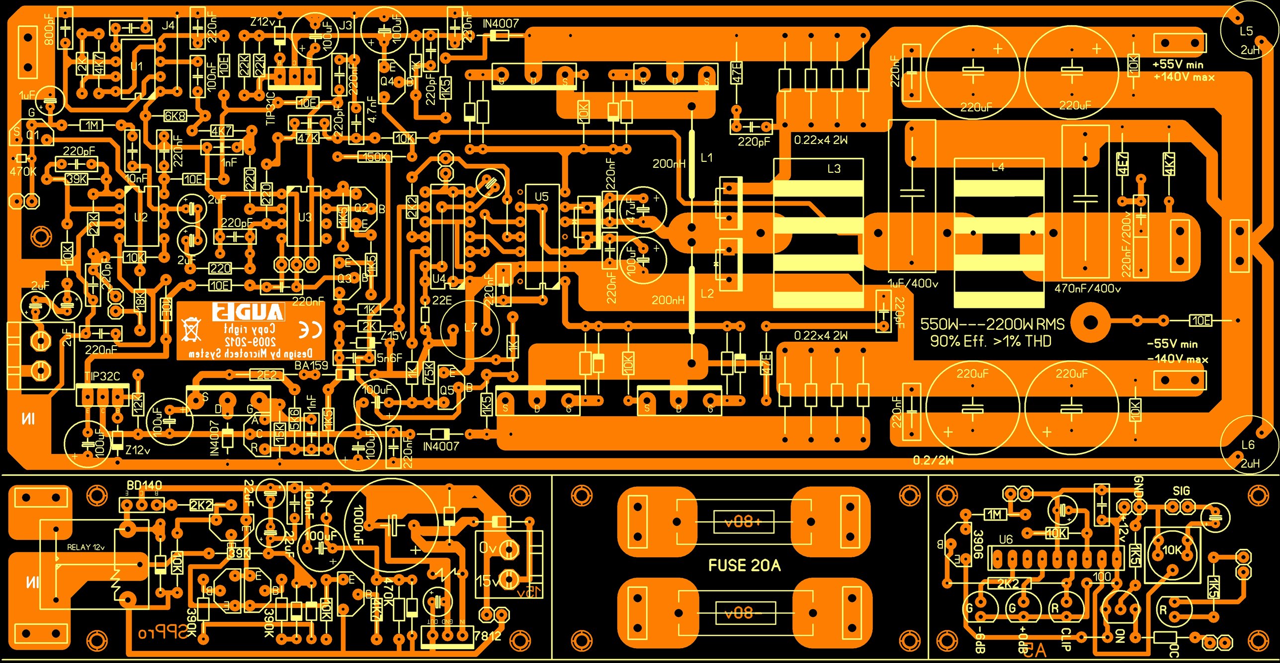

Hi Srinath,
(a) completed working AUD600 Power AMP Board(IR MOSFET with COILCRAFT Filter),AUD600 Power Board,Signal&Clip indicator board,Volume control with limiter and Balanced input jack.(without transformer)(supply rail DC Min. +/-35V max. +/-47V) Price $180 shipping charge extra.
(b) completed working AUD600 Power AMP Board(FDA MOSFET with COILCRAFT Filter),AUD600 Power Board,Signal&Clip indicator board,Volume control with limiter and Balanced input jack.(without transformer)(supply rail DC min +/- 45V max. +/-70V) Price $185 shipping charge extra.
Spec
(a) Power FTC RMS 8R @275W
Power FTC RMS 4R @550W
Power FTC RMS 2R @1000W
(b) Power FTC RMS 8R @600W
Power FTC RMS 4R @1200W
Power FTC RMS 2R @2450W
Regards
MANOJ

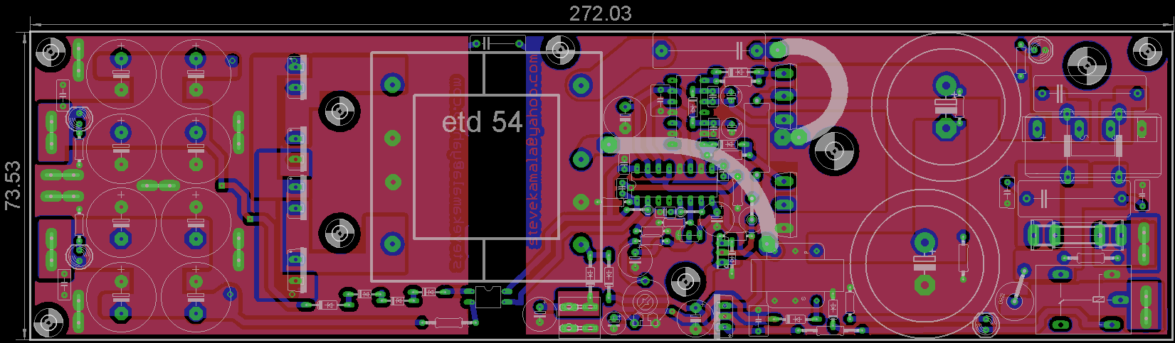

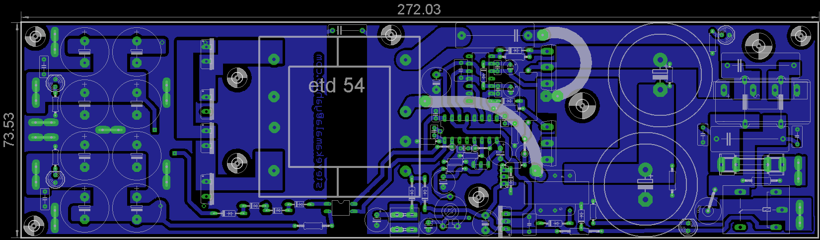

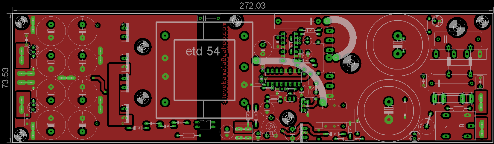

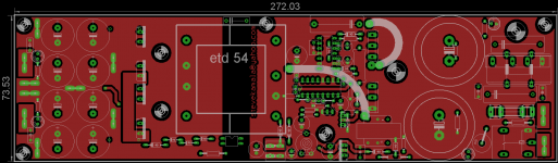

That will not work, it will blow up in your face because the gate driver is a mile away from the switching fets, even if its only a 20kHz smps, the IR2110 needs to be as close to the fets as physically possible.
hi all . i modified the smps to use with the aud 900 . i made it to fit 3u space so as to easy mounting. i brought the ic closer to the output fets.
>>>>>>>>>>>for more power use igbt as outputs and increase the switching frequency by changing sg3525 rt resistor r14 from 10k to about 4.7k <<<<<<<<

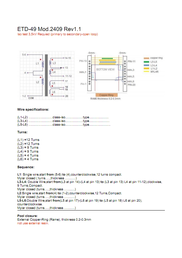

I just meant i have never seen pri and sec interleaved in any of the smps transformers i've unwound so far.
I suppose there are advantages like lower leakage inductance and such.
also there is another efficient way of coiling which is bi-filiar winding. but the tricky part is to use high quality wires because the primary and secondary are twisted together .

Good job. Thank you
Never before have i seen smps transformers with primary and secondary interleaved like that.
I think this the best way for high current application
Regards
MANOJ
