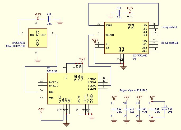

A friend of mine bought a Sony SCD-XE670, and I followed. It seems like it beats my Pioneer DV333, which beats (in some ways?) my Philips 850. My friend then decided to do mods, and then I followed, only in my own ways.
Here is my version of CD clock: (see attached schematics)
The Burr Brown PLL1707 is a hardware confiurable PLL clock generator capable to output clock signals with jitter down to 50 ps. Comparing to other clock circuits having 2 ps jitter, this may not perform very well. But the 2ps cost USD100 and this one is only a fraction of it. The PLL1707 can use a 27MHz crystal as it has its one chip oscillator, but I chose to use a off te shelf crystal oscillator. It cost more but I have guaranteed signal input. The choice will yours. The PLL1707 is set up to output 11.2896MHz, and works at 3.3V supply, which complies with the original circuit.

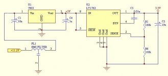

I used double voltage regulator plus a emi filter in the front to have maximum isolation of digital noise between the clock and the rest of the circuits, espically the analog part. The LT1763 has a very low noise output. In fact this may be the lowest noise voltage regulator I know of, 20uVrms from 10Hz to 100kHz.
To make things unnecessarily more complicated, I added a clock driver after the PLL1707, to replace the 74HC04 used in the original circuit. This clock driver chip has higher driver capability, and all the output are perfectly synchronized.
The manufacturers for the IC's are:
7805 - any
LT1763 - Linear Technology
CDCVF25081 - TI
PLL1707- Burr Brown

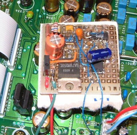

One thing I would like to remind whoever wants to use the PLL1707 is that this chip is a 25 mil pitch smt part, which is very difficult to do prototype without a properly designed pcb. Make sure you have the workmanship!
Comments are welcome, good or bad.

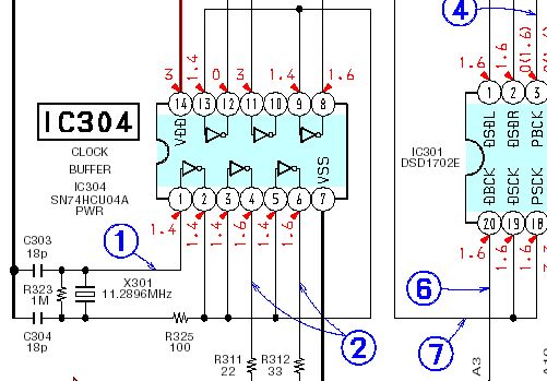

Hi Coulomb,
The connection is at the bottom of the pcb.
Remove C303,304, R323 and the original xtal X301. Connect the clock output to pin 1 of IC304 (74HC04). This is assumed that you have not built the clock driver. I attached my clock driver chip by unsoldering and lifting up the pins of IC304 and glue the TI driver directly onto the top of IC304, and then soldered the wires directly onto its pins. The outputs of the clock driver will be hooked up to the corresponding outputs from the original 74HC04 chip. Each of the these output has a resistor connected in series before reaching the other input side. You will have to connect the outputs directly to the other input side, since the TI clock driver already has a built in resistor for each outputs.
You can get power from CN306 pins 1 & 2 which is 11.2V unregulated.
Please see the attached diagram.
The regulator is about 60nV/SqrrtHz, not bad, depending on power supply rejection it may be enough.
Honestly, the clock is way too complex. First you generate 27 MHz, then a synthesizer makes 11.2896. Keep it simple !
You may re-use the 11,2896 MHz crystal and build a standard Colpitts oscillator, with a simple style HC04 inverter as a slicer and end up way better than the clock you propose here.
