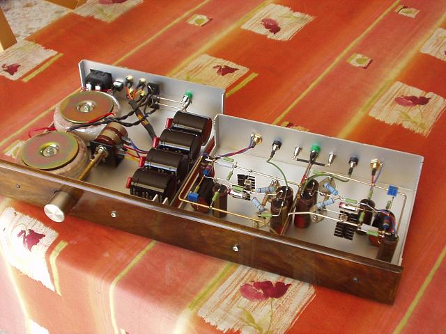

ROCKMANDRAKE said:Hi there,
i am proud to introduce to you my very last personal realization.
As good as single ended tube amp !!
Fitted with germanium power device, Elna silmic caps, kiwame resistor this amp ( 2X8watts ) is gorgeous with my Magnepan ( Mg1c ).
nice works,your artwork as good as vacuum-tube machine...
I still believe "simple is the best" & I love simple circuit!
I am very intersting in it,can you post the schematics to me?
thank you first!

Here people create some PMPO power....crazy measurement
Peak....P
Music....M
Power....P
Output....O
They colect the maximum sinal distorted and make adition of left and rigth channels....20 years ago they multiplied the value by a factor of 10
Now a days they are multiplying by 30.
So....small radio, those that operate in AC and DC, portable battery powered stereo radios, with 1 clean watt each channel, distorted gone to 2.5 watts...total of 5.0 watts....and multiplying the result was 150 watts PMPO.
And you go to check the power consumption in the back panel, and read there 8 watts maximum.....Magic!.... we waste 8 watts of mains energy, as consumption, and magically was transformed to 150 Watts.
We use to say here, that those power measurement are:
Potencia Musical Para Otários
Music Power For Idiots
Maybe our friend is using one of those different power measurements...alike instantaneous burst peak heavily distorted one single channel driven power.

yes,even the amp operating in class-b,when out put 8W,one side voltage must higher than 8V...8W/8ohm=1A,that is 0.707A(RMS),I think that the amp is SEPP,so each transistor got about 0.35A(RMS),transistor min power waste is 8V*0.35A=2.8W,as the Ge transistor is TO-3 package.it still has large heat can't dispose,so it will go so heat,and Ge transistor is very bad in high temperature...it will breakdown soon!!??
I really don't understand how it works...

destroyer X said:The amplifier is very interesting...i will construct it, as soon as i found the output units.
I will use heatsinks, but i imagine that the power is not correct, or if correct, will be danger to output units.

Darkhorse, my dear, despite i want to publish, i think i have not this rigth to do.
Because we asked him to publish....he did not published.
So, he may have his personal reasons to avoid, as you could see, many people, including myself, had doubts about.... no heatsink...and those things....the real power output.
There are people that do not like to listen those things, others apreciate, others love those informs...depending the case, the sittuation, who is saying this or that...if the one that make criticisms not usually do that, or if the one that make criticisms always do that...well...depends on many sittuations.
Beeing my schematics, i always test deeply, so, when i publish, people can say everything and i will read to see if they can have some good idea...but knowing very well the unit published.
Others do not do this way, do not apreciate to discuss, do not want to listen other people ideas...i do not know nothing about our friend...more than you, i know his name, his schematic and that he is a reserved guy...show the amplifier to us, but are not asking if it is good or not...he already know it is good for his ears, he is satisfied, want to share with the ones have the intention to try..... to others that want to aplied theories, rules and things alike....i think he is not asking that....(my personal opinion, as he did not published).
I will not publish, except if he tell me to do that!
Also i have to construct, and listen, to say something more interesting about.
