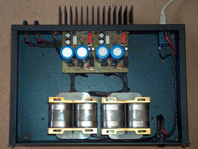

Here is my latest creation
1.1 kVA C-Core power supply (just had to do it. seeing that i get them at a very decent price. $ 80 each
Bipolar feedback. (Under the board)
Sprague main caps main caps
The bass on this is simply amazing and over all clarity is much better that what i used to have.
you might ask about my usual off-board power supplies for the opamp. Well it is coming. Just waiting for the transformers.
