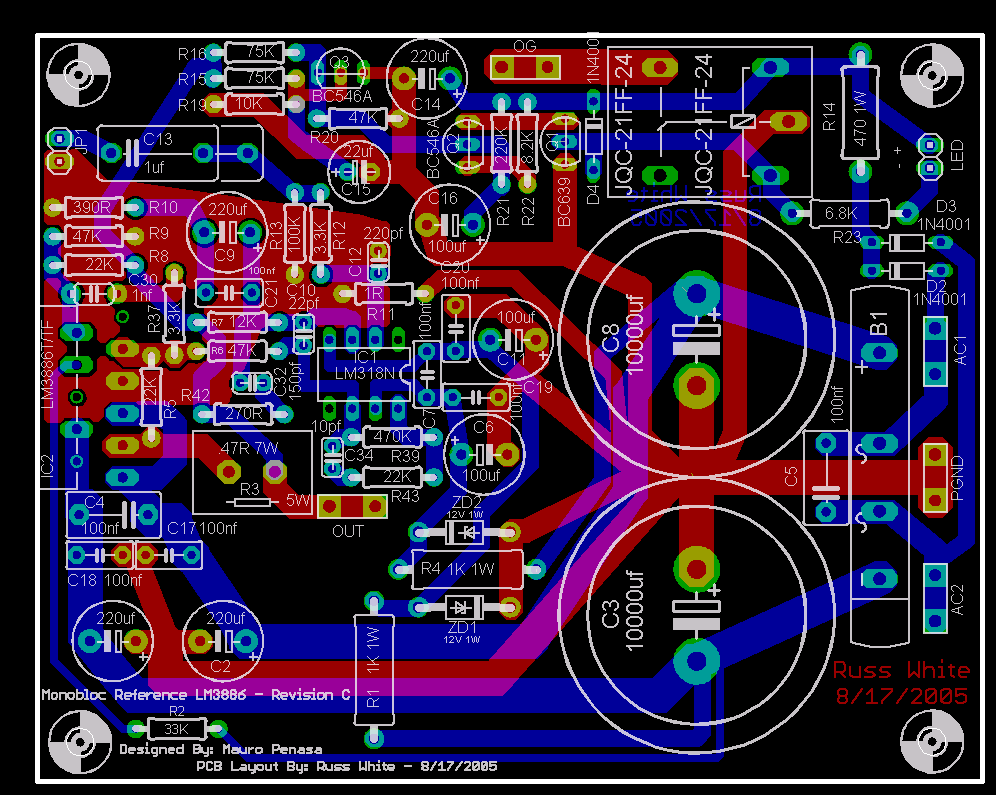

Latest revision of monobloc REV-ABC PCB
I finally got back to my desk and here is the result of the latest tweaks based on Mauro's suggestions.
The only major change is the 100nf bypass cap for C9. I used 5mm size pads to give flexibility(ceramic or film or whatever)
I also just tried to make it a little more tidy.
If anyone really wants another REV A run, or a REV-ABC stereo board, just let me know.
Keep this in mind, you can use two of the monobloc boards in the same space as the original first run REV A boards, but you have the advantage of being able to use two smaller heatsinks.
The extra parts for the monoblocs (just the speaker protection circuit) are not expensive parts.(about $5)
Cheers!
