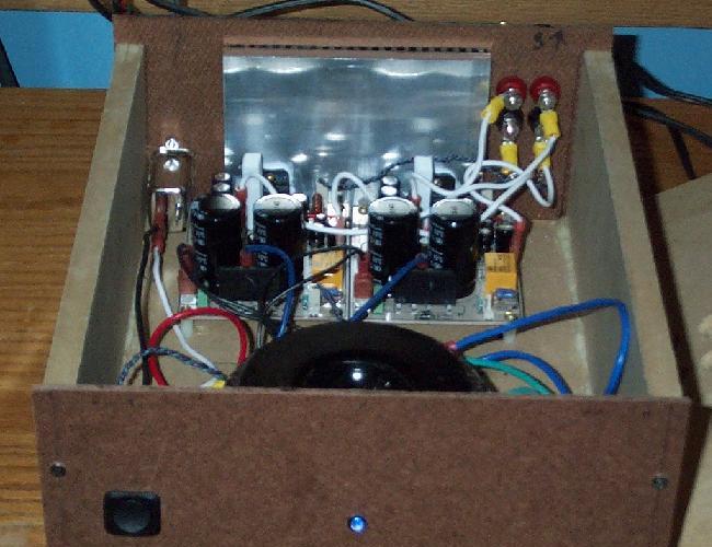

I am new to posting pictures, so hope this turns out. Finally had some time to put the case on. Continue to be amazed at this little amp. Detail and clarity. Have not seen the heat problems others talk about. .1% resistors where specified. 3 watts for the 1k's and splurged on the caps.

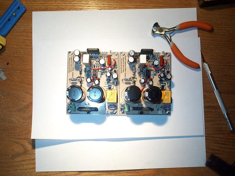

Built a new board yesterday. Got the amp playing this morning. It is the Rev A.
Like the sound, it seems rich and full. Gets the tonallity right, along with timbre. Lots of punch.
My speakers may not be optimal, 15 ohm, 100 dB efficient. The amp is pllaying at mW levels. The noise level is very low, measured 0.0 mv ac hum on initial check out. This required a little lead dressing, the speakers cables and input cable run right over the SIP bridge rectifiers.
I tried dowloading the image software, but only got down to 470K from the original 2.5 meg sizes. If someone more savy is willing I
