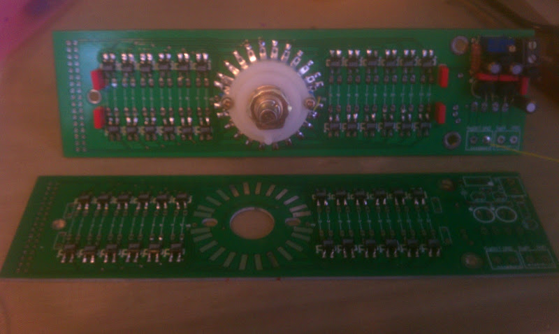

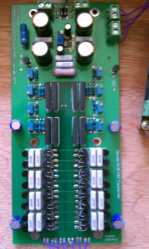

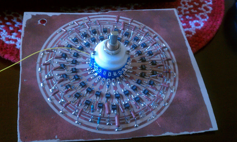

I have to disagree. I have two projects that use SS relays and I love them. The sound is wonderful and they are very reliable. I have an Audio Precision that says they have very low THD+N and no phase shift.
Enjoy the pics
The first one is an LDR based source selector. The 16 black things are the LDRs and the 8 black things near the middle are solid state relays. To block or allow signal through you turn on or off the LDRs so it goes LDR>SSrelay?>LDR. SS goes to ground. They turn on or off opposite each other so you have 40R>near infinite R>40R for ON and for OFF you get 25Meg>2 to 4 R>25Meg.
The other two pics are the proto and finished volume control. It uses a series LDR and then a shunt dale resistor. The dales change value by the rotary switch turning on/off solid state relays to select a resistor. The relay is between the resistor and ground. This way there are zero mechanical contacts on a stepped attenuator. Neat huh? The resistors arent shown in the last pic but they are vertically placed, 24 of them, from left to right across the board with 12 on each side.
A friend of mine is working on an Android app to replace the rotary switch. Even cooler!
