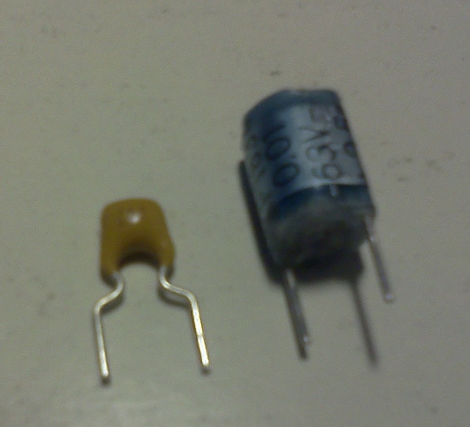

Probably too much inductance resulting in decoupling that can't do it's job !
It's possible.. ceramics TH have longer leads than most film caps:
But I think that also the steel leads could have a part on it.
Evox PFR (polypropilene film/foil with steel leads) also sounded less rich than other film/foils.
.......It's possible.. ceramics TH have longer leads than most film caps:
I felt inclined to post an expletive or several !!!!
Trim off all the excess lead, just like you do with other leaded components.
Attach the 1.5mm of remaining lead directly to the respective Power PINs of the chip and get the attachment right next to the package, not some 5m or 10mm away, on the traces soldered to the far ends of the Power PINs.
The decoupling must have the absolute shortest circuit route to be effective.
Miss this critical requirement and you will be introducing all kinds of misbehaviour into the way the chip processes the signal.
I really do feel that all your guesswork has taken you down a path that has nothing to do with designing an amplifier to process signals correctly.
I have been saying this for months, or is it years, and you have not taken the hint. Why do I have to be blunt? Will you ever listen to advice?
Now I return to a bit of advice that is scattered throughout this Forum and others.
Attach properly implemented decoupling from Rail to Ground for both polarities of Power PINs and give the amplifier a chance to behave properly when processing signal. That means HF decoupling at the package, MF decoupling at the traces near the PINs and LF decoupling where it can be fitted on the PCB.
Then you might find that C7 is actually not required. Then you might also find that all the experiments with various other caps show no changes in sound quality/non quality.

Andrew,
you can find attached the actual caps I'm using near to the KP1834.
As you can see leads have been trimmed.
The picure in the previous post is a generic one I've found on the internet... ;)

Still far too long. Absolute minimum means really short.
You're right Andrew, they're so to use them on sockets.
When soldered and correctly trimmed all those caps will be (possibly far) more effective as bypass.
In this phase I'm not evaluating their effectiveness as bypass but the effect they have on sound.
I've also soldered and trimmed some of caps in test and their sonic signature remained consistent with the one I've heard when socketed.
I understand you're saying that when correctly trimmed and soldered on pads as near as possible to power pins probably their signature will be (much) less evident but in my tests it was not so.
