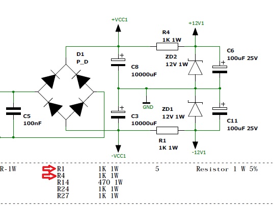

do you think ill need heatsinks for to-220 types if i'm to use them in r1 and r4? caddock mp-925 10k ohms arrived in the mail today
In R1 and R4?
You'll probably need heatsinks.
But why 10K?
They should be 1K, IMHO.

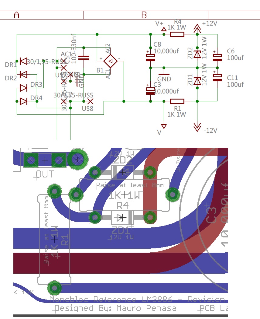

R1 is shown connected to PIN8. It is labeled 47k.
I'm sorry Andrew, this time you're completely wrong...
R4 is the Vdrop for the Zener. Why does a few tens of mA need a heatsink?
It's known that those two resistors in the My_Ref will get very hot, a small heatsink can extend their duration.
I don't know where Clave gets his evidence from but I can see R1 labeled as 47k and connected to PIN8.
Just look at the Post1 schematic and you will see exactly that.
Andrew, the schematic at post 1 is outdated.
Every board ever produced use a different numbering.
The image I've attached is from the official My_Ref schematic downloaded from Penasa's site.
You can find attached also TP schematic.
Then try to be helpful and link a post with component numbering to the relevant schematic.
My response
With a supply voltage of 25V and a 12V Zener the current through R4 can max out at ~13mA equivalent to 169mW, quite low for a 1W resistor. Me, I would use two 2k, 600mW, in parallel.
With 25V trafo secondaries the PSU rails are a little under 35V giving the max on R4 (& R1 on the later schematics) as just under 23mA - lets call that around 500mW which isn't bad for a 1W resister. The idea of two 2k @ 600mW still works of course. And I can confirm that those resisters run quite warm on my boards.
