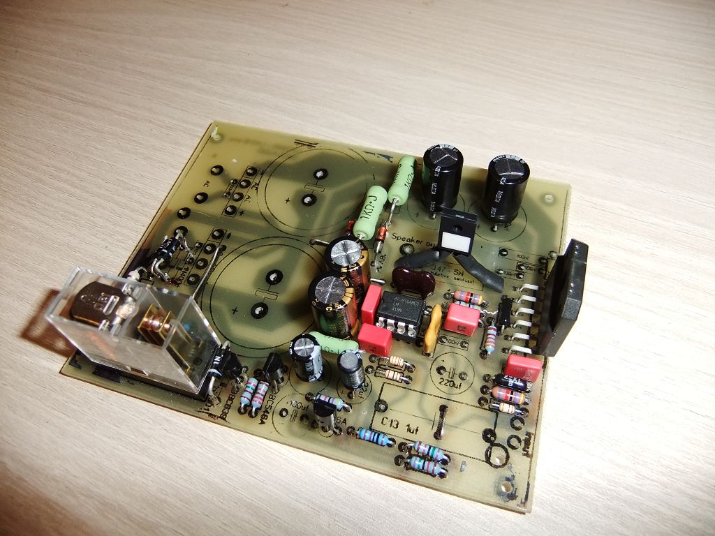

On a more serious note, Black Gates are not needed for the relay protection circuitry - in fact the slow break-in may cause sub-optimal relay operation for a while. You may want to replace it with stock 220uF Nichicon PW or Chemicon KY or similar, nothing fancy. Same goes for the Allen-Bradleys in the protection circuit - stock 0.25W MFRs will work better, without drift. Also stay with the matched resistors for R5, R6, R8, R9. For the 22uF electrolytic in the protection circuitry, a Russian Teflon is waaay overkill - a general-purpose 22uF Elna or Chemicon is just fine.
For the stuff in the signal path or LM318 bypass, your upgrades are probably worthwhile, but take care with the lead-lengths of some of the large axials. Long leads add to inductance as well as EMI/RFI.
40 mV output offset is OK, not great, but not too bad. 100 mV is a bit too high though. Check the values of your Allen-Bradleys closely - a few may have aged and drifted considerably from the nominal value. Also, if the 100k input shunt is an Allen-Bradley, there will probably be some hiss without the low-impedance source connected - the thermal noise in large carbon comps is within the threshold of audibility.
For the 220pF, I'd stick with Wima FKP2 or Evox CFR - both are film-foil, and sound excellent in a small (5 mm pitch) package.

22uf (k73-16 pept) cap is probably the most excessive but even that location has an effect in sound, mainly in sound stage, as i noticed in the past from switching between different grades of nichicon of same voltage. so the choice was made to not leave any room to make me wonder 'what if'.
this is strange- after leaving it on last night, the relay problem is half cured. it now clicks on simultaneously on power up, though it still clicks off on different intervals.
dc reads 3.5mv for the bad channel and .7mv for the other.

I started today to build my own MyRef amplifier. I used Rudi's pcb layout and used the premium BOM 1.5 with some adjustments according to Mouser's stock.
As they don't have ELNA RJH on stock for C9 i ordered a Nichicon Muse ES wich i discovered is non polar (or bipolar). It still can be used in the C9 position as they are nonpolar?
I've ordered some ELNA RJH from Ebay but they will arrive very slow and i'm not sure they are original or fake.
Sure, they can be used.
But probably Nichicon FG (also available from Mouser) are a better choice.

In my test environment the bipolar capacitor Nichicon Muse FG sounds noticeably better than Elna RJH in C9 position.
You're right.
The Elna RJH sounds better than Panny FM but, so far, the best cap after a Black Gate for that position is a Nichicon FG.
BTW your bipolar is Nichicon ES
