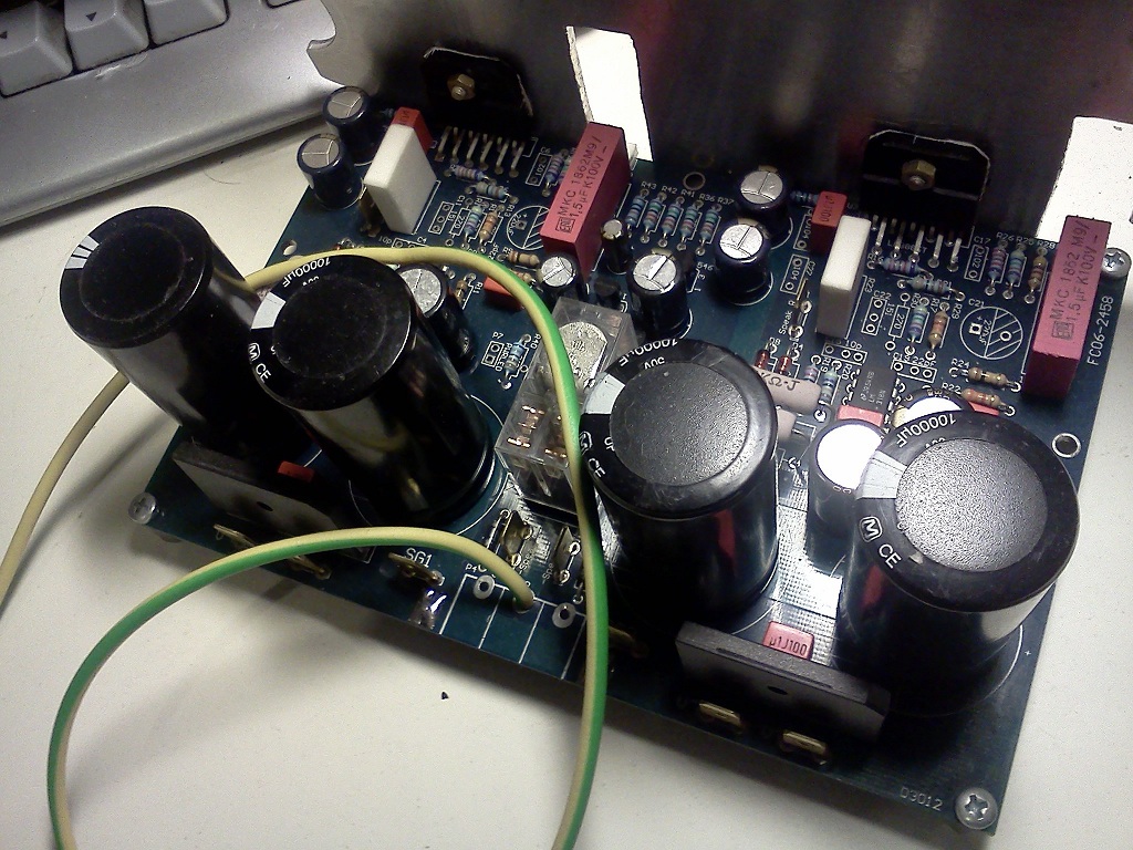

I see that there is a My Ref (original) and a My Ref Rev C (BoM). How different is the "C" schematic, or is just a change in parts?
The schematic I've linked is the Rev C one, associated with the original stereo PCB.
The TP version is also Rev C but mono, so only the upper part of the schematic apply.
In addition some bypass caps and discrete diodes were added.
TP version? Please explain.
Again, thank you.
Twisted Pear
Does anyone sell the circuit boards? I can't find it on Twisted Pear.
TP don't sell them anymore.
You can:
- buy PCBs and/or kits from forum member LinuxGuru (slightly different PCB)
- use the Eagle files posted in this thread by Russ White of TP to order your own PCBs (costly).
- partecipate to the My_Ref Fremen Edition PCBs group buy in the next months
- search in the swap meet
or you could etch them using single layer pcb. IINM there's 3 variation posted before.TP don't sell them anymore.

LM3886 x2 + opamp preamplifier 68W 4 ohm amplifier PCB | eBay
How do LinuxGuru's boards compare to the ones at Jim's Audio?
Siva's boards are derived from TP design so they're monoblocks.
Jim's Audio PCB is simply a buffered Gainclone, probably also copied from a previous Penasa's work.
On eBay there's a My_Ref C clone (Nimo e-store) but it's not the one sold by Jim's audio.
I've bought one just to try, the PCB seems good quality (2mm FR4), can be populated (almost) with my BOM and it performs quite well.
But, sincerely, I'm rather annoyed by the fact that Nimo e-store is making money by using, without author's permission (I suppose), a design given to the community by Mauro Penasa...
