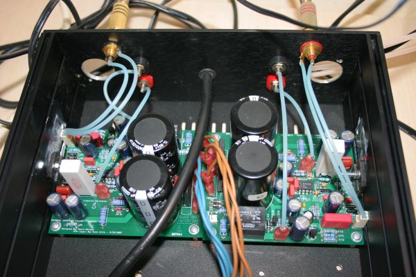

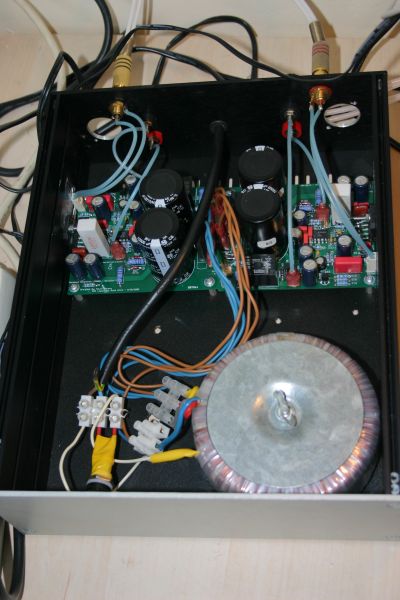

hi all,
after starting my master's thesis I finally got round to putting the myrefs in a case. After some initial testing I decided to rip out the wima input caps (as the "pre" i'm using now has 0v offset -it has its own output caps). A good decision. Much more details and less flappy bass. A stunning amp I must say. Better than any chip-based amp I've ever built before!
My impressions: it has nice, fluid highs, a midrange to die for (oh, diana krall's voice! ) and a pretty deep, sturdy bass.
Hats off for Russ & Brian!

Hi Matjans! Thanks for the kind words, you made a very nice amp. I like that nice compact case.
I agree with you fully on two points:
1) Yes, no input cap is always better than *any* input cap if you can do it. You must have no (well tiny) DC on input as you stated.
2) And yes, Diana Krall has a voice that is very easy to listen to!
Cheers!
Russ

I'm using a late 90s lightly modified Denon hdcd player into the kookaburra into the MyRef with no input caps and feedback 220uF electrolytic bypassed with a 1uF mylar. DC only went up 1mV for each channel once the input caps were removed.
I removed the input cap and bypassed the electrolytic at the same time so I'm not sure which made the bigger difference....but I do believe there was a small overall improvement on an already excellent sounding amp.
rabstg said:I know it's been asked before, but can the caps be removed if the amp is driven by the Kook?
As long as the source to the kook has no DC you betcha. The kook has no input or output caps on board, so if you have a source with DC you would have to add an input cap to the kook anyway.
