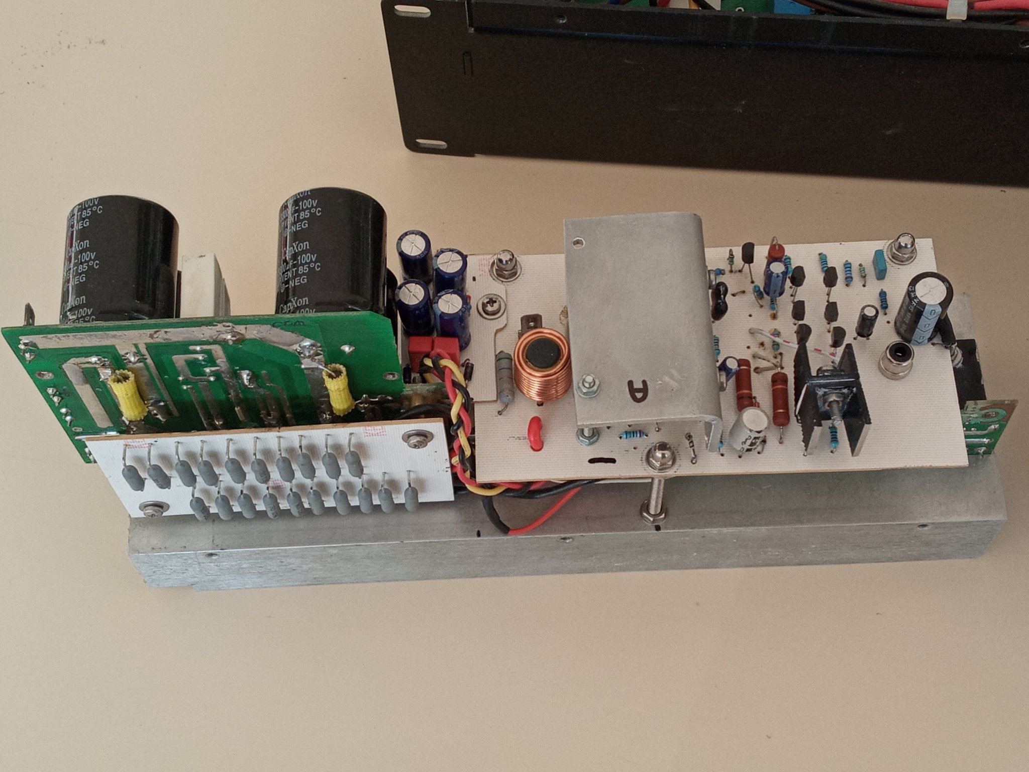

Since the issue of crackling sound has been re-encountered, I opened the amplifier box to do repairs to the amplifier modules. I am attaching a much better quality photograph of an amplifier circuit complete with its heatsinks.
DIY is hard, but it is fun and satisfying in the long term. The module illustrates clearly that DIY without special tools was a factor in its building.

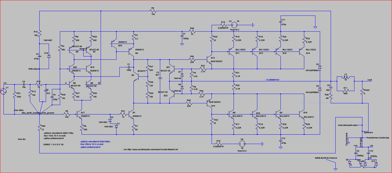

Having the innards of this amplifier dismantled I intend to do some more changes to the circuit according to advice given to be by mjona some over two years ago. These changes involve the value of the resistors feeding the bases of the driver stage. To tame the amplifier from aggressively clamping onto a rail, I had to add two resistors in series with the emitters of the driver transistors. These transistors already have their emitters sensing the current through a 0.1 Ohm resistance. The emittter resistor value is 3.3 Ohm. My intention is to increase the resistors' value feeding the driver bases in the hope of achieving DC stability that way.
Why is the amplifier clamping without the above mentioned resistors? My humble hypothesis.
The driver transistors' input characteristics have very sharp current increases for very small voltage changes. A resistor in series with their emitters componsates for this by stealing the extra voltage needed to cause these abnormal current increases. Needless to state, I could not simulate this behaviour notwithstanding I am using the same transistor numbers under LTSpice. My temptation is to change these two transistors with two with a better behaviour.

I think you have a wheel within a wheel with the larger feedback loop of the CFP with local nfb from your power transistor emitter resistors and these are somewhat out of phase. This situation is eased if your power transistor emitters have a direct connection to the supply rails and the ballast resistors for these are placed in the collector connections to the output line.

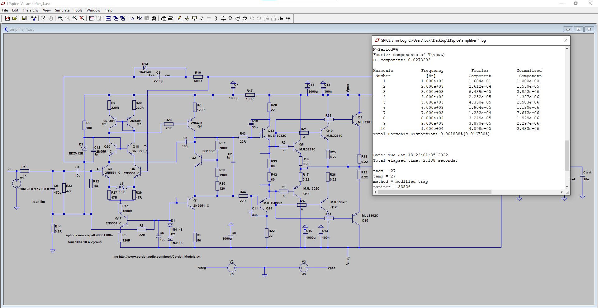

I have simulated the circuit with 3R3 in the driver transistor emitter connections. These will cause the collectors connected to the power transistor chains to move closer to the supply rails to the point where setting the output quiescent current becomes a problem. Reducing this to 2R2 makes some small improvement. I looked at the Vbe section but didn't spend a lot of time with this as my wife has care needs.
I have attached a couple of simulations you might be able to make use of. THD is a little better with the xyz circuit.

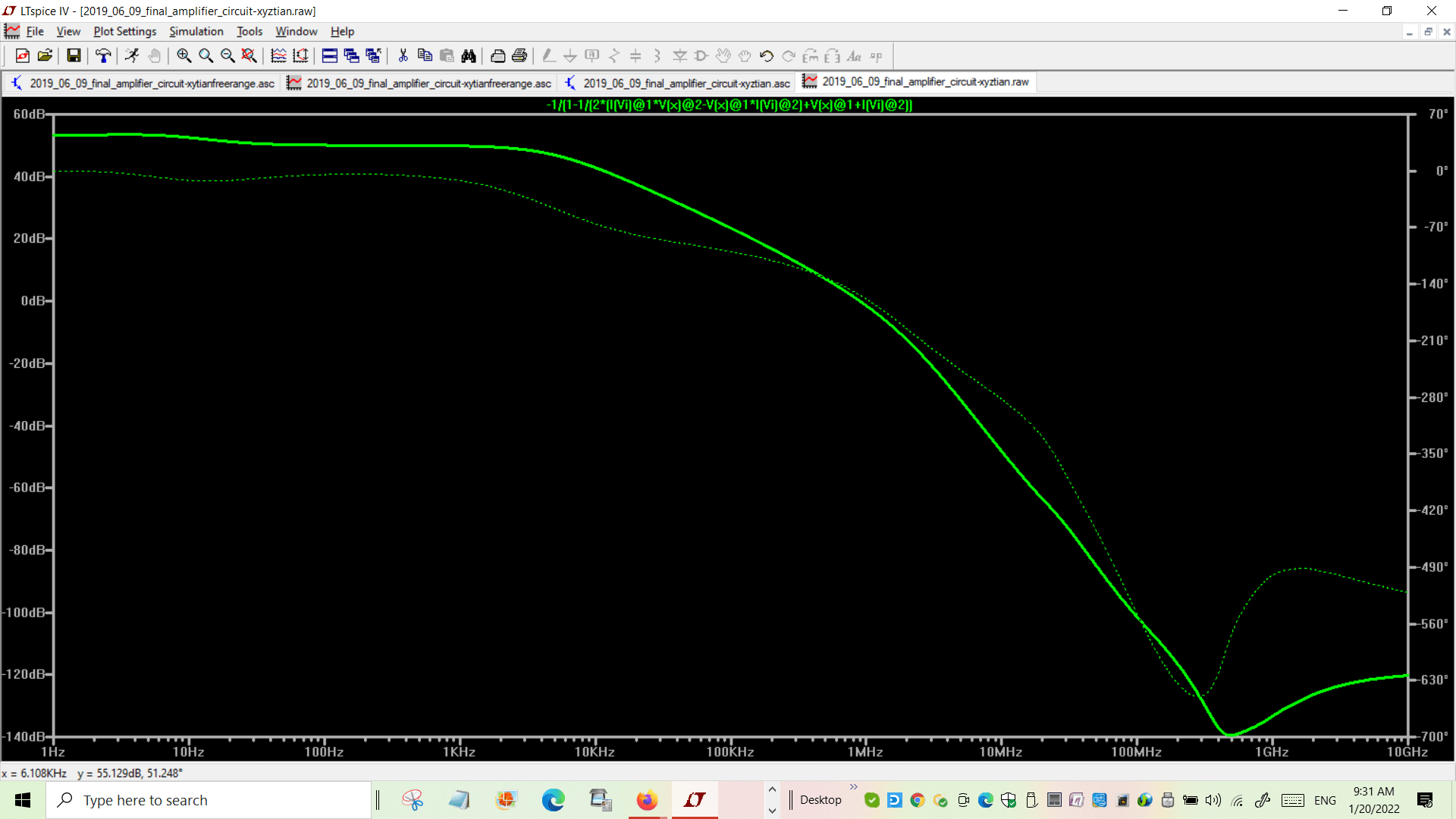

I had some input around post 190 where I talked about a lower power version. In this like you I omitted Q5 which gives rise to an anomaly at low frequencies in a Tian plot - this has some waviness at the top where it should be a straight line. If Q5 starts to limit the collector current in Q4 in normal rather than fault conditions the result will be sampled by the 100pF nfb capacitor. Q4 is already protected by a base stopper resistor and the added components to include Q5 seem to be an over complication.
To mjona: Thanks for taking the time to reply. It is important that I understand why the introduction of the two 3.3R driver emitter resistors make achieving a bias a difficult task. I experienced this in practive when I was setting the amplifier up and had to use these resistors. When I have time, hopefully tomorrow, I will look again at the thread to try to understand why these resistors cause trouble: I would like to remove them but the two driver transistors seem to have different transfer ratios (betas). This may cause one half of the amplifier to clamp because of the extra unbalanced gain.

Your output transistors have emitter resistors which will have some limiting effect on current due to nfb signals across each of these resistors. You have the same situation with the 3R3 driver transistor. I found with this arrangement it was not possible to set the output stage standing current. At an inconvenient point no change to the trim adjustment made any difference. Moving the power transistor emitter resistors so these were in series with the collectors made all the difference. The 3R3 emitter for the drivers is still there.To mjona: Thanks for taking the time to reply. It is important that I understand why the introduction of the two 3.3R driver emitter resistors make achieving a bias a difficult task. I experienced this in practive when I was setting the amplifier up and had to use these resistors. When I have time, hopefully tomorrow, I will look again at the thread to try to understand why these resistors cause trouble: I would like to remove them but the two driver transistors seem to have different transfer ratios (betas). This may cause one half of the amplifier to clamp because of the extra unbalanced gain.

A stripped down version of the circuit minus all short circuit elements is attached. If you like the emitter resistors in the output transistors there could be other ways to deal with the situation like increasing the values of R20 and R22 to increase the voltage drop across the base emitter junctions of the output power banks.
Well that last suggestion should work. One point I forgot to mention is that decreasing the closed loop gain reduces THD. You can use an IC op.amp to make up for the loss of gain and since this would occupy a smaller area than your power amplifier does the whole will less sensitive to picking up radiated fields and have lower noise in general.
