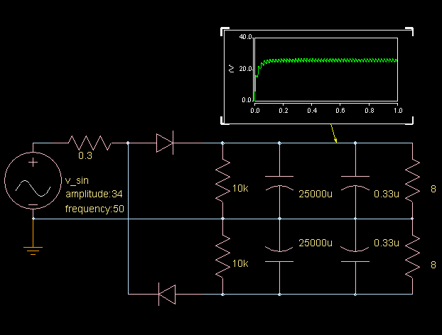

I've 'designed' a PSU for my amplifier. The trafo is assymetrical, but I create a symmetrical supply out of it for the amp.
Power-on current will be around 30A and operational current will be around 12 A (through the diodes).
The 0.3 Ohm I measured simply with my multimeter on the trafo terminals. I don't know whether that's correct, but 0.3 seems reasonable.
Voltage ripple is 2 Vpp.
Please comment on this schematic.
