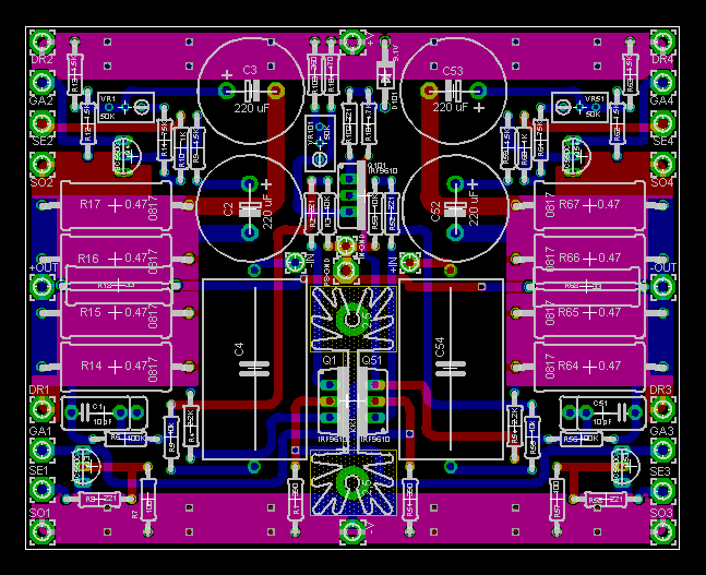

Hi all,
well, as for the input caps, no way!!!
They wouldn' t fit on this board even leaving the heatsink out, unfortunately PP caps are wayyyyyy to big. Using MKT caps would make things easier, but I' m not sure the sonic results would be as good as with PP...

Version 5 - Input caps
Hi all,
well,version 4 has been trashed, don' t ask me why...
I redesigned the board completely and now I have found the place for two PP input caps
The two resistors between outputs and ground (33R 3W) will be mounted on the bottom part of the board, OR stacked above the big output resistors.
Any comments?
Bruno

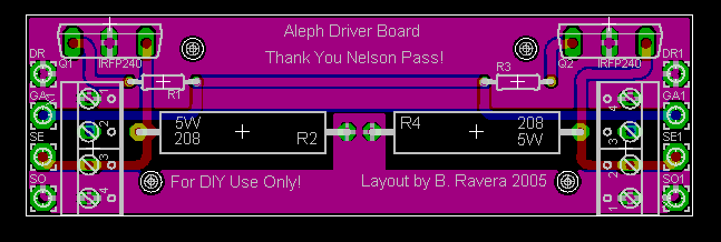

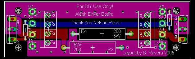

As promised...
Hi all,
here' s the new power poard (4" x 1.2"). Any comments?
Bruno

mark stones said:Have you found room for the soft start, Just kidding.
Bruno
Re: As promised...
Move the "drain" track into the middle.
Carondimonio said:here' s the new power poard (4" x 1.2"). Any comments?
Banned
Joined 2002
Re: Re: As promised...
Hi Mark,
to move the "drain" track into the middle I should change also the order of the connecting pads. Not that important, but I do not like it aesthetically...
So, after some thoughts, I decided to revert to the previous placement of the mosfets (along the long side), but keeping a greater distance between them.
What do you think?
Bruno
Hi Mark,
What do you think?
Bruno

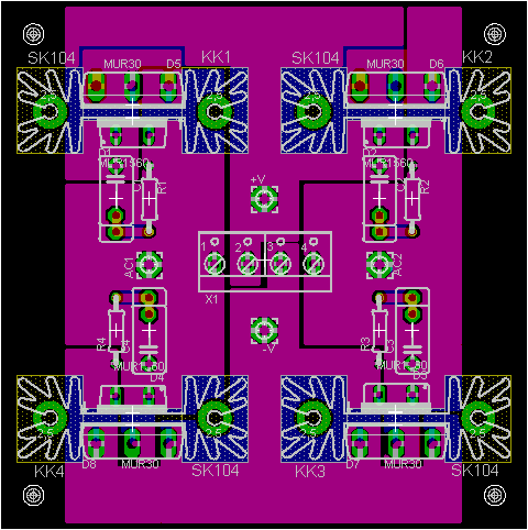

Rectifier Board
Hi all,
well, I designed a first draft of the rectifier board.
It' s 3.2" x 3.2" and can accommodate both TO-220 (MUR15XX and the likes) and TO-247 (MUR 30XX dual rectifiers with common cathode) rectifiers.
Usual question: any comments/suggestions?
Bruno
P.S.: Mark, you weren' t being pedantic, your suggestions have been deeply appreciated and very useful for a noob like me!
Hi all,
Bruno
