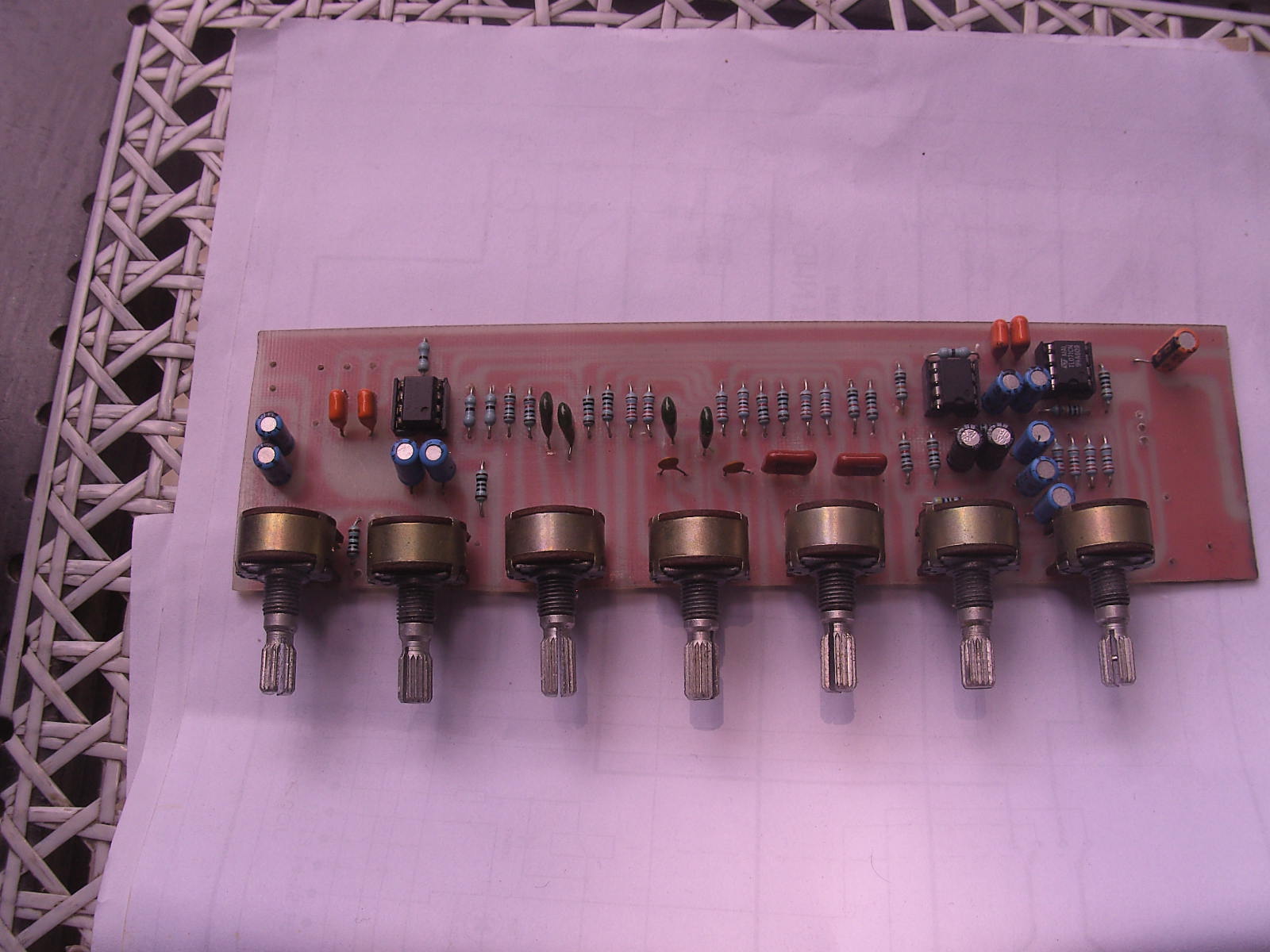

hey diyers
greetings tone control for my dx blameless mid base treble balance volume and mic input tlo72
thanking you
andrew lebon
