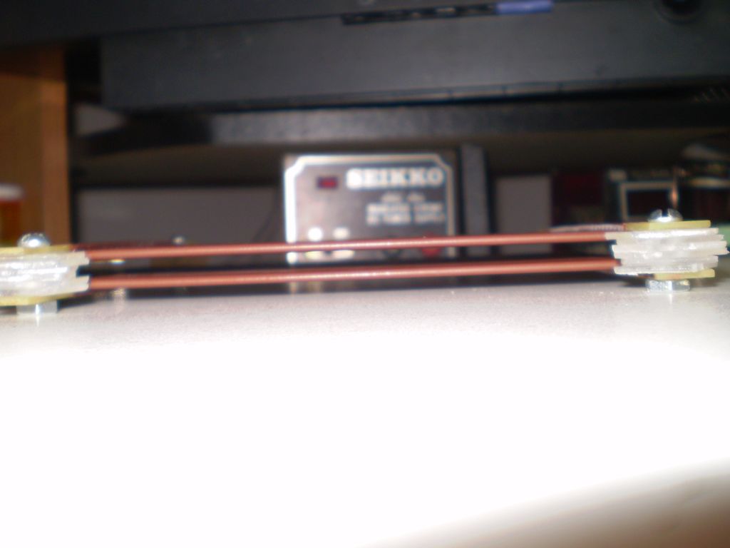

Set the stators up just as if it was completed with some plastic spacers in between them and run them with the bias and the amp with a source just like normal.
It would be safer to have the inputs more separated although having the 120v in the middle will add some protection.
But, If it arcs over to the 120v line you can First blow the bias transformer and/or it can travel up the line and take something else out.

I just completed this test with my new stators and it passed.
Although I didn't use the transformers because my supply puts out 13.61Kv.

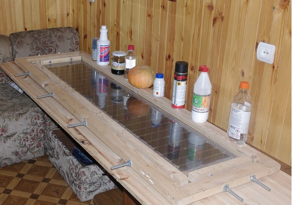

How did you manage to rip the mylar off? If a stretching frame is used then it's quite easy to put it over the panel and cut mylar with a hot soldering iron after curing. Difficult to do wrong. Also the mylar is pressed into by weight of the frame and bonding surface becomes extremely flat. Some vegetables could be used for higher downwards force but it's not really necessary :).

I tore the Mylar when lifting the panel off the stretching table, where I had not cut completely through the Mylar. It was easy enough to get the old epoxy off the frames. I have been using alcohol - probably just need to give it more cure time. Thanks for the great tip on using a soldering iron!

Thanks, but this frame has had some flaws.So I have redesigned the stretcher to be significantly larger and pull all four sides with wing nuts.
Making the stretcher wider and longer has one advantage : highly stretched areas at corners which could form partial resonances are just cut off.
I have been able to achieve about 2-3% Fs accuracy through mechanical stretching now; however there are some steps , like gluing mylar with glue and not double sided tape which lets it go over 12 hour period through which epoxy cures. Also it's very important to stretch the film lightly but evenly prior to gluing to the frame.

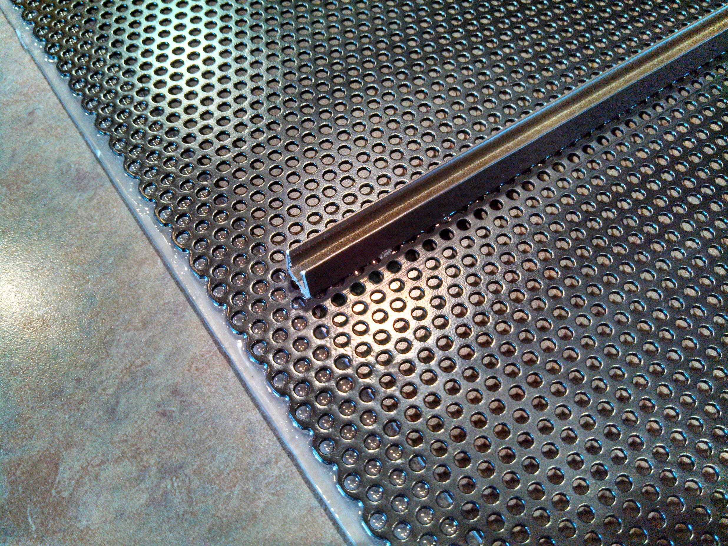

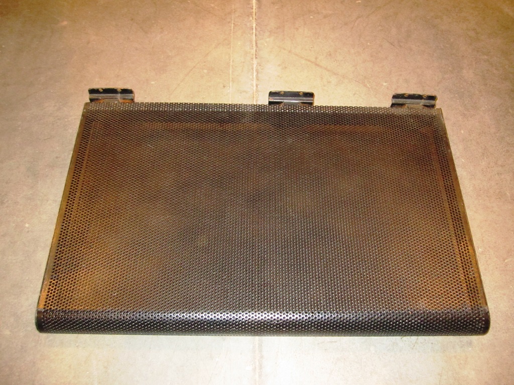

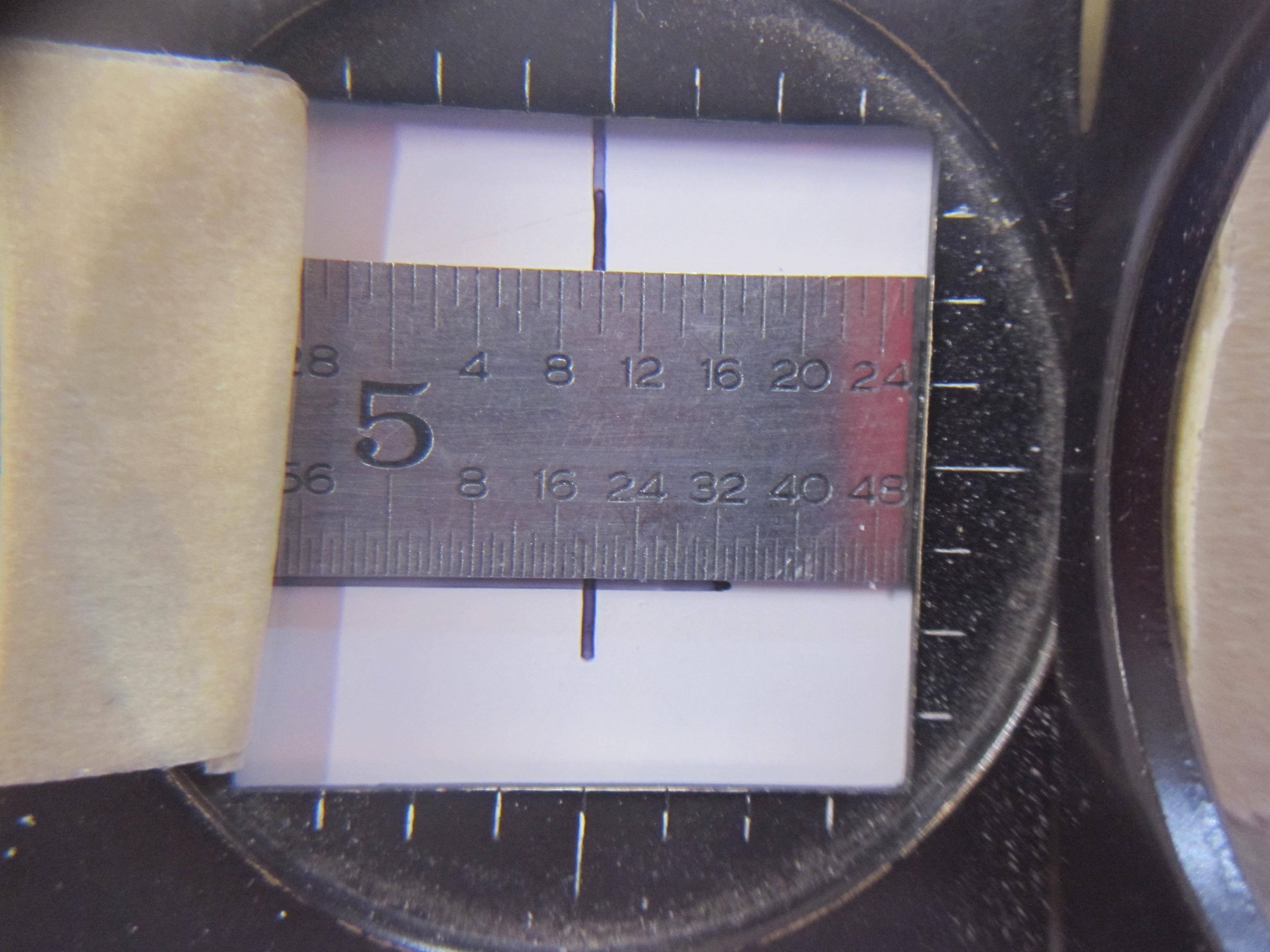

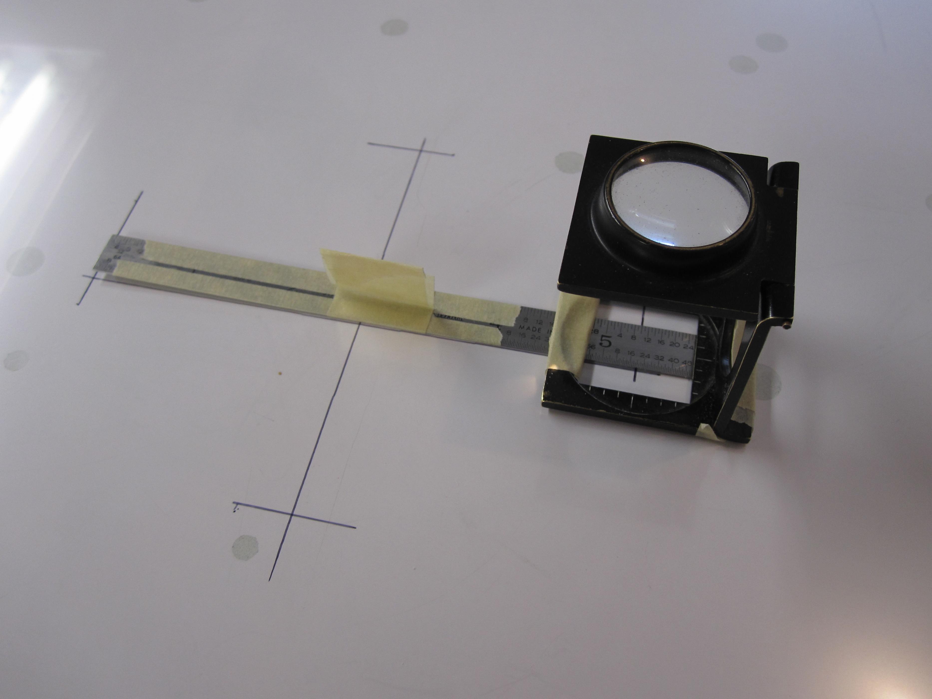

Well, I finally got these panels put together several weeks ago and thought I'd update with a few pics. I ended up with 1.25% stretch. With the setup shown, I was able to measure fairly accurately to 1/64". The stretched Mylar is so fragile, that it broke once when I nicked it lightly with my magnifier!

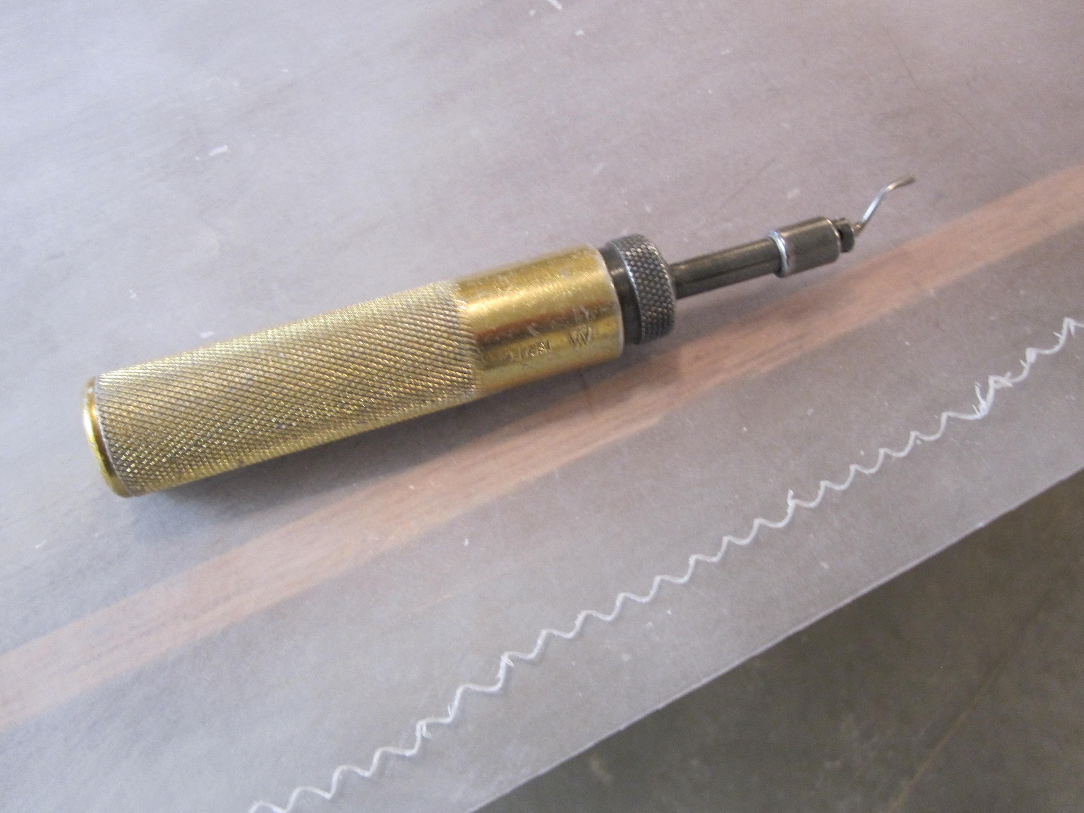

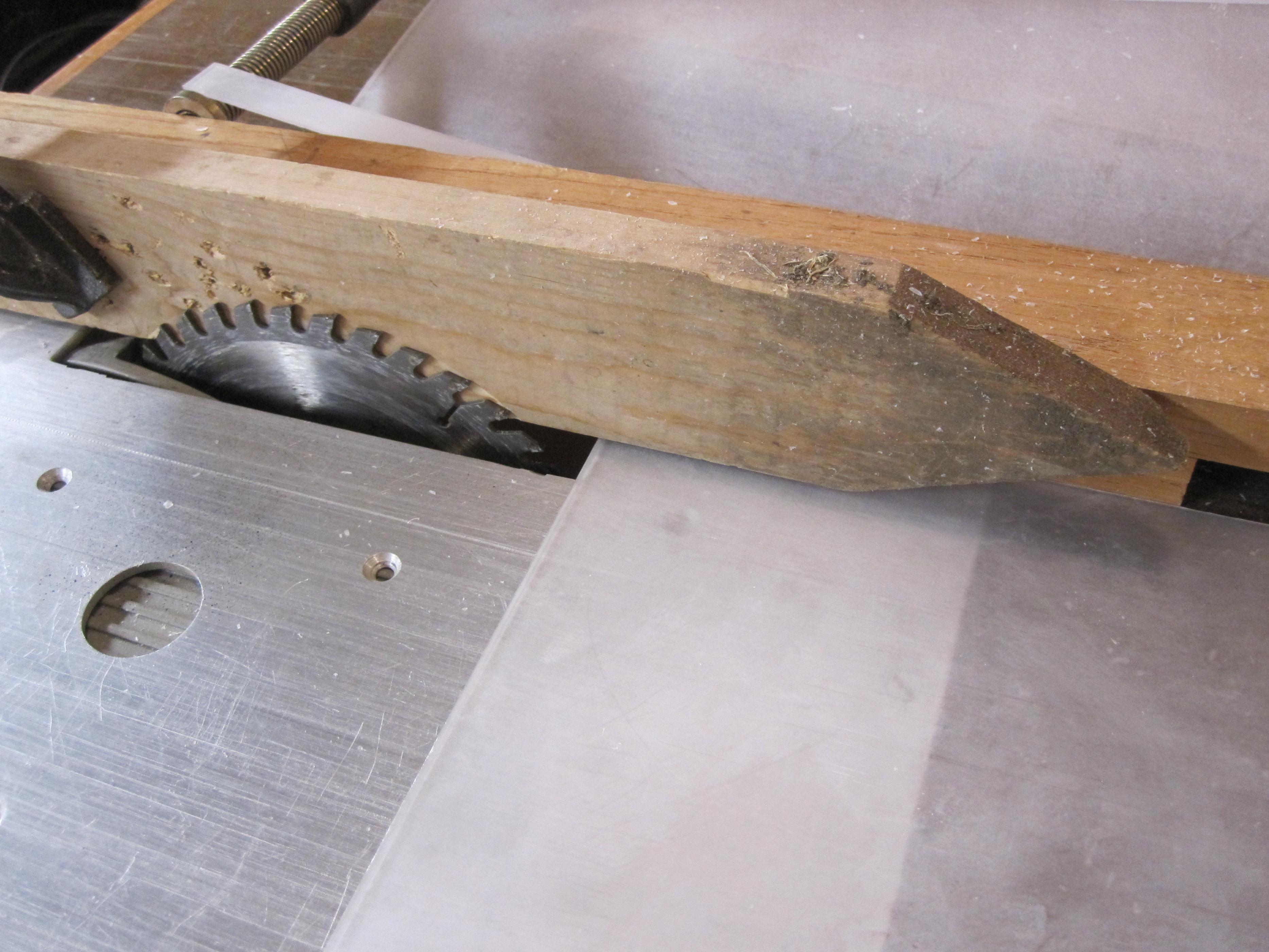

I used 1/16" Lexan for spacer material. It is 3/4" wide, leaving 1/8" beyond the edges of the stator to block high voltage. I ripped it into strips on my table saw, deburred and sanded it. After aligning the glued front and back stator holes, I notched the Lexan, as a gauge point for re-alignment on the final glue-up. Also 3/8" wide aluminum extrusions were epoxied over the internal Lexan spacers.

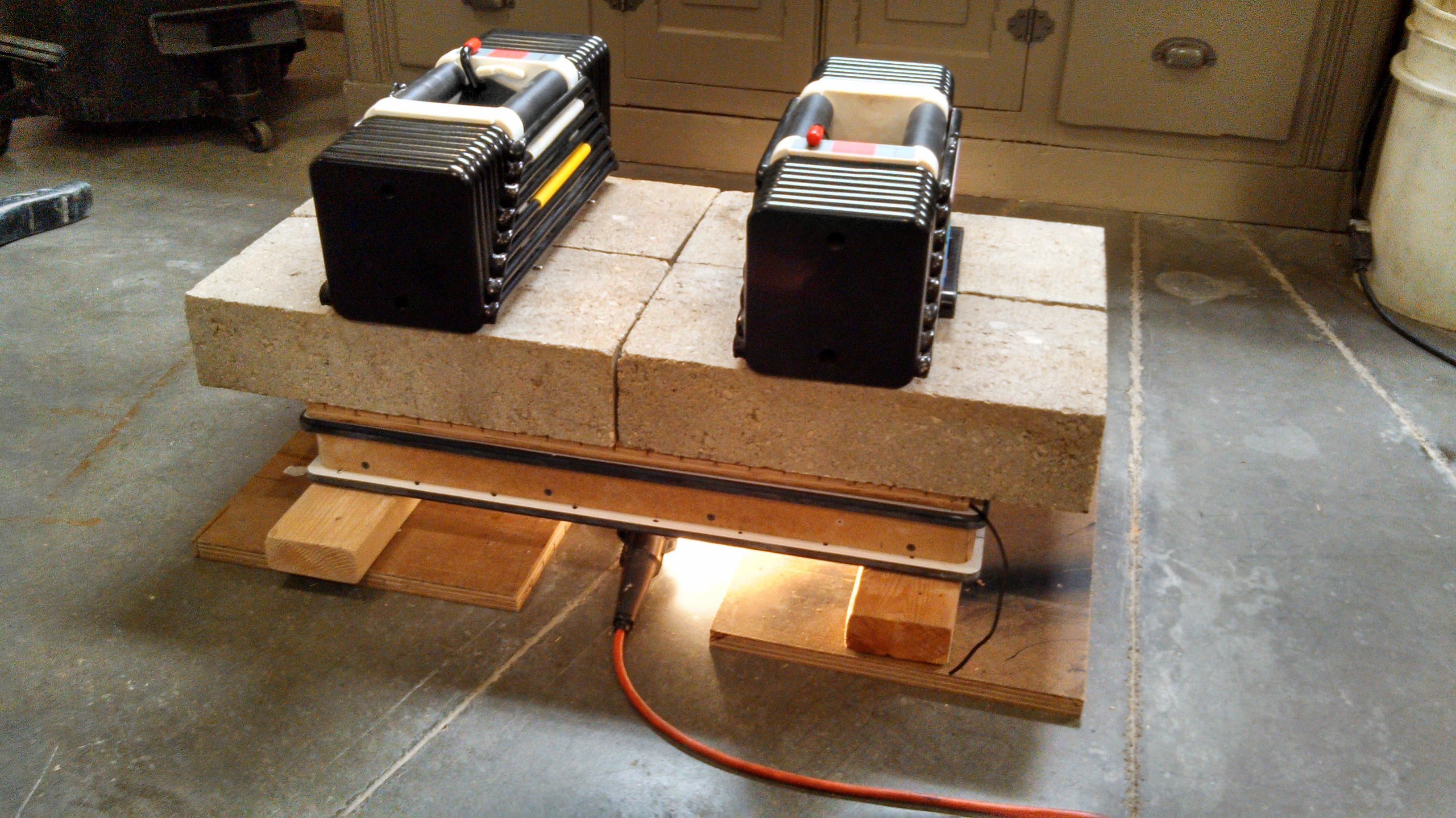

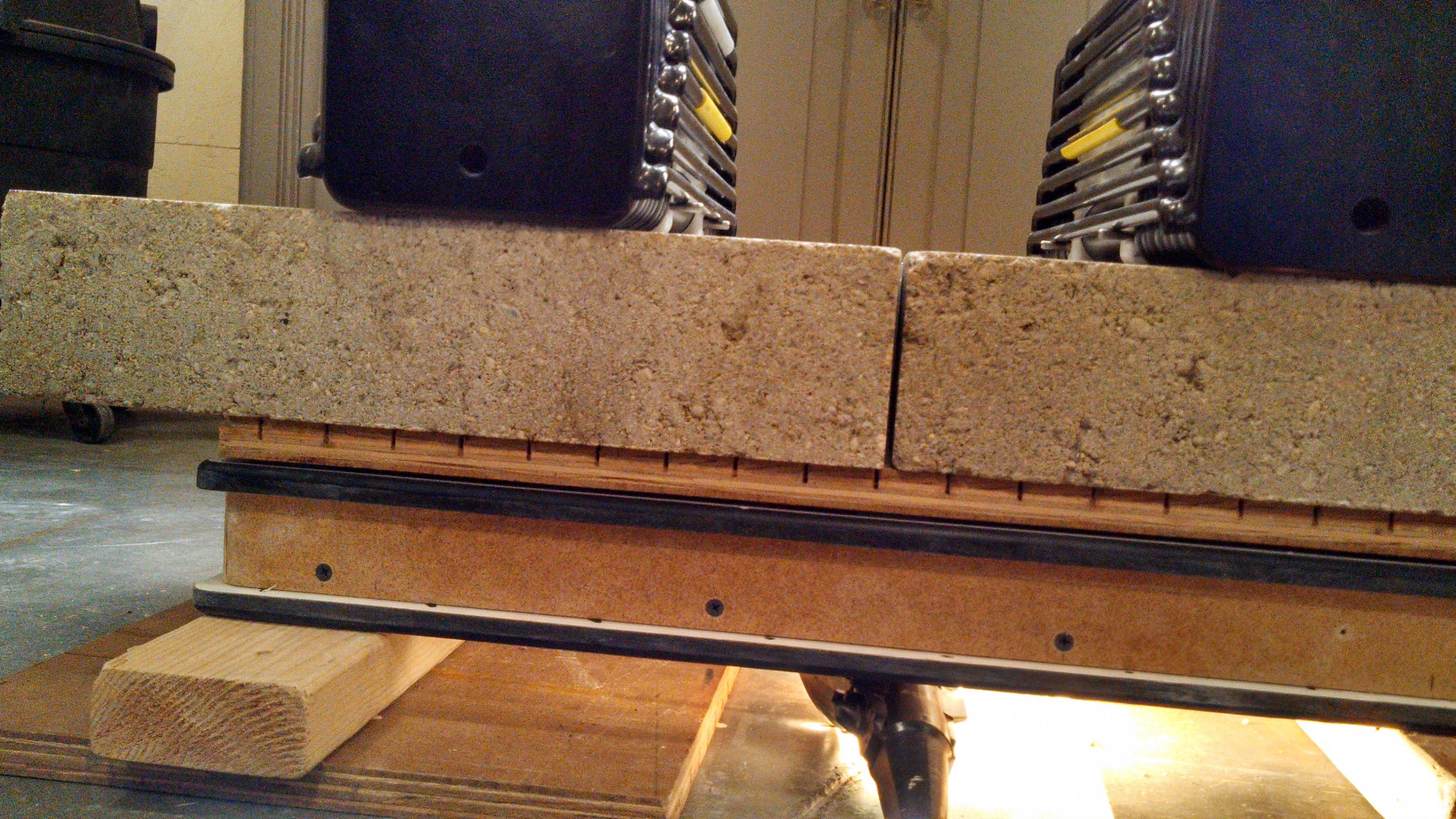

Whether gluing the Lexan to the stators, stators to the Mylar or stiffeners to the stators, I used the shown weighted setup. Sanders really emphasizes flatness of the assembly and enough pressure to get everything together with a consistent caliper. Nothing special about the grooved plywood - something from another project. Murphy struck once before I realized the drainage slope on my garage floor, so the assembly slid on the epoxy and smeared it. It was cold in the garage, which was good for increasing open time on the epoxy. The trouble light added some warmth for curing the epoxy.

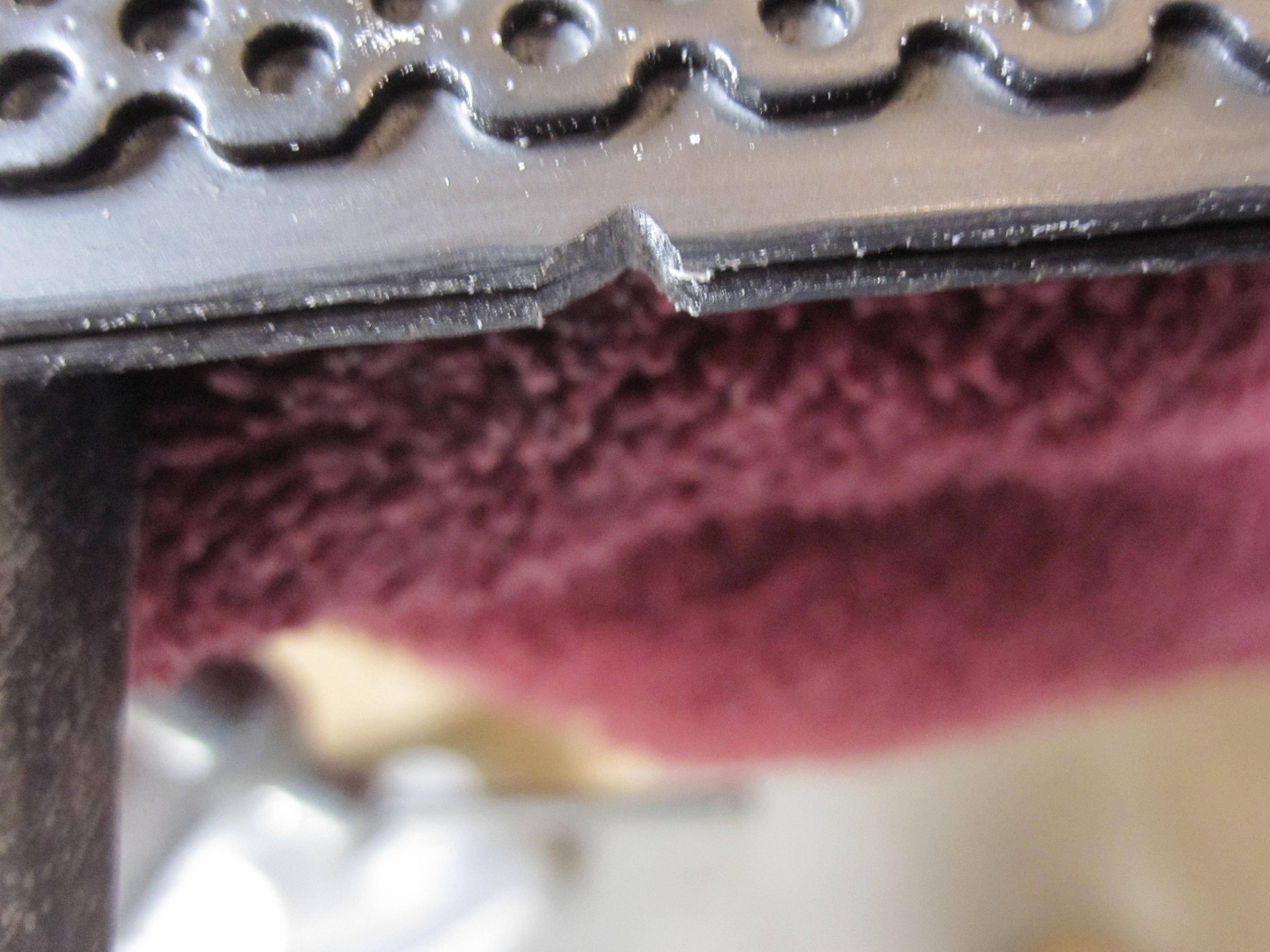

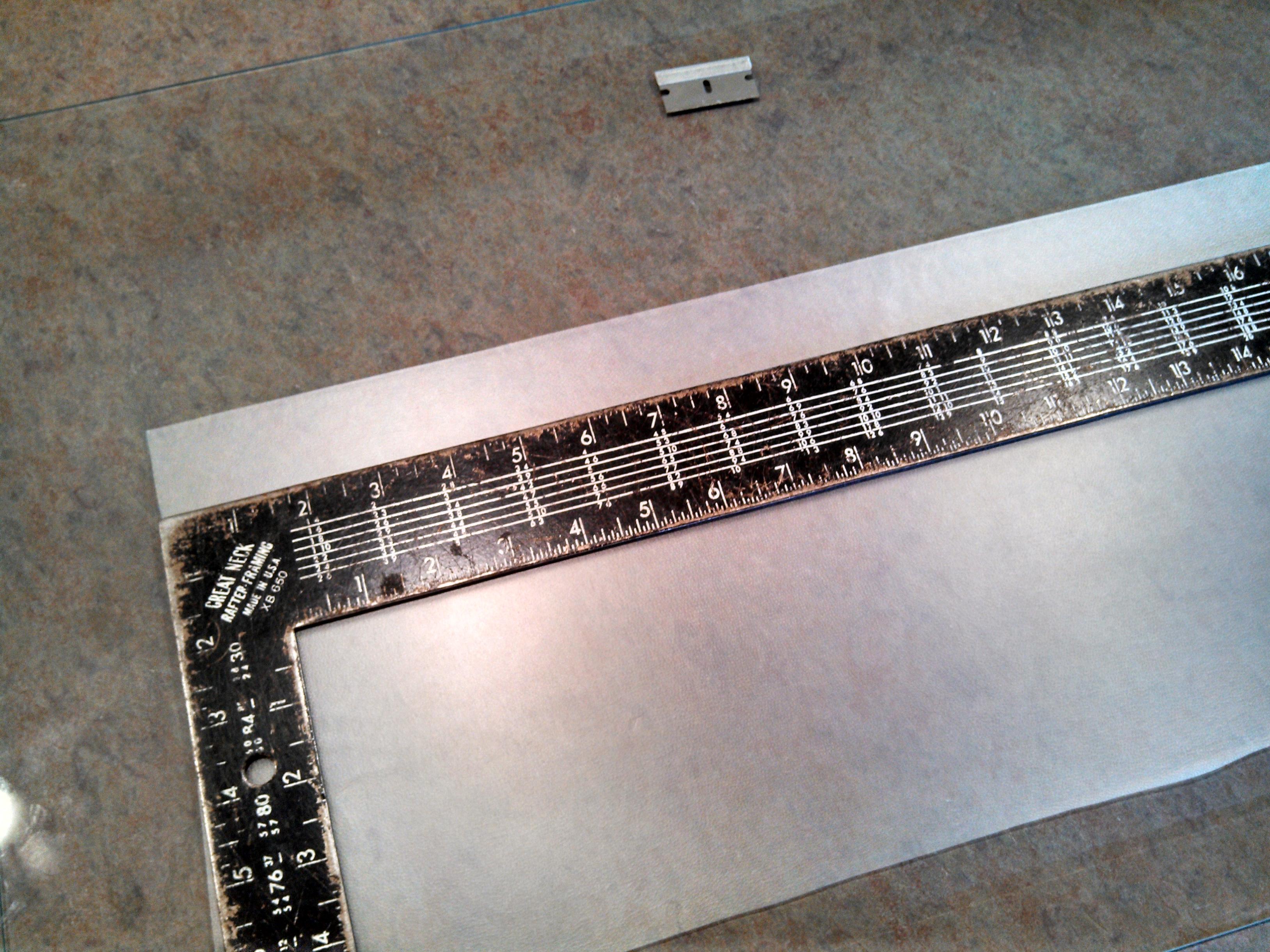

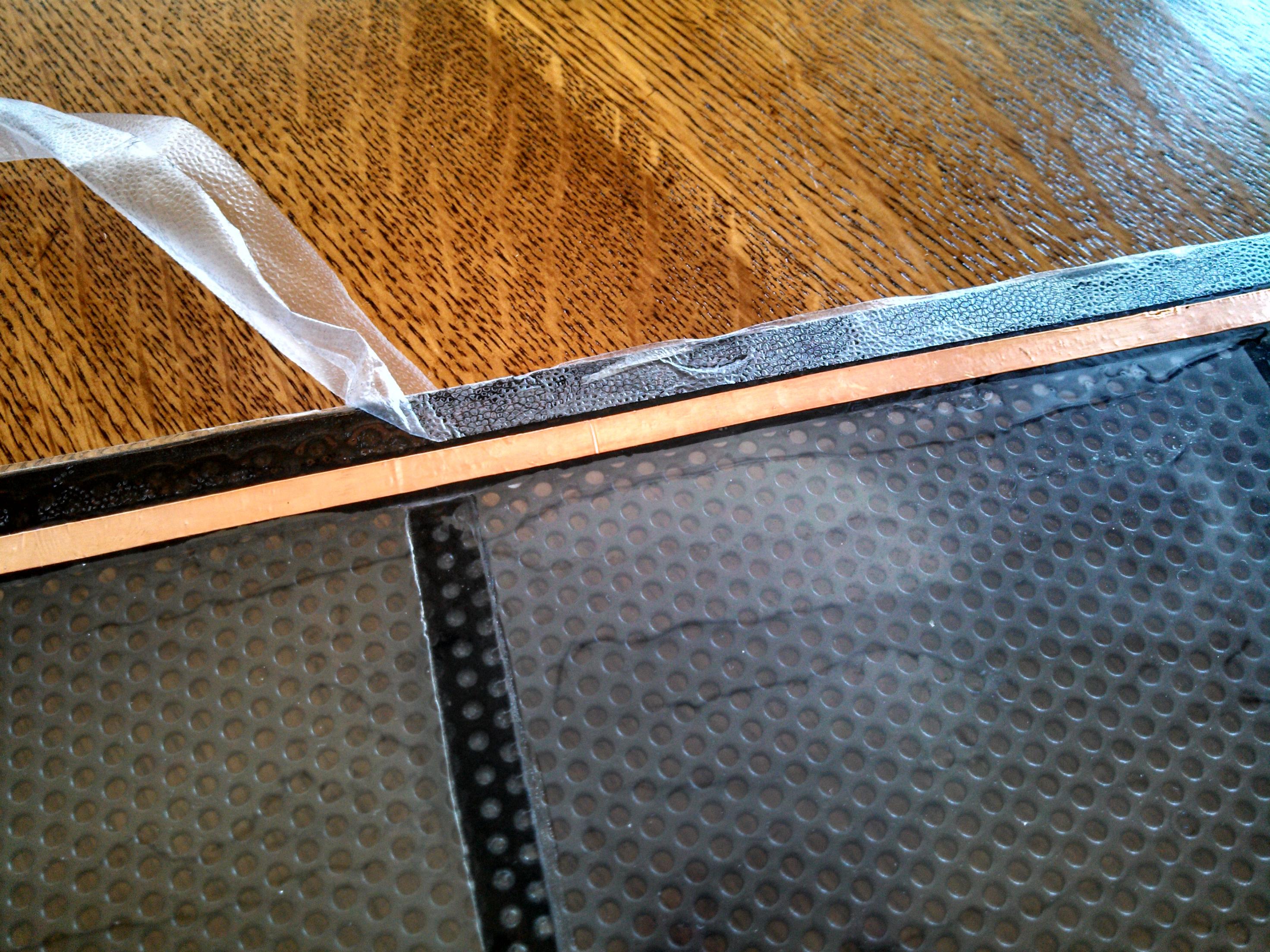

I cut strips of "Press and Seal" food wrap to mask off the Mylar before spraying on the Lycron Crystal. It has low tack, but don't leave it on too long. I'm pretty sure I applied too much Lycron in one coat, as it dried streaky. Too much experience, I guess, at getting a full wet out coat when spraying paint. The copper charge ring was applied with the conductive adhesive to the Lycron side of the Mylar. I told my wife the panels looked like place mats, while curing on our dining room table!
You can clean off the Licron with a cotton wipe soaked in acetone and re-apply.
Lukas.
Lukas.
I found that the coating tends to be cloudy where wet streaks occur in the application, and especially so when applied in humid conditions. However, the streaking would not adversely affect performance, only the cosmetics. It's hard to apply a uniform coating from an aerosol can.

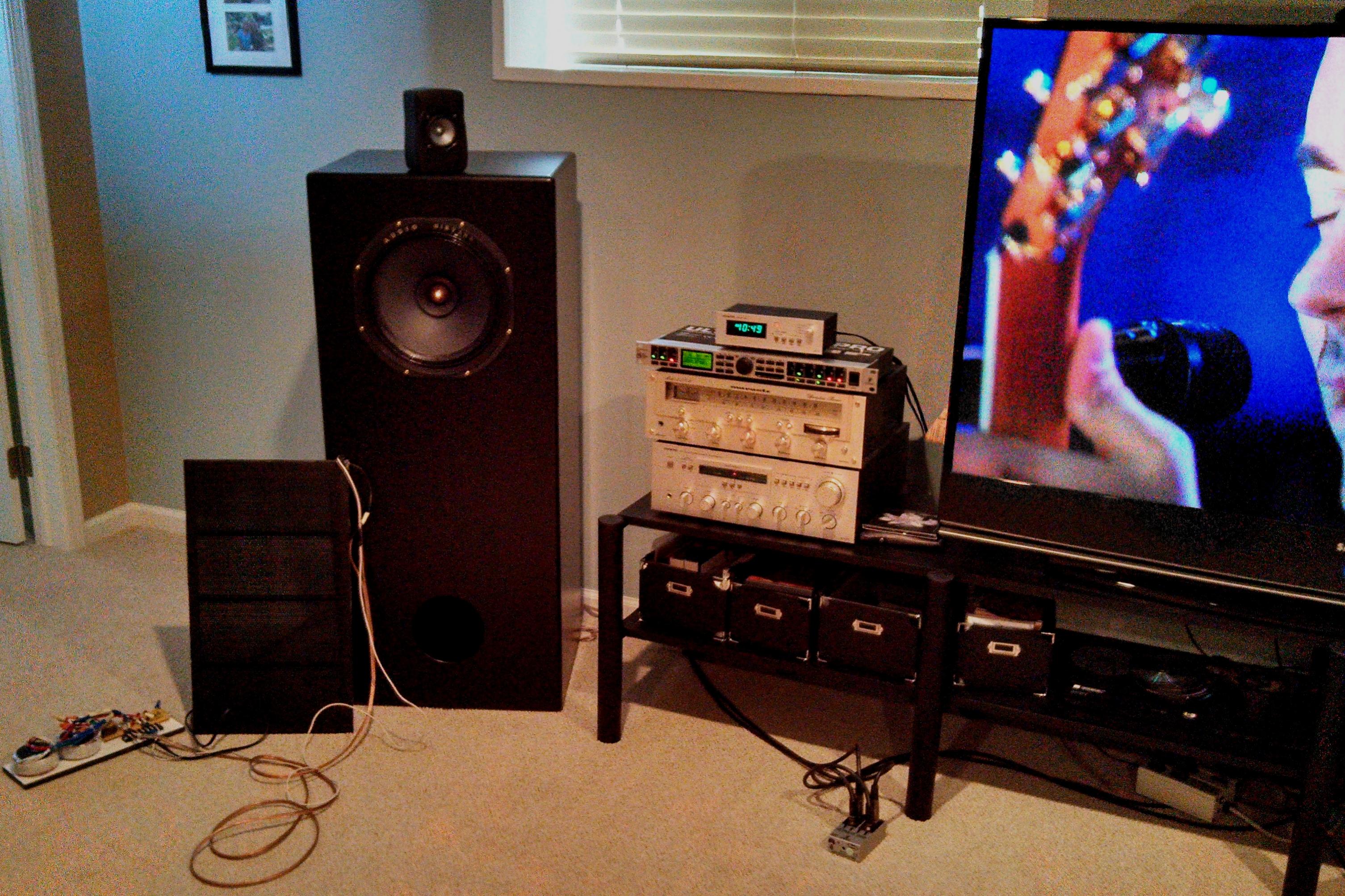

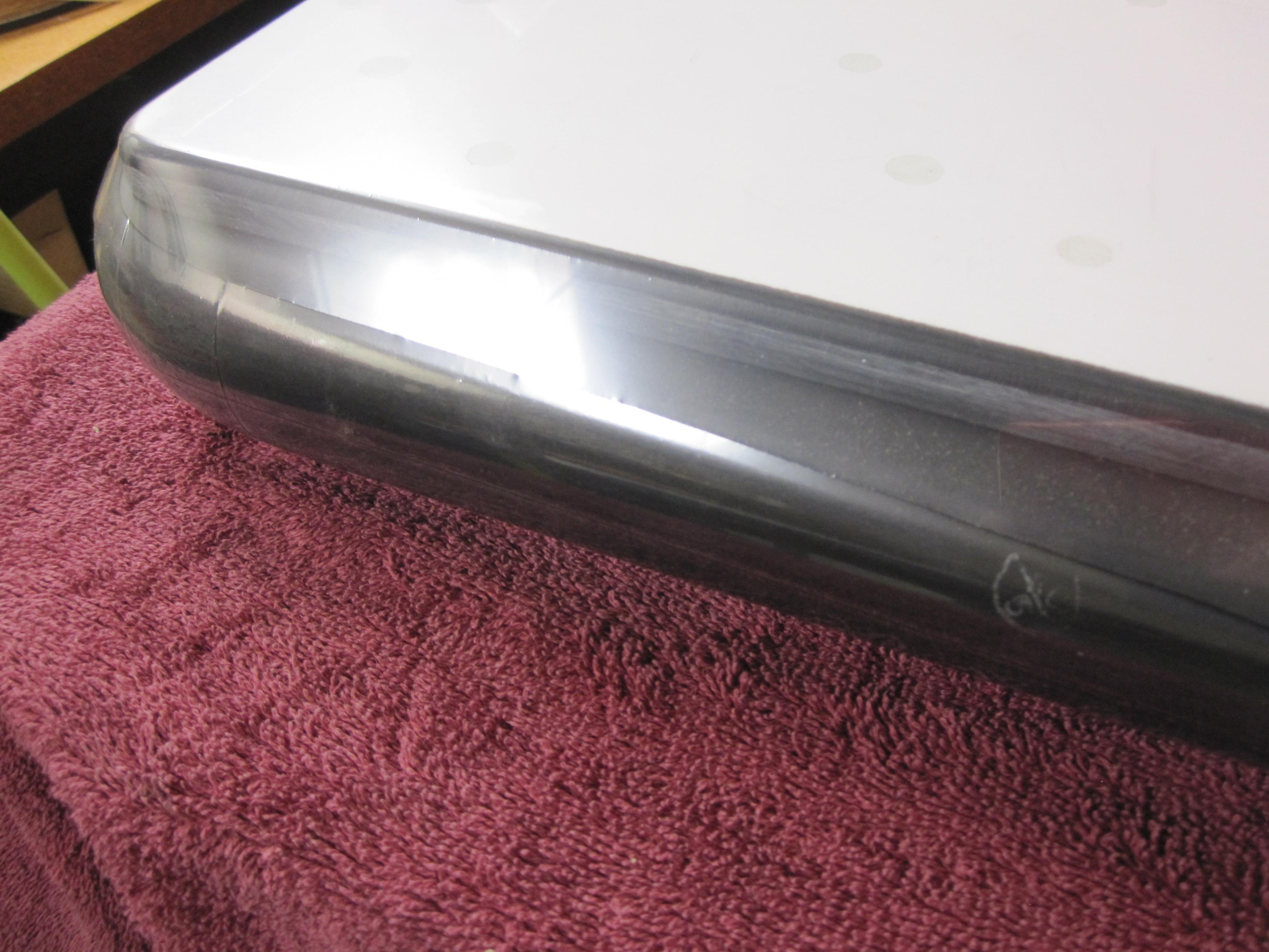

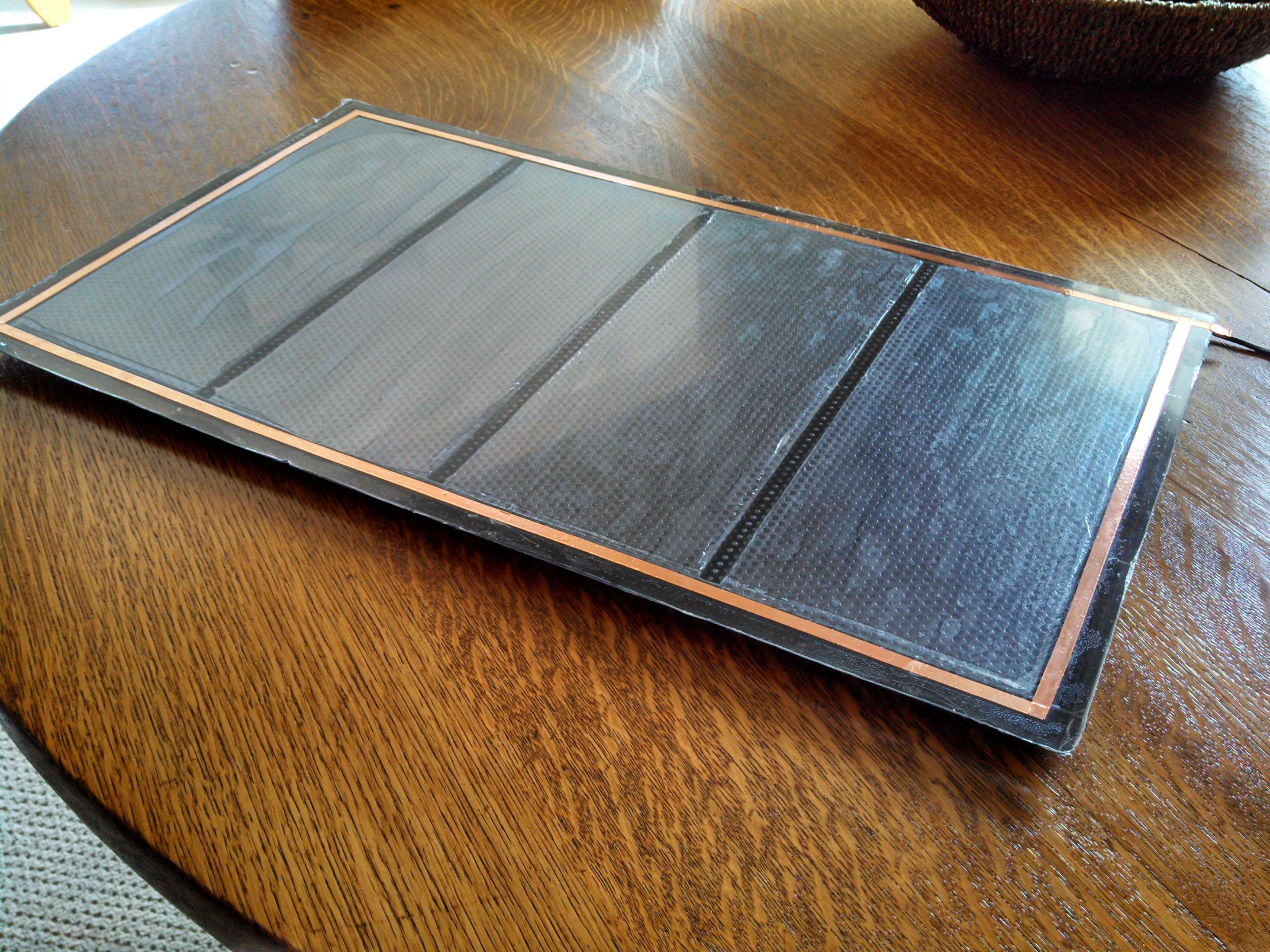

Thanks for the feedback guys. I wonder if wiping the Lycron on with a microfiber cloth would put down an even coat? The pic below shows the corner block that was positioned in the Lexan notches - two on one side, one on the other. This kept everything aligned while the epoxy cured.
I was so pleased that both panels worked as soon as I fed them! I was almost expecting them to not work, for some reason or another.
A few initial observations:
I'm surprised and pleased at how loud they can play, given their size and only driving with 30 wpc, crossed at 500 Hz.
I really agree with Charlie's friend, who summed it up by calling them "remote headphones"! I thought I knew what beaming was with the 12" full rangers that I have, but these really do. Charlie - you are so right about how phenomenal a female voice sounds! I just hear so much more - in everything I listen to.
I have not even made frames for them yet. The internal stiffeners and using epoxy makes them quite rigid. The pic shows them on the floor, but I elevated them and did some A/B'ing with a make-shift open baffle mid-bass and am convinced I will need to go that route, as the ported bass takes away the cleanness of the stats.
All in all, very happy with them and it was such a rewarding project. I just unexpectedly acquired a pair of BG 50's and have been playing with them. The stats are great for one listener and I believe I prefer them for that, but the wide dispersion of the BG's is very appealing. I have some questions about them I will ask in a new post.
