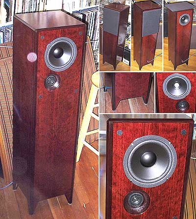

This is a preview picture of the bipolar alphaTLs that i built for my brother. I'm putting together a page for the TL site with more details (and a bigger picture ).
This is a "Frugal-phile(tm)" class speaker, and despite still needing some detail work they sound very crediable.

Look great!! I can't tell from the pic, what is it that's holding the grille on?
Dave will tell us but if I had to guess?Velcro strip perhaps?
Well done Dave,
Re: ALPHA
the Cherry stain gives them the lovely reddish colour -- something that so far has gotten very high SAF (across a sample set of a number of Ss)
BTW i get no credit with how they look, ChrisB is the cabinet maker. I send him drawings (or in this case he only needed a couple numbers) and the cabinets magikally appear.
self-stick Velcro spots -- they come in packages of 10 at Home Despot.

pinkmouse said:but no construction photos, shame...
Any internal drawings so we can see how you configured the line?
ChrisB doesn't have a camera yet... and they would be pretty boring anyway -- it is 5 pieces of wood.
The beauty of the alphaTL is that it is so simple. Throw a few numbers in a spreadsheet (or use the nomographs that will be in the published article -- coming to an audioXpress soon) and out pops a design.
Rick Schultz (exolinear) has done an excellent job exploring quarterwave space and coming up with a set of plug-n-play working parameters for the simplest of tlines. I can't talk about details until the article hits, but the line configuration is the same as the TLb. El Pipe-O and my toobz all have the same topology as an alphaTL -- but aren't dimensioned correctly to be alphaTLs.

Pre-veneered 19mm MDF scraps stained cherry.

roddyama said:What drivers did you use? What's the story behind the horn loaded tweeter?
They use cheap MCM 6" (i have to go look for the number) & a surplus 14mm Delco tweeter.
Wave guide would be a more appropriate term. This is a little trick stumbled on by accident. The system is best described as full-range with a helper tweeter (6-7k up). The conical wave-guide gives a bit better match between the drivers HF and the tweeters LF dispersion characteristic. The loading also gives a bit more LF efficiency on the T. The set-back brings the acoustic centres a bit closer and cosmetically it works -- making what is a rather inexpensive tweeter look better.

As Dave said, "rescued from the scrap pile" cherry veneer factory laid on MDF core. Due to the the different age of material, there was significant variation in the color of the veneer ( although cherry is my current favorite, this oxidization is quite normal). This prompted the dark red stain.
My biggest suprise was how well the exposed edges of the MDF core took the stain. Sanded down to 220 with random orbit, then 2 coats of stain (second one washed with thinners) and 4 spray coats of nitrocellulose lacquer.

Stain (commercial solvent based wipe-on) applied directly to sanded veneer / MDF core. As cherry can easily go blotchy, I've found the fastest way for an even color is to wipe on 2 thick coats & wash down with lacquer thinner before each dries.
Usually 3 - 4 spray coats of catalyzed nitro cellulose lacquer with a quick 220 - 400g sanding between coats.

The alpha TL assumes the driver is as close to the closed end as you can get it. The area of the space above the floor should be larger than the opening in the pipe... too high up off the floor and you will probably lose some bass reinforcement. Still i have one in the works that will have the terminus significantly raised above the floor.
That means it´s favourable to 2-way woofer above tweeter geometry. Now, can one rotate an existing 2-way XO project, with tweeter on top?
