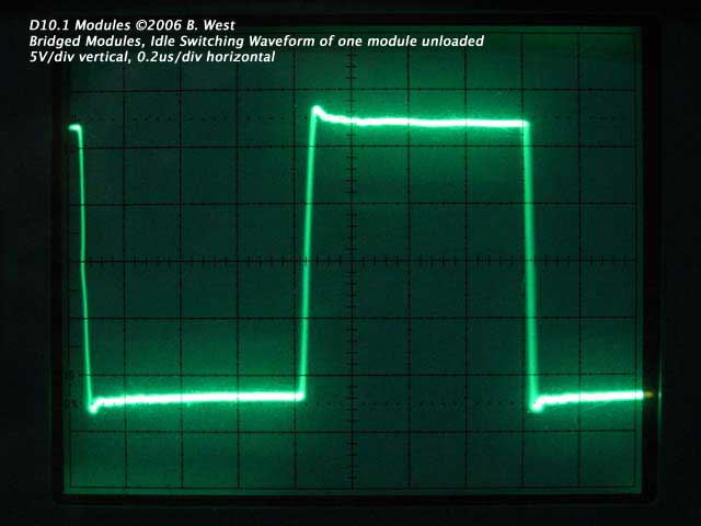

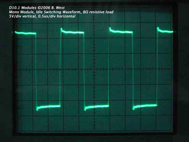

Attached is a photo of the switching waveform of one module of a bridged pair while idling. From the scaling you can see that the idle switching frequency is around 625kHz for the modules I tested. These had different value feedback caps and resistors that set the gain to 3.9V/V and lowered the switching frequency a little compared to the values that were sent out with the kits. The value of the feedback components in the kits set the gain to 8.2V/V and the idle switching frequency to around 660kHz.
This photo shows that the snubber could be further optimized to reduce the initial overshoot and further dampen the slight ringing. A slightly higher value resistor would be something I'd eventually like to try. As it is, the overshoot does not seem to be audible at all.

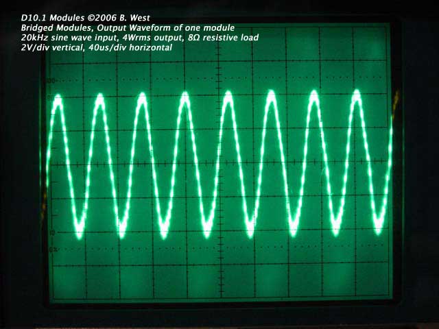

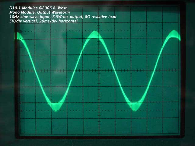

This is the output of one module of a bridged pair with a 20kHz sine wave input.
The input level was not changed and the output level did not change either, at a constant 4Wrms output power into an 8 ohm resistive load over the 10Hz-20kHz frequency range.
The output power is 4Wrms because I forgot I was measuring bridged modules and set the level so the output of one module had an amplitude of 4V which is 1Wrms @ 8 ohm for a single ended amp and 4Wrms @ 8 ohm for a bridged amp.

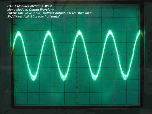

Mono module, 20kHz sine wave, 10Wrms output @ 4 ohms.
The frequency response was flat across the band at 8 ohms but drooped a little bit below 100Hz and around 20kHz with a 4 ohm load. Clearly the modules are more optimized for 8 ohm loads, but the tiny bit of droop at the extremes with a 4 ohm load would be very hard to notice, especially at the high end.

What does "gained up" mean? My scope is an old 15MHz Tektronix T922 so it certainly isn't top of the line, but I tried to do the best I could with my camera to capture the waveforms. It's really hard to get the trigger set just right so the waveform is still on the screen, and even then the scope runs out of intensity when the horizontal scaling is so low. I had to set my camera shutter to stay open longer to get the low frequency waveforms otherwise the shutter was way faster than the scope tracing the waveform! If you send me a nicer scope and a couple good probes I'll gladly do the tests again
In the 20kHz 4ohm waveform I got the trigger just right and you can see the residual switching ripple quite nicely in the output waveform. Even with it switching at 625kHz it looks pretty rough, which shows how higher switching frequencies would be more beneficial for accurate reproduction. I'll try to "overclock" one of the old modules and see how it handles (and sounds) switching around 1MHz.
