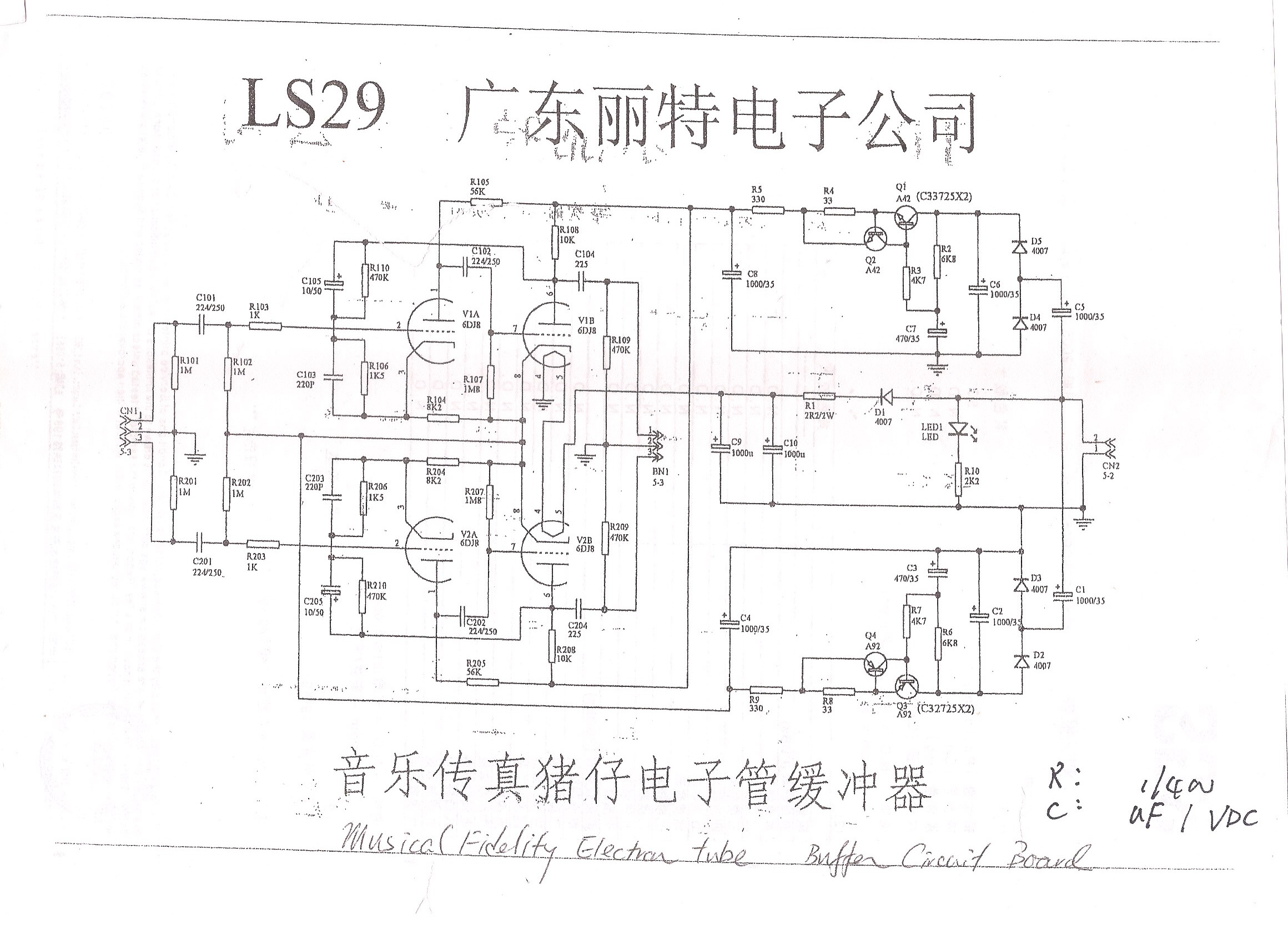

Musical Fidelity X10D schematic
X10D Mods
Hello Tube_Dude !
Not shure to have understood :
For a gain of 6, the resistor change from 1.5k to 22k : OK
So the ratio for resistors is 15 (not 5)
Now for the // cap : change the original 220pF (on attached scheme) for a smaller one with a ratio of 15 ? No ?
220 pf / 15 = 15pF
So sorry for my ignorance !
R.C.
Re: X10D Mods
Ciu said:
Hello Tube_Dude !
Hi Ciu
Sorry for the delay I have been to busy... :(
The gain is given by the formula I give in my previous post.
Imagine (all the people..... :) ) that you change the 1k5 resistor for a 1 Ohm resistor , we have:
1+ (1/ 4k7 ) that give
1+ (0,0002 ) or a gain of ~ 1
Now if you change the 1k5 for a 4k7
we have
1+(4k7/4k7 ) that give a gain of 1 +(1)= 2
Remark, that we have passed from a feedback rsistor value of 1 to 4.700 (4.700 times greater ) and the gain of the stage only have become the double .
Then for a gain of 6 the value of 22 k is absolutely correct.
I hope to be clear now... :)
Regards
PS: In your last schematic the 4k7 resistor become 8k2 , so for a gain of 6 the 1k5 resistor must become ~41k or a more normal value of 39 K
X10D Mods
Hello Tube_Dude
For a gain of 6 you must change the 1.5 K resistor for 22 k. As the resistor is 5 times greater , the // capacitor must be ~ 5 times smaller for the same time constant
That was the beginning of my trouble ! 22k /1.5k = 5 ?
In my study case, for a gain of 6, the resistor changes from 1.5k to 39 k, OK !
And the value of the cap, how to calculate, where do you find the ratio ? Any recommanded technology for the cap ? Voltage (>= 30v ?)
Many thanks for your patience !
R.C.

This is the diagram of the clone sold on ebay!
If you are building, use decent diodes and Panasonic FC 1000uF caps on the supplys and also choose something nice like Mundorf coupling caps on the output. These are the parts fitted if you upgrade the X10D. Also its worth getting cryo treated valves as they tend to be less microphonic.
