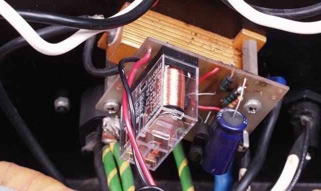

I have just fixed one of these, and it works fine and sound good and all.
But one channel (not the one I fixed) makes a strange power of sound. The outputs are not protected so you hear the emptying of the capacitors.
When one switches off the power, it takes some 5-10 seconds where the music still goes on, then there is silence and then after 10 more seconds the left channels gives a medium-low volume 'beeeaaap' oscillation-thing below 1kHz and then some "DC-blaffer".
It is probably nothing to worry about, and it doesn't seem to put the speakers in danger, but does anyone have a tip on what I could do to get rid of this (without installing power-off relays) ?

From memory I believe that the P270 has a power on/off circuit that should kick in when power is switched off. I would guess that it is not working properly on the connection to one side - each channel has a separate power supply.
I havea few P270 and I can confirm that the power on/off circuit does sometimes cause a problem. Test the capacitors in that circuit which is situated on the rear panel.
Don
Don: Do you mean the small PCB on the (single) power resistor on the backpanel? It looks more like a softstart relay to me.
The picture is not from my unit, and mine doesn't even have a capacitor at that spot. If I should add one, what value should it be, and do you have like a small schematic? - because I cannot see where to attach the leads.

Yes, that is the correct location.
The problem with detailed diagnoses is that Musical Fidelity made a few small changes to that circuit and also to the main pcb. I think you need to look at that small pcb and try to find out if it is only a soft start circuit or if it also acts as a relay to disconnect power.
Another possibility that you could also look at is the condition of the 5 ohm (?) resistor and 68n capacitor between the negative output of the channel and earth. Are they in good condition and properly connected? I think that a poor connection there could also cause your problem.
The main problem that the amplifier normally suffers from is that the 1.5k and 1.8k ohm resistors that reduce the power on each power supply rail from 63v to 12 v ( to provide a 12 v supply to the input ic ) often/normally overheat and burn out. On later models these were replaced by a pass transistor which works without problem. You could also check that possible problem. I would not have thought that would lead to your problem but then again you never know what the effects of wrong supply voltages to the input ic will be.
Don

Today I got a bit further.
The small PCB on the backside is in fact a soft-start circuit.
The zobel filter 5 ohm are actually to 10 ohms in parallel, and they are measuring fine, and the 68nF looks fine.
Yes one of the 1.5k was exactly what was wrong in the first place. The component itself was fine, but the connection on the PCB had failed, obviously because of excessive heat.
I am now suspecting one of the 22pF to be defective, just by the way it looks. Could that cause this strange behavior?
Basicly I would like to dismantle the whole channel and replace several of the passive components that have suffered heavy dissipation. But the PCB itself looks fragile several places so I'd rather not.
Another thing is, that there is quite a decent amount of 50HZ hum on the outputs, even without anything plugged in to the inputs. Any hints on that one?
Nrik

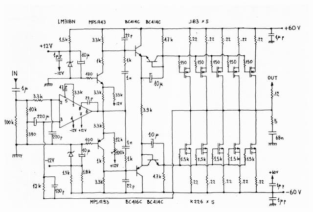

Hello AMV8
I'm a newbie from Hanoi, Vietnam.
Recently I bougth the P270-2 (Reference?) in attach photos. But unfortunably, I have the problem, not only the same as the problem of Nrick, but also even when switching it off with big 'beeeaaap' oscillation-thing below 1kHz and then some "DC-blaffer" for all of two channels.
Please help me to find out and indicate capacitor(s) and/or resistor(s) in these photo. I will ask to replace by some one in Hanoi
Thank you very much and hope to read from you soon!

I never really got rid of the problem. I tried increasing the 22pF cap and a lot of other things but it did'nt do anything. The only thing I didn't do wich might help, was to increase the two 10uF parallal to the zeners. So you might wanna try that.
Since yours is a MKII the schematic might be abit different, but change/increase the caps in the small-voltage-supply for the opamp.

I recently worked on my Carver amp which "Farts" on turn off-Carver uses front end opamps. Uneven collaps of 12 v supply was the cause of Fating noise. One of Zener was worn out and producing 11v. Replacing zener fixed most of problem but faint noise on one channel. At the end I replaced opamp on front end to cure the problem. Check your rails and 12v lines to see if they are collapsing at same speed at turn off.

The problem with the p270 that I wrote about, in the reference that you have attached, concerned the way that the voltage is dropped from the full rail voltage to a low voltage for the front end of the amplifier. This problem only existed in the original p270 and was taken care of by mf in the p270 mk2.
This is not connected with the problem that is discussed in this thread.
My guess would be that the problem mentioned in this thread is a faulty connection somewhere or more probably a defective electrolytic capacitor in the power supply or a decoupling electrolytic capacitor on the pcb, There is one 100uf - if I remember correctly - electrolytic capacitor decoupling each rail on both of the pcb's. These are located next to the input section of the pcb.
