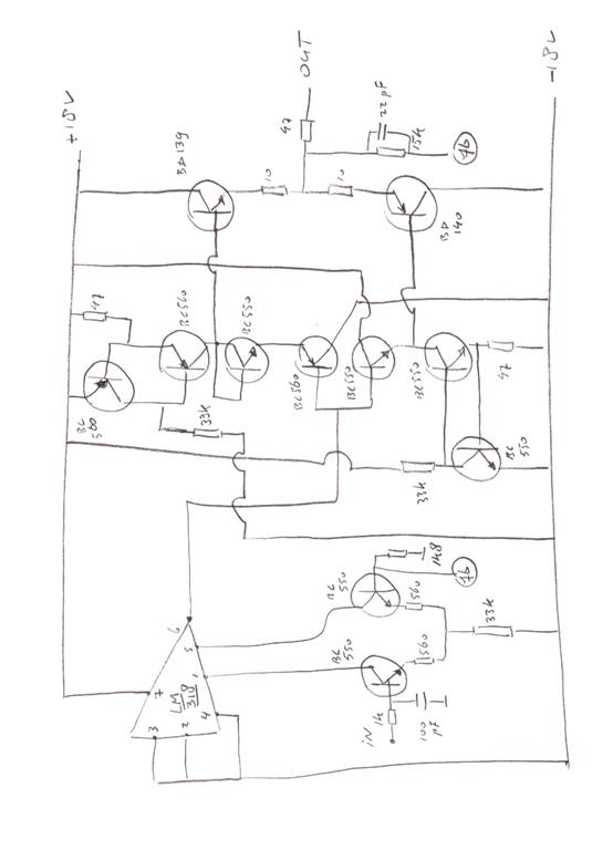

diode
Good question. I have simulated the circuit without the diode. The circuit (driver + output) then is symmetrical. This works too (according to the simulation) though with a smaller idle current (around 4 mA) but this can be 'solved' by changing the emittor resistors of the bd's,
So, I don't know why this diode has been added to be honest.

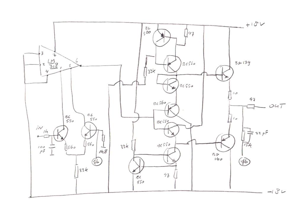

By combining the info on the LM318 and looking at the circuit of the preamp that is given in the thread on a phono-amp using the 5534 in a similar circuit, it is quite easy to fix the issue of using the 5534 in the Musical Fidelity MVT preamp line stage.
Here it is:
1. Take the 5534 and bend (up or out) away pins 1, 5 and 8.
2. Use an extra IC-socket and solder 2 small wires of short length to pins 1 and 5 of the IC-socket.
3. Put the 5534 in the extra socket.
4. Solder the wire that comes from socket/1 to 5534/8.
5. Solder the wire that comes from socket/5 to 5534/1
6. 5534/5 remains unused (can be cut away altogether)
7. Put the completed 5534+socket in the existing preamp-socket.
Ok, this can be done more neatly, but for testing it is not bad. For stereo off course this need be done twice.
I've tested this in the MVT and it works allright. Not that the sound is better, but changing/testing can begin now.

noise floor
I expected to get a better noise floor by using the 5534. But this is not the case.
Compared to the original MVT my diy-version has a somewhat higher level of background hiss (that keeps annoying me).
Some 'facts':
- MVT uses LM318 and 2x BC550 at the first stage. No hiss to mention.
- Power supply uses 7815/7915.
- I tested 4 different power supplies with my diy-version. 317/337, 7815/7915, passive with RC's, and another one. In all versions my hiss level remains higher than in the original.
- I tapped off the powerlines of the original to feed my diy version: same level of hiss, higher.
- So I think conclusion must be that it is not the power supply.
- Then I took the LM318 (+22pf+.22mF soldered on the pins) and put it in my diy version: same higher hiss as before.
- So the brand or type of LM318 can not be the source.
- I made a second copy of my diy-version, some variations in the layout, changed the brand of BC's and BD's: same result as first diy version.
- The original is MVT MKII, I see some parts that are not in the circuit of my MKIII circuit. Notably I see a 47nF cap and a resistor of 120 Ohm extra.
- I tried all kind of arrangements in the oscillation-department: decoupling the IC with 100nF and some smaller electrolytics. No effect on general background hiss.
I'm puzzled, what can explain the difference in background hiss? It is not the active components, it is not the power supply. Layout? Maybe, but I think not. So what's left?
Somebody got me an idea?

input filter maybe?
I'm wondering: I used at the input the filter 10k / 330pF instead of the original 1k / 100pF (because I hadn't a good quality 100pF in stock).
Could the higher R in series with the input be responsible for the higher noise floor (in the way you can hear the difference easily with your ears close to the speaker)?

some pictures
I made a small piece of veroboard to put 2 IC sockets and the LTP with BC550 (including the 33k LTP resistor). From there it goes to one IC-socket dual-type (for instance NE5532).
Now I am able to test my LM318 + external LTP on sound and noise quality in any standard preamp like a NAD. On the picture you see the 'adapted' NE5534 with some pins put aside and the pieces of wire.
When put in my standard NAD preamp (using 5532 in the line-stage, some feedback around it including tone-controls): LM318 or adapted NE5534 in this setting are problemfree and without noise. The LM318 can be got to oscillation though by twiddling with its position and/or the wires. The NE5534 just seems to play never minds its position etc.
So again: the IC + LTP can not be the source of the higher noise-floor.
it's the grounding stupid!
A rather long journey comes to an end. Problem of noise solved. Rerouting the ground of the power supply by just a few inches solved the problem. Lesson learned: i did know that grounding is crucial for hum, but now i know it also can cause hiss. The preamp is quiet now and plays as it should, comparable to the original one.
