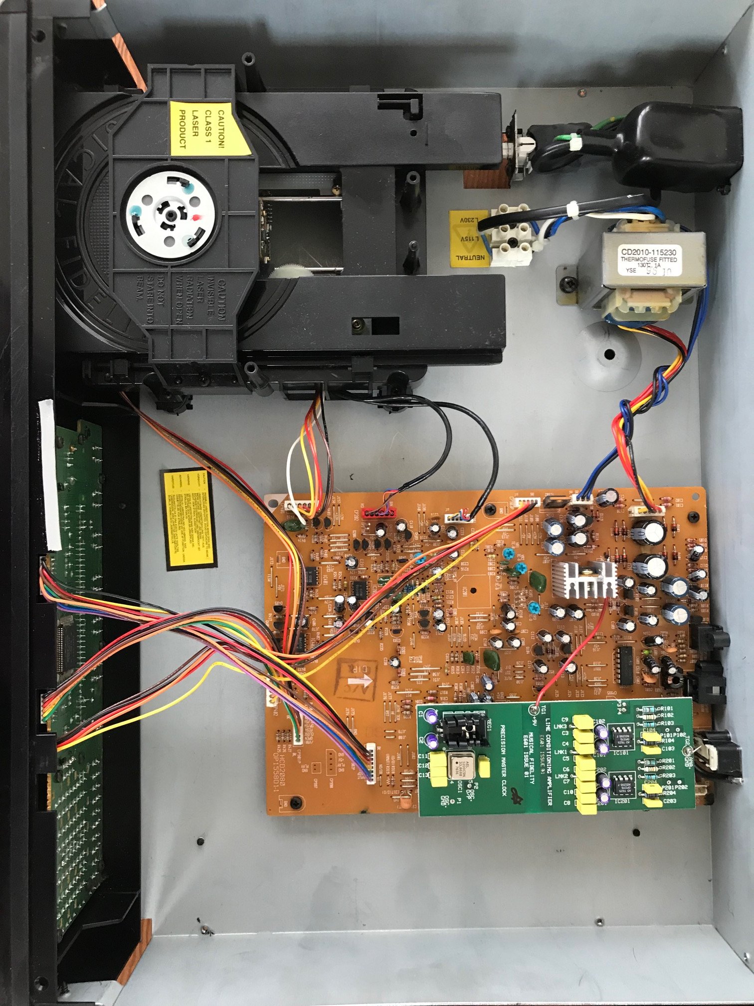

My CD player refused to start up yesterday. There is some noise as if something in the transport spins up, the display comes alive for 0.5-1sec or so then it goes off again and the cycle repeats.
Today I left it flashing on and off for some time and then it came alive. It plays discs and all seems to be fine.
All this happened when I opened it to inspect. Now it is hard to fix if it is not broken. Still I am pretty sure the issue will come back.

I can't reproduce the issue now. It was faulty yesterday and initially today. It came to life when I left it on for some time (probably 1min or so)
So yes now it spins up and works fine, plays music.
Maybe I need to turn it off for overnight to be able to see the issue again.

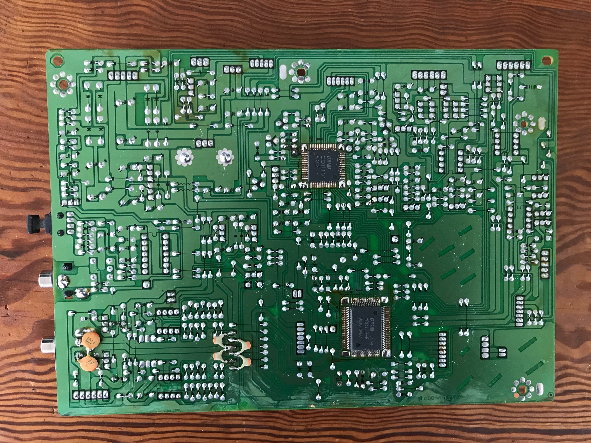

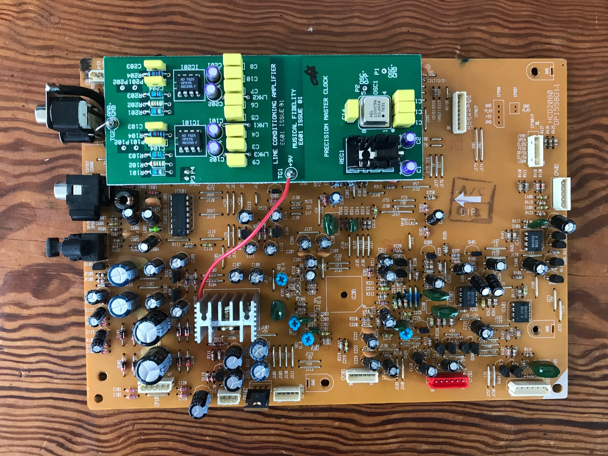

I have resoldered the areas around the regulators as you suggested.
I have also added a small heat sink to the regulator which had none.
It all works now and after resoldering I am actually pretty optimistic (I have "repaired" a few things just by resoldering) it will stay so.
I attach some pics for the posterity.
If anybody recognizes these board as something from, say, Sanyo please give a shout. That would be probably the only way to find the schematics for this thing.
Searches on the net reveal nothing (just the DAC chip and the transport). Musical Fidelity does not release these docs I was told by them. Surely they are afraid that somebody would clone late 90's player and they will lose their revenues.
