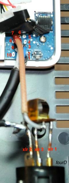

Hi Lucas,
You can indeed access the I2S signal on the AE. Basically you find it around the DAC.
On the french thread I started on Source de Passion a person has done it.
See the picture in this link:
http://clemmaster.free.fr/Airport_I2S.jpg

I have an AD1865 based DAC with only coax input - I have allready modified my DAC and currently route spdif signal from my CD-player directly to Digital-in on the DAC's CS8414 chip.
I plan to do the same as you have tried - routing the D-out from AE direct to DAC's digital in and keeping the distance short (5-10cm).
Is it not clear for me if I can just take the spdif signal directly from label 7# (see attached picture from CDFR french thread) and wire it directly to Digital-in on my DAC's CS8414 chip? Do I need any coupling cap/transformer/resistor in between the connections?
Sorry for asking newbie question but hope you can help me out on this - thanks
Søren
