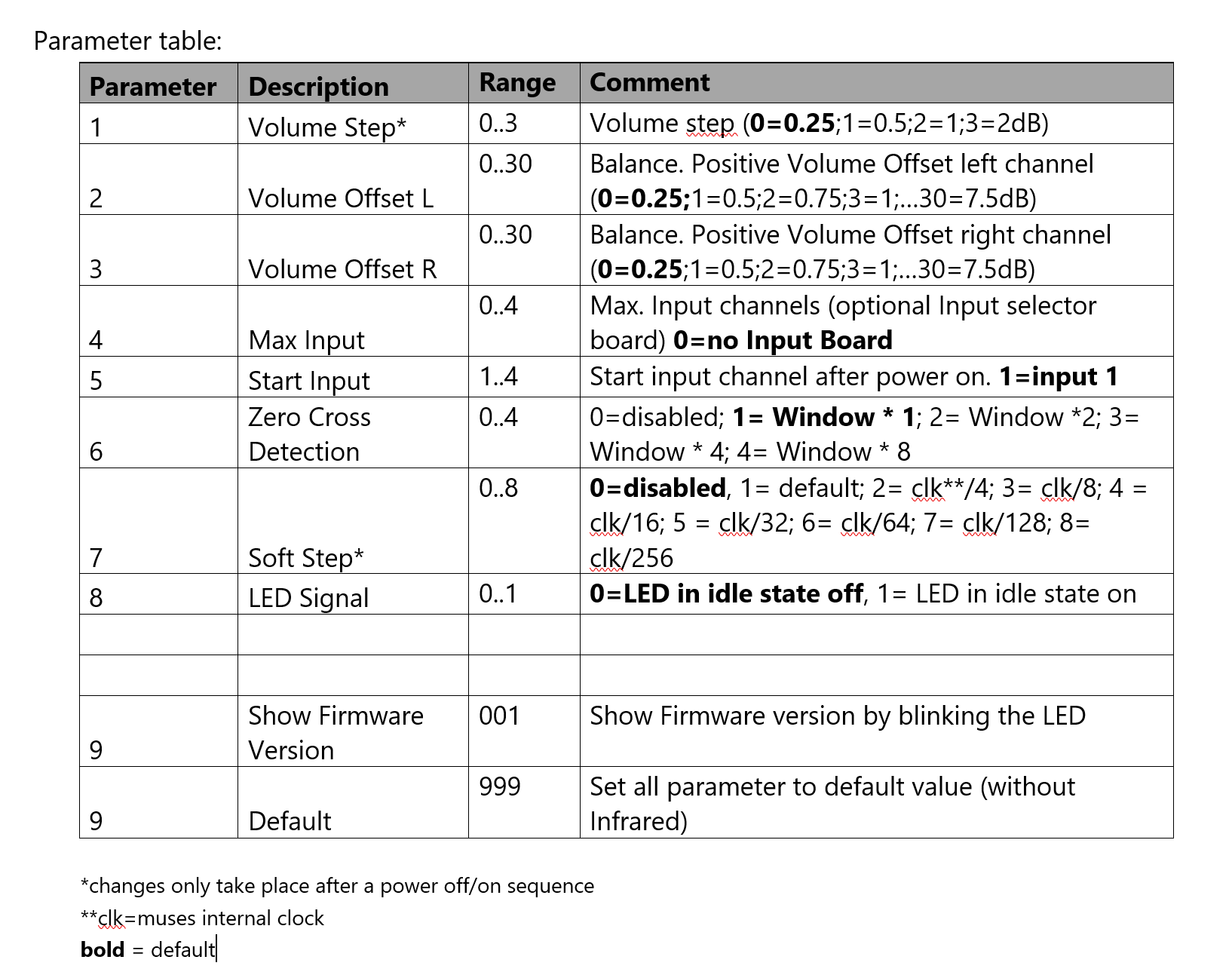

Finished Parameter implementation.
Documentation snippet:
Optional parameters can be set by pressing the infrared remote key “0” three times within 2 seconds to go into parameter mode. This is acknowledged by 3-time blinking of the LED.
To set a parameter, the parameter ID must first be selected from the table below. The parameter value is entered in 3 digits. The parameters are then permanently stored in the flash of the microcontroller. This is acknowledged by 4-time blinking of the LED.
Cancellation is possible at any time by pressing the rotary-encoder button continuously for 3 seconds, this is confirmed by the LED flashing 5 times.
To set all parameters to default values, use parameter id “9” and value “999”.
Example: Set “Volume Offset L” to 12
1. Press key “0” three times
2. Press key “2” (Volume Offset L)
3. Press key “0”
4. Press key “1”
5. Press key “2”

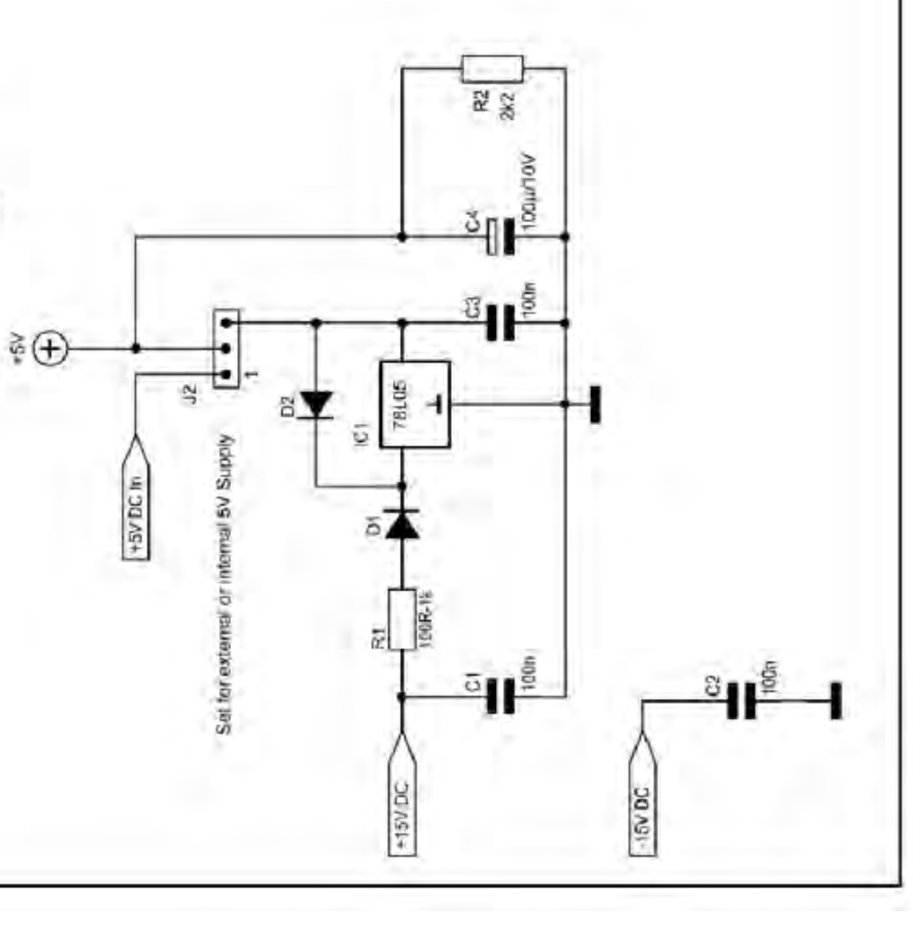

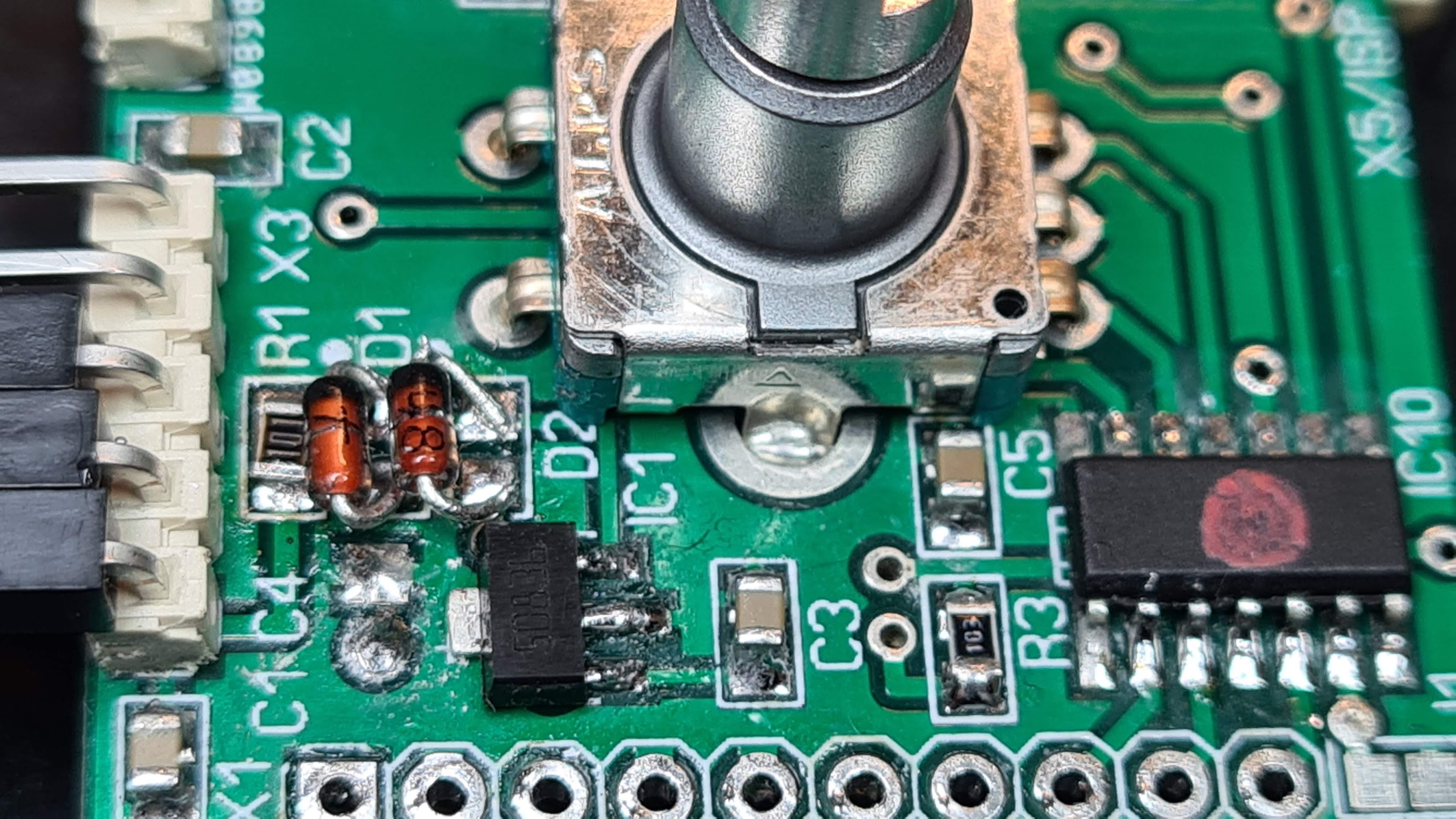

Hi, still trying. Found a decent PSU and doing some initial tests.
approx +-14Vdc in. However R1=100ohm on the controller board get extremely hot. (actually so hot the solder smelted) Also the 5v LDO gets hot. https://no.mouser.com/ProductDetail...f//tDZEZckA==&countrycode=NO¤cycode=NOK
I do not get 5V out of it. (0.7V) Approx 1.2V enter the LDO.
D1 and D2 are https://no.mouser.com/ProductDetail...8aNy7/u4kVw==&countrycode=NO¤cycode=NOK
Been tracing "everything" according to schematics. Unable to find what is wrong. Dont think I have reversed D1 and D2...

Do you mean that you measure 1.2v at the regulator input?Hi, still trying. Found a decent PSU and doing some initial tests.

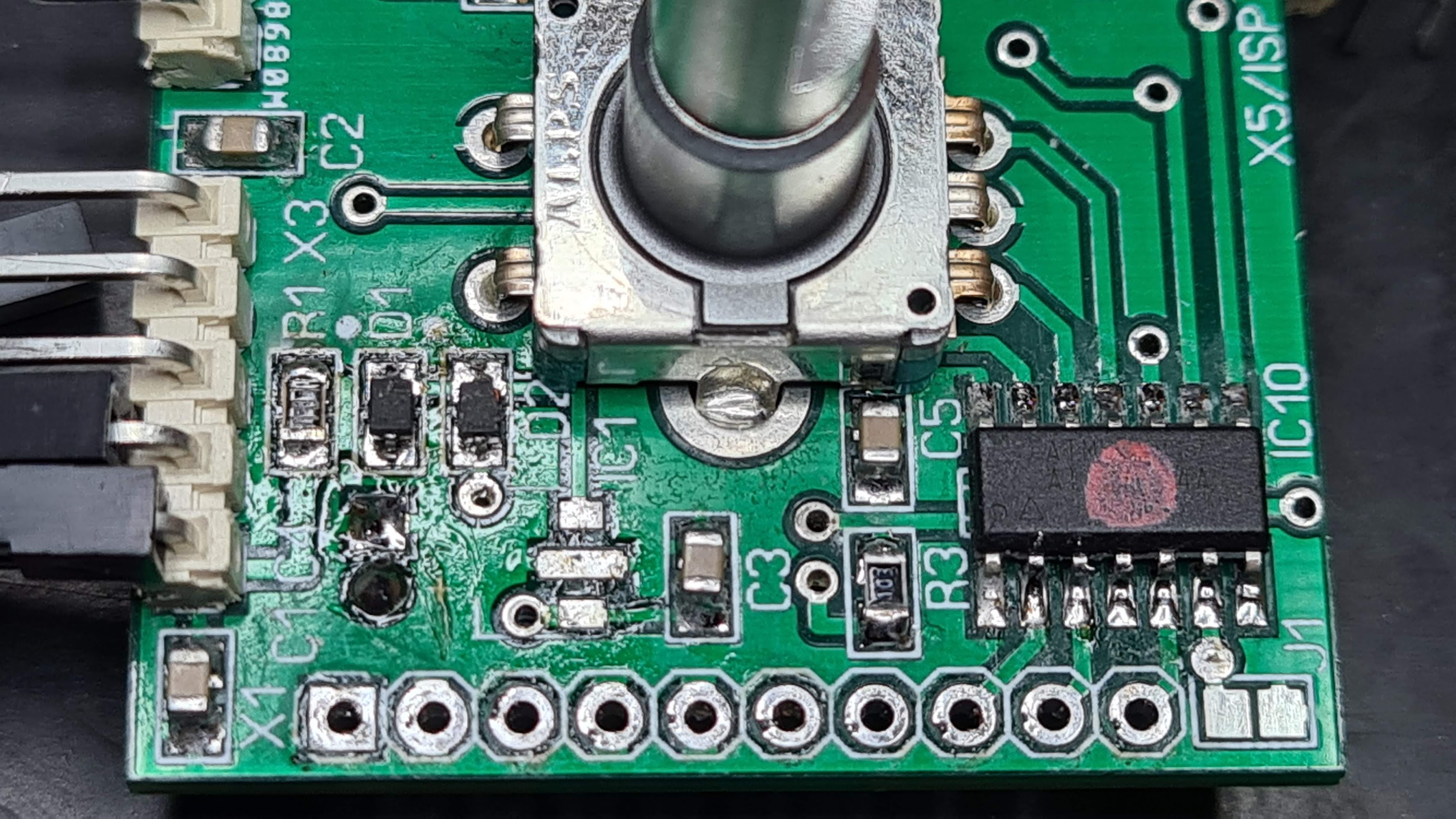

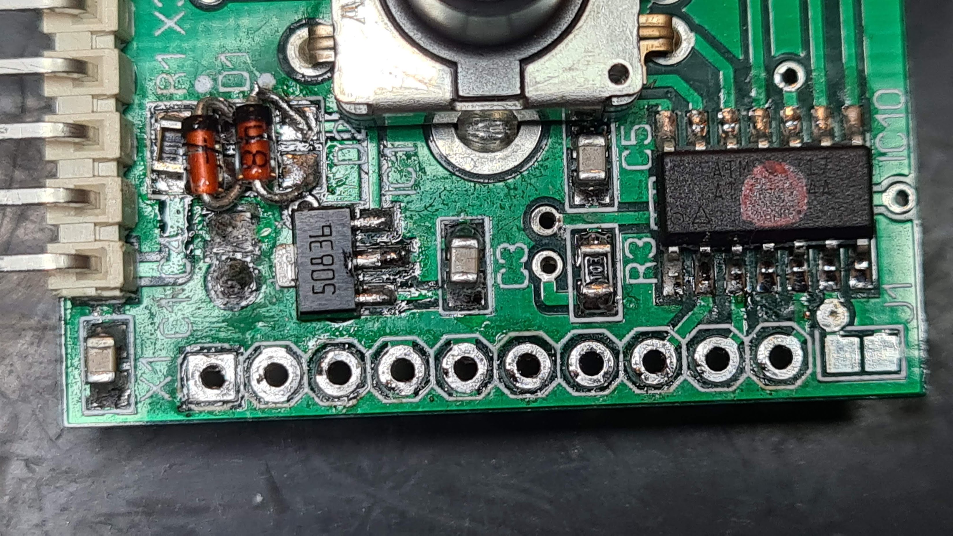

Diodes are ok. Changed just to be sure, but did not have any smd of those left. Unable to find any short unfortunately.
Tracing the schematics but no luck.
I am sure it is "up in the day" but out of luck here.
Crap magnified pictures do nok look nice soldering/desoldering smd components
That R1=100r seems to be taking a beating.

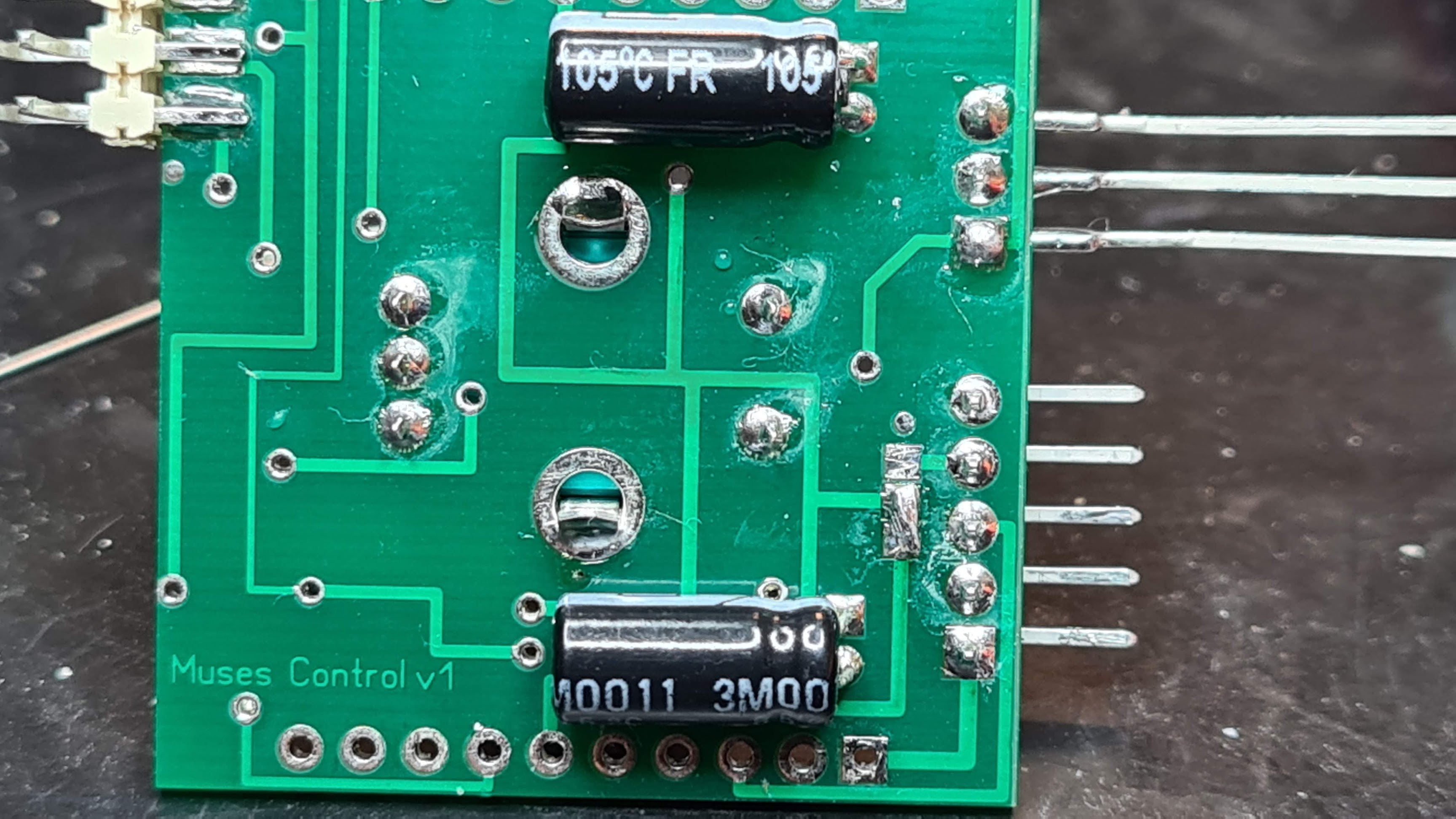

J2 (under the board) is connected between pin 2 and 3, just as according to the manual
