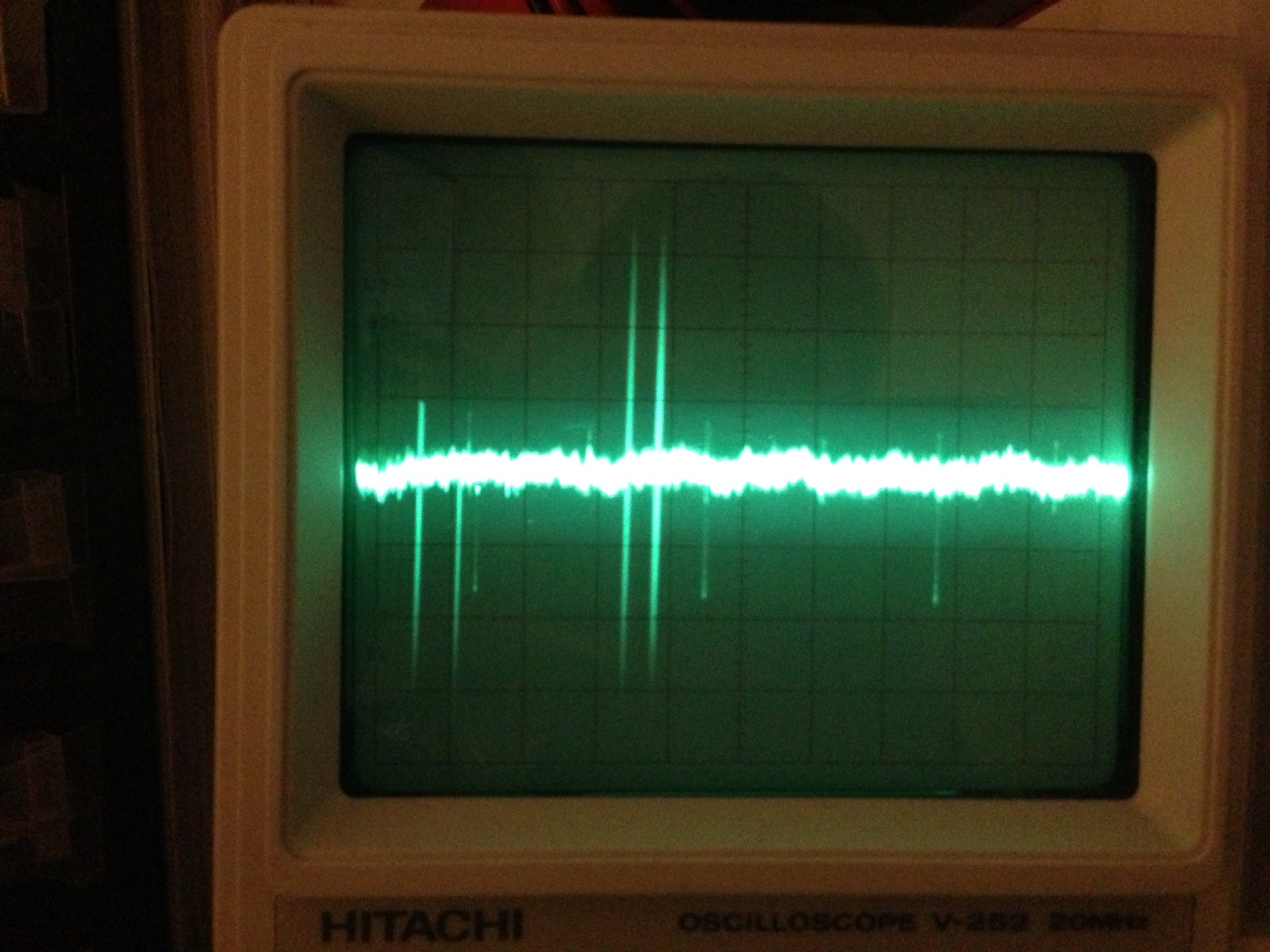

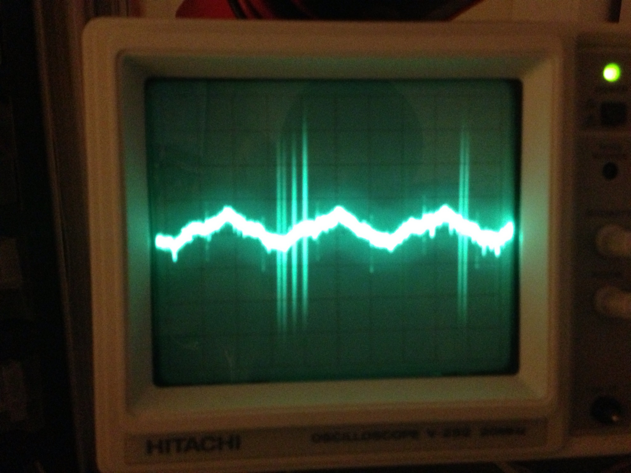

Here are the outputs from the AMP with the Speakers Connected.
Right channel has more noise.
Scope settings:
Voltage/Div: 5mV
Time/Div: 5mS
1st Pic: Right Channel
2nd Pic: Left Channel
So looks like the right channel has more noise than the left. There also seems to be a bit of a DC offset since it looks like the noise/wave is oscillating between +4mV and -3mV....

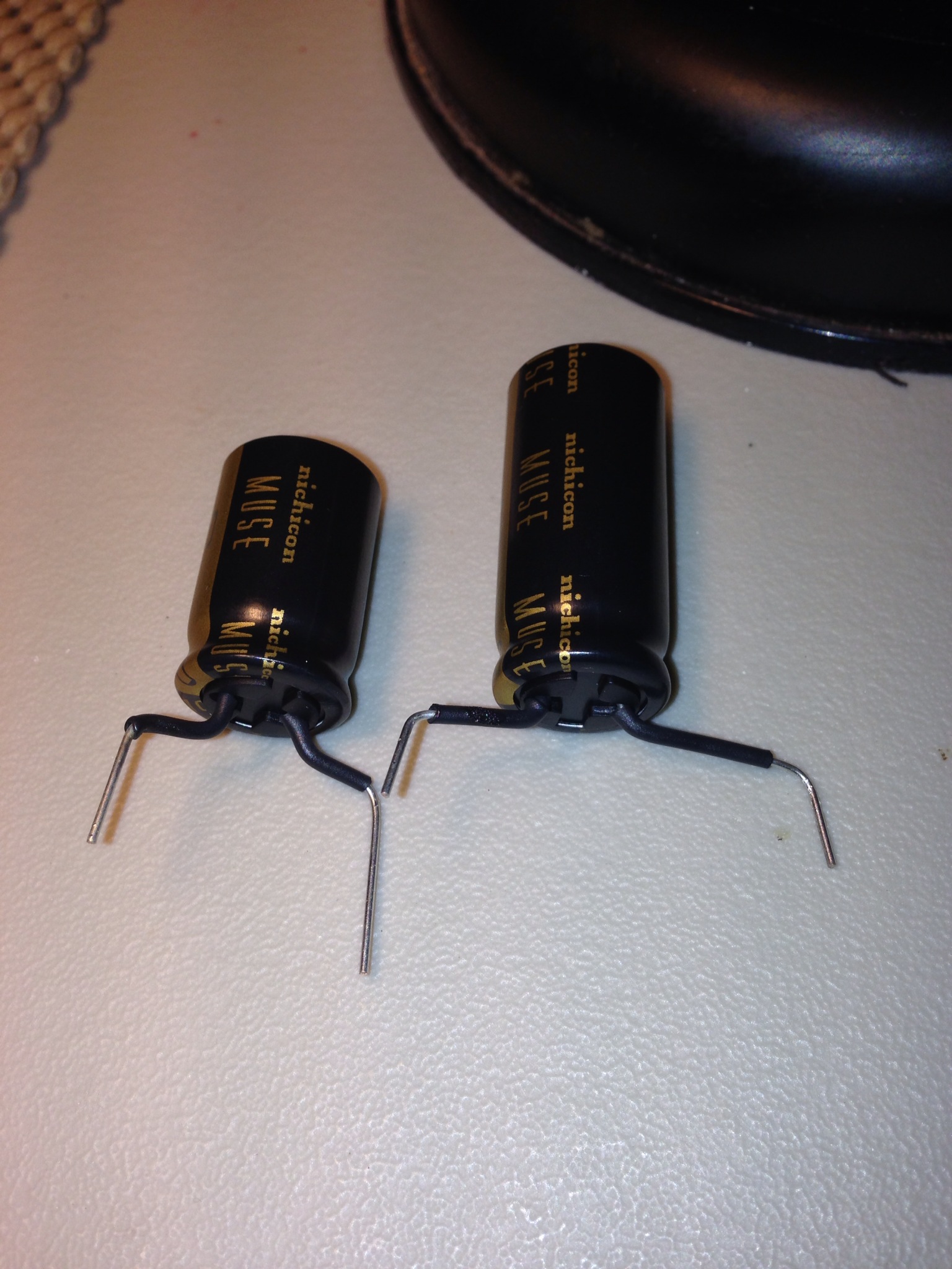

I have replaced all of the electrolytic capacitors on the Driver Boards, four on each board. I think there are two small ceramic or film caps and two bigger "Crossover Type" capacitors that I haven't touched and i dont think they need replacing.

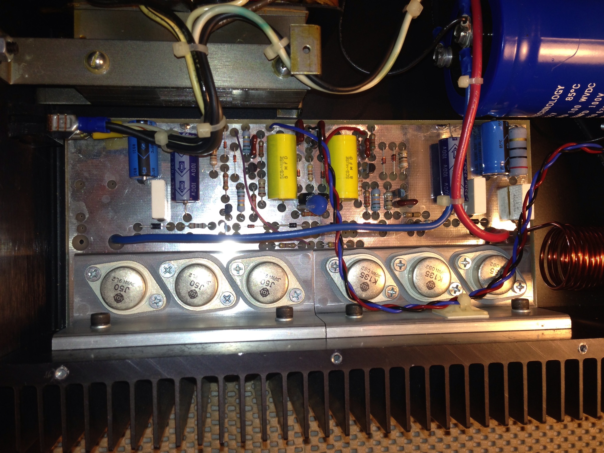

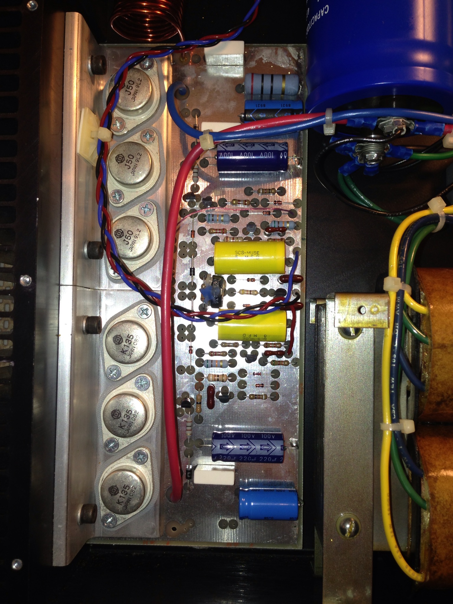

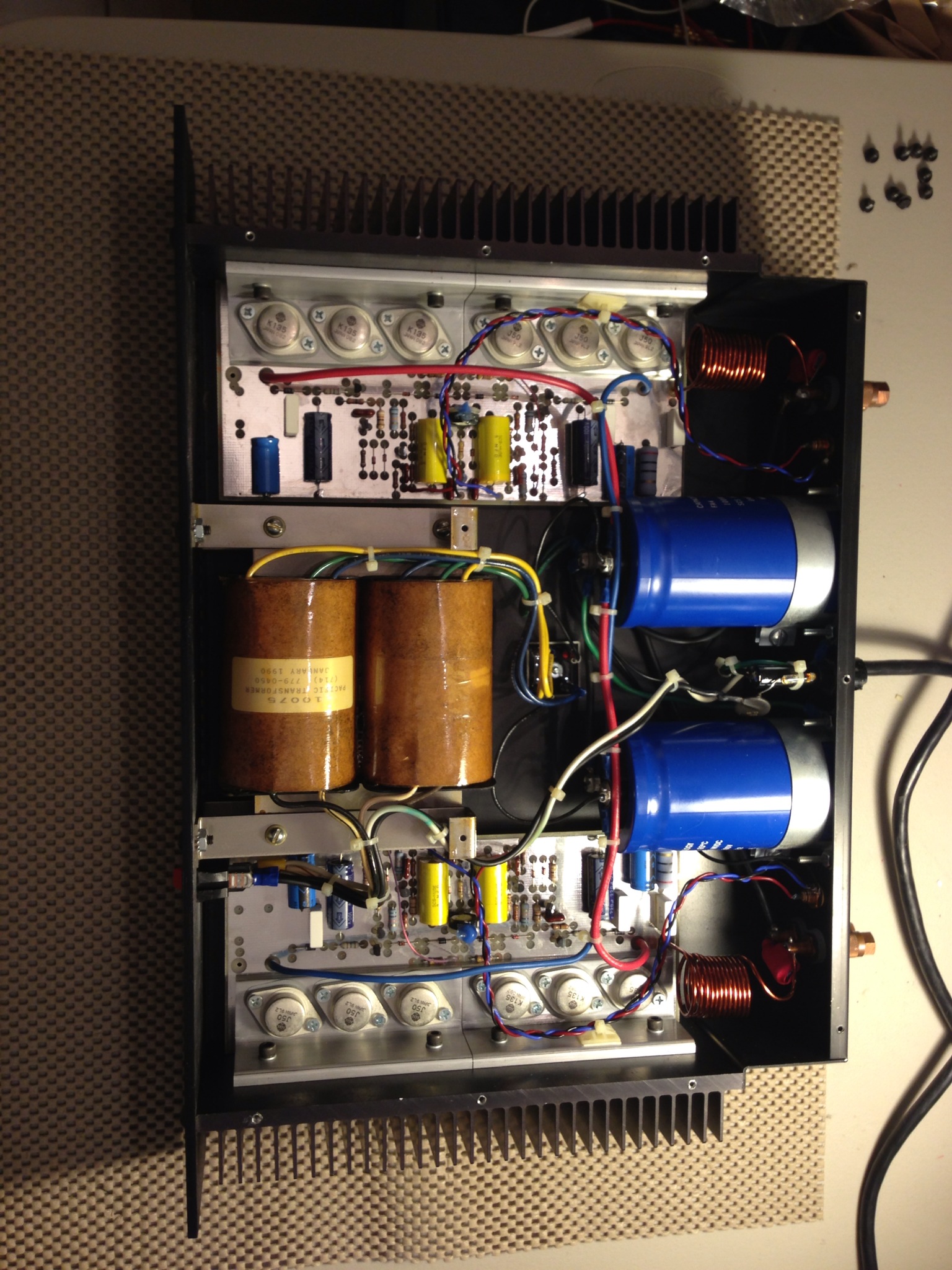

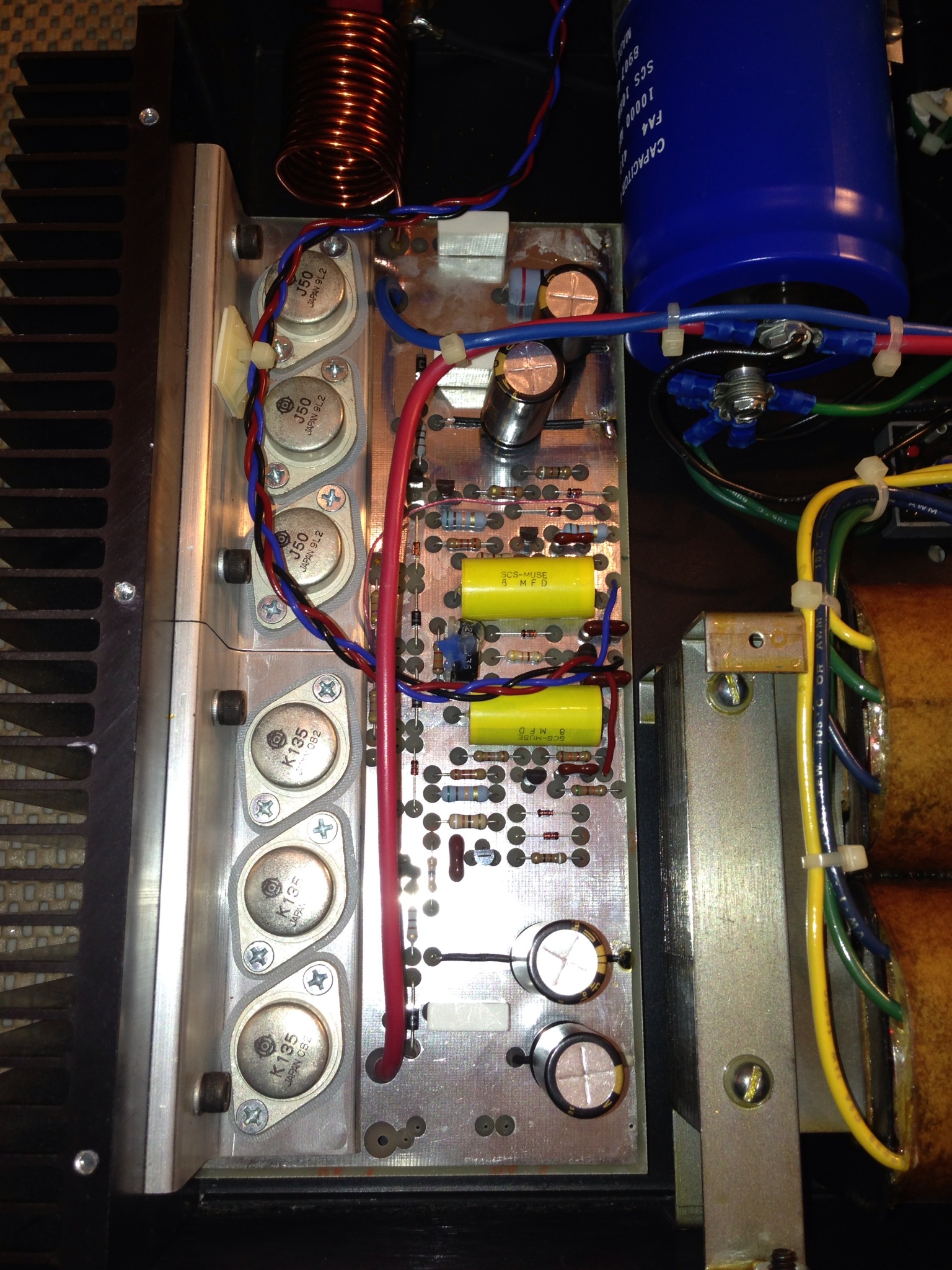

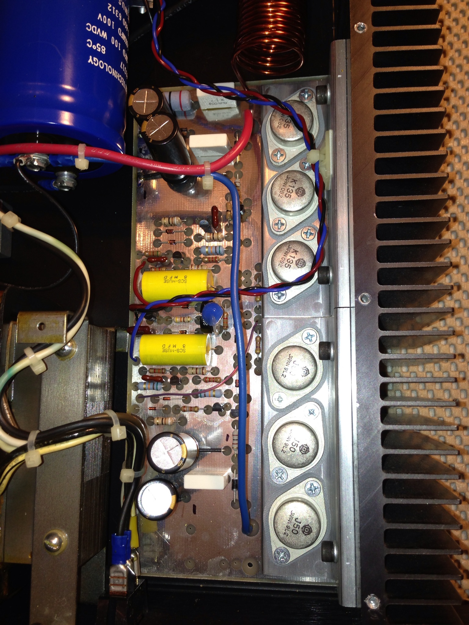

I have included a pic of the amp. You can see the 3+3 Hitachi K135 and J50's per channel. If I replace any of those guys, correct?
Also how I would I go about figuring out the correct bias and where would I mesure it without the schematic?

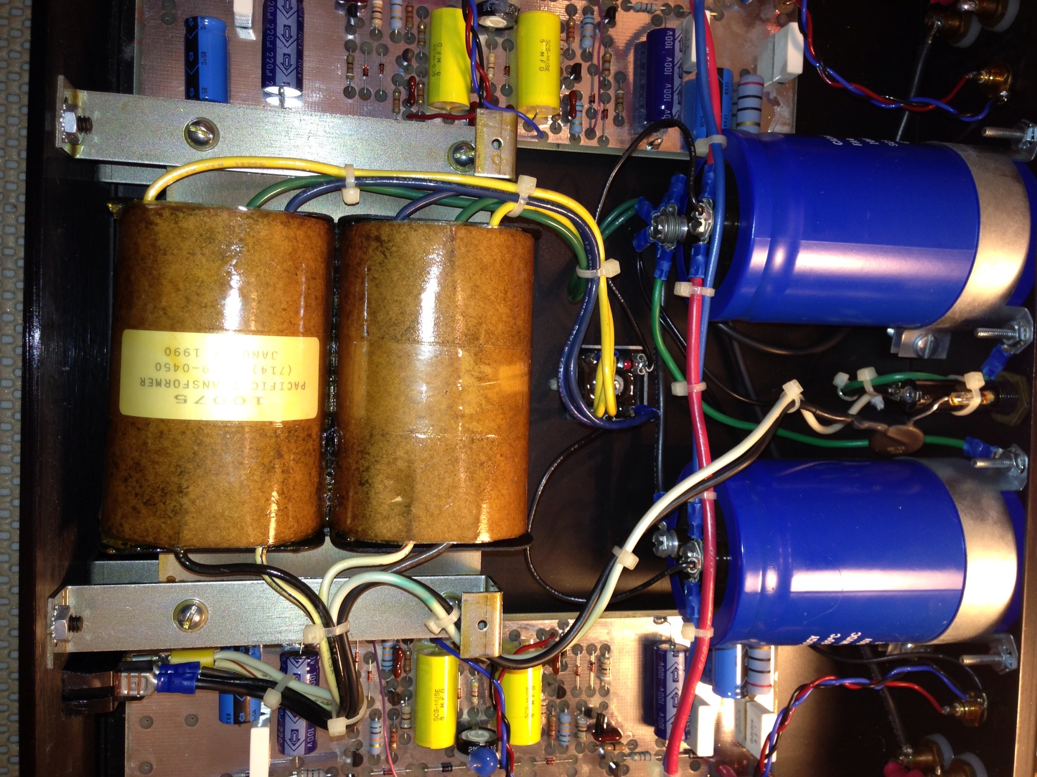

I stripped the unit a couple of weeks back and remounted the psu transformer, they had it mounted with crappy tissue paper thin open cell foam. This had worn through and the transformers was simply vibrating against the metal case. Mounting it with 2mm soft silicon rubber sheeting has damped out a lot of this vibration and hugely reduced the physical noise.

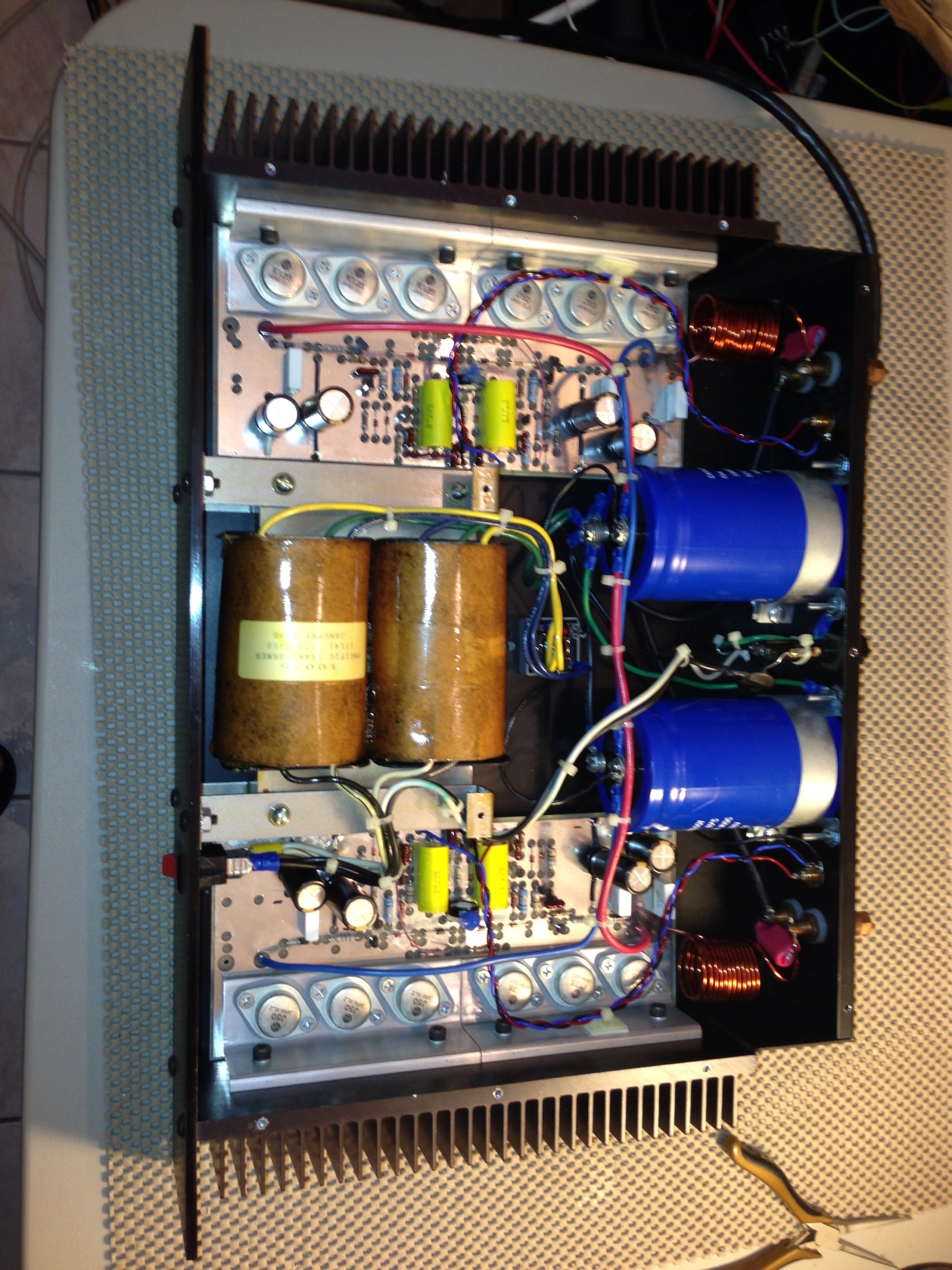

here are some pics of the amp.

I'm just about to rewire my amp to create a new 0v point between all the PSU caps and then send that back to gnd via a new star earth arrangement. The PSU is basically floating in these amps and there has to be some mileage in tying 0v to gnd.
I'll borrow a scope today and make some shots.

It is true, I did find that interesting (I am not very experienced with AMPS). From memory, the BLUE (negative) and RED(Positive) PSU wires connect to the boards and there is no GND tied to it coming from the PSU or connected to the STAR that is located on the RED PSU Cap. The only GND connection from the boards is to the RCA connector I believe.
I did disconnect and reconnet all the contacts with no change.
Any help woul be appreciated. Also learning how to set that Bias pot will be of great help.
I'm in on this - just picked up a model three / model 100 combo and while it sounds good I'm having this issue as well.
Another data point that might help - it's really bad using RCA connections to the amp, much better using the balanced. And my phono pre-amp is acting like the ground (from table to phone pre) isn't hooked up at all. Lots of hum.
Seems to me like this supports the bad ground theory. I'm not an electrical genius, but I can find my way around a circuit. Let me know if there is anything I might be able to add that can help.

Let see if we can figure this out. I try to lift the earth ground and see if that helps a little but it is unlikely it will help much. When I plug in an open ended RCA cable the speakers start to humm and buzz pretty loudly... maybe there is some ground connection somewhere on the RCA contacts? I might try removing them but I dont know.
Another person on an AudioKarma forum had replaced pretty much everything (mosfets, transistors, caps, etc.) and he says that his Model One Hundred is dead quiet now.
OK so I looked up what other have identified as replacement to the K135 and J50 MOSFETS TO-3
People recommend:
BUZ900 & BUZ905 as the exact replacements t $10 each ;( for $120 total from Newark
or
BUZ901 & BUZ906 as alternative replacements at $8 each for $96 total from Newark
I also found the BUZ900 & BUZ905 on eBay from a Chinese seller for $5 each
BUZ900 Manu IR Encapsulation TO 3 N Channel Power Mosfet | eBay
BUZ905 Manu IR Encapsulation TO 3 NEW Product Under Development | eBay
The parts from China will cost me about $70 with shipping but will take forever to come and I am not sure if they are legit :/
I compared the specs on the BUZ900 vs BUZ901 and the BUZ905 vs BUZ906 and the BUZ900 and the only difference is the Vds respectively being 160V,-160V and 200V,-200V. The Hitachi MOSFETs are rated at Vds 160V and -160V.
For me it is a clear choise to go with the cheaper and better Vds MOSFET set of BUZ901, BUZ906. What do you guys think? Is it going to screw things up? Anyone A
Can anyone advise on the BUZ MOSFETS?
BUZ901 & BUZ906 vs BUZ900 & BUZ905?
I haven't really had time to mess with it. I did fix my phono preamp - that was just a loose cable, I guess moving everything around knocked it loose or something.
I lifted the amp ground too - same results.
I also tried shorting plugs on the RCA inputs on the amp - it makes it really quiet, also no sound at all, apparently they override the balanced inputs. I suspect that it's just an incredibly noisy transformer.
I'm super busy right now, so I don't really have time to mess with it - hopefully things at work will slow down in a few weeks.
