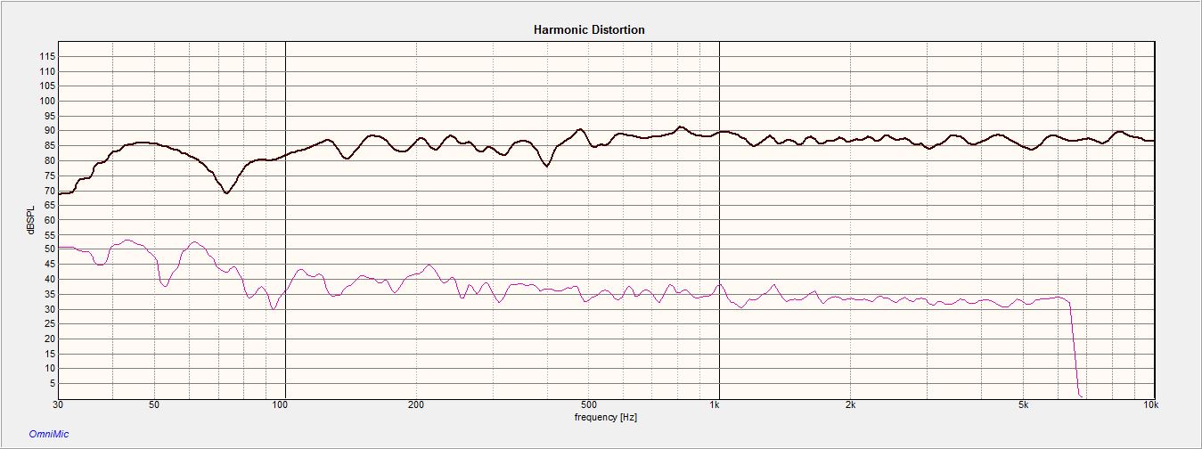

Wow, very interesting stuff. Couple of questions. In the level/distortion plot I couldn't quite see what the distortion scale was. Second, I read a lot of technical discussions in the thread, but could you tell me how it sounds relative to others? I'm afraid I don't spend a lot of time listening to tweeters by themselves, but how would you compare it say to a traditional ribbon, or something from Focal or Seas? Thank you in advance.

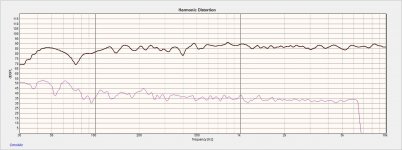

Erik
The 3rd HD is nominally at the 35 dB level and the fundamental signal is at the 85 dB level. Thus, the 3hd is 50 dB down which equates to less than 1/2% distortion.
How does it sound? Wonderful. Your expectations and mine can't be the same, nor is our hearing. So, I can't really answer that question.
Wow, that's really good.

True, so I think that between different listeners relative differences have less variation than absolute terms, so if a revierwer said "smother than a Focal, but with less extreme high frequency" I would have understood. Whether or not either of us thought that was a plus is another story. :) Maybe I'm wrong and even relative differences can't transfer well, but it's all i have got. :)
Thanks for posting all your lab work though. That's great. I didn't realize AMT's had such low distortion overall.
