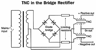

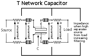

It's a pity Denis Morecroft does not build valve amps, otherwise we might have some high voltage versions of his 'T-network' capacitor. These are designed to solve problems like Wavebourn's, where the same capacitor connects to the rectifier AND the amplifier load.
The drawings tell the tale. In the T-network cap, the rectifier sees one set of parasitic L and R, the load sees another. Thus, you largely avoid voltage intermodulation between source and load.
For an 800V power supply, and 235uF, the rectifier peak current is ~600mA when 100mA dc is drawn. The reverse recovery pulses will be a least as large, but their spectrum will extend well into VHF. I suspect that investigating the sonic consequences of this intermodulation - e.g. by using 2 similar capacitors, and putting a choke between them, would prove interesting.
DNM Products - T-Network Capacitors, full details
