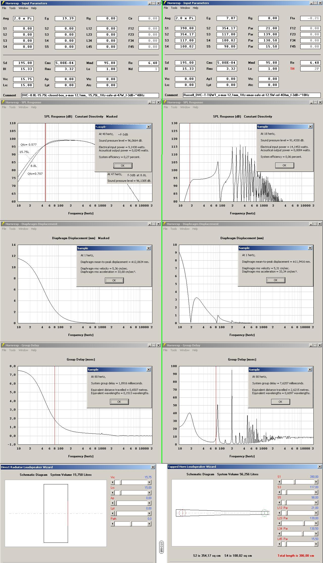

Hi Russel,
The TS you have submitted is for the coils in series and is IMO preferred.
I would put 4 of these drivers in a box of ~net volume of 35 L if the speaker are placed away from walls or if are to be used in a car.
If close to wall(s) I suggest a volume of 60L or more.
If you are aiming at a sub system for HT (music only too) I would design a dual driver ~56L T-TQWT and two closed boxes (~16L/box) using your 4 drivers.
b:)
