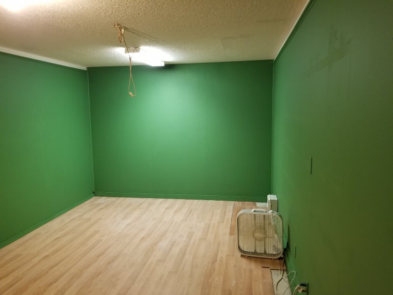

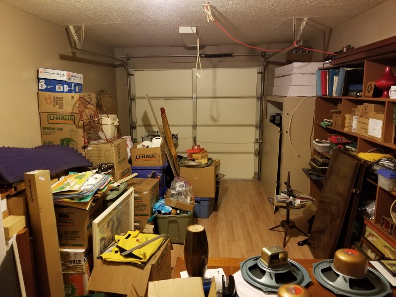

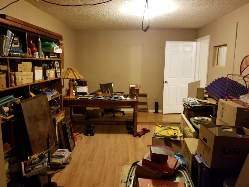

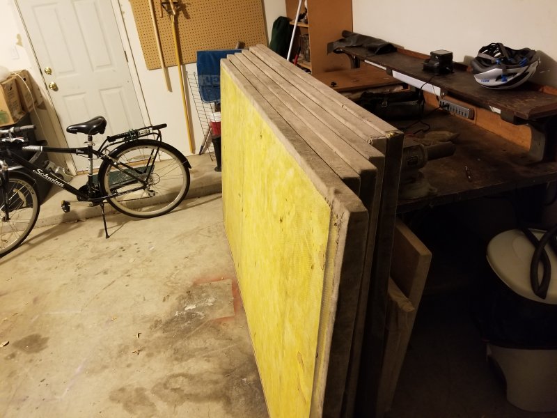

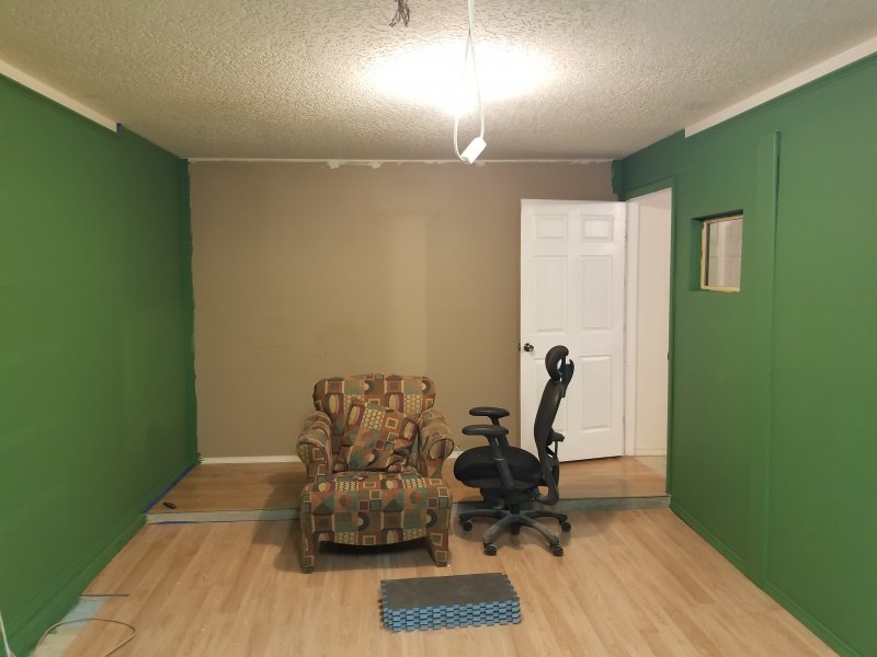

Hi Guys, it's me, the original poster. Since I started this thread we moved twice and the second time was from Michigan to Albuquerque New Mexico two years ago. We bought a house with a three car garage. we used the third stall for storage as it was walled off when we bought the place.
4 months ago I decided to turn that stall into my listening space so I emptied the room, screwed the garage door to the wall and removed the garage door rails. I built a false wall and insulated it and dry walled it.
Then I painted the room except the back wall because I was going to put my LP shelf there and surround it will bass traps.
After looking at the back wall I decided to move the door as it was right where a good bass trap could go.
So I asked, in the first post, where I should use bass traps for multiple subs and after reading all these good threads I decided to do both.
I now have 4 subs and super chuck traps for the front corners and the back corners.
I hope to finish up the room this weekend and start moving my system in.
Thanks for all the great discussion and advice.
Dennis.

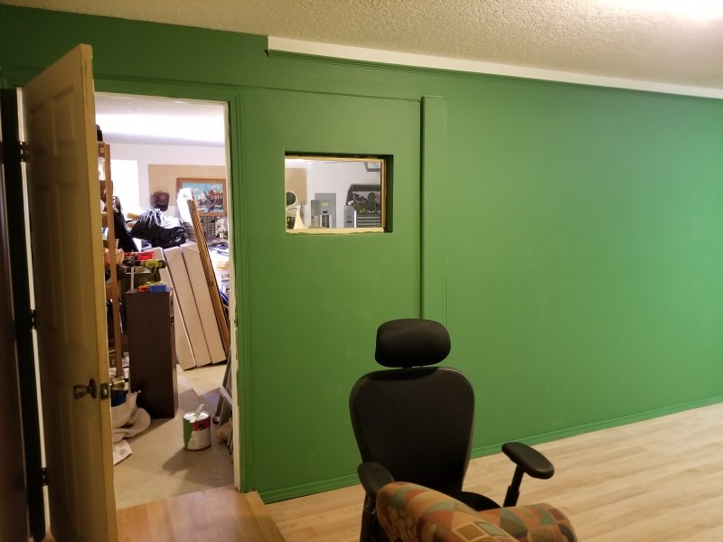

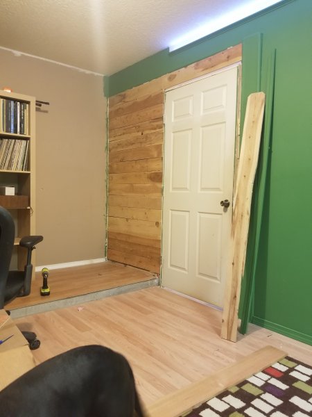

Thanks for the link Bradley. Here is the back of the room
I moved the door so I can put bass traps in both corners. I am building doors for the record shelf made of QRD diffusers so the room won't be real dead and I am only putting absorbers at the first reflection point.

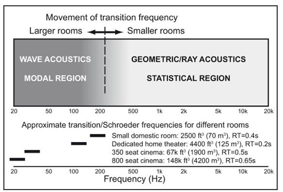

Low frequency wavelengths are very long and our brains are very slow so low frequencies bounce around the room several times before we hear them. Consequently, first reflection points are only relevant to frequencies above the transition region.
Bass treatment is always good, but only if you do good bass treatment. That's the tricky part. If you do bad bass treatment you harm your highs without getting benefit in your lows. Good bass treatment means the wall structure itself is the treatment. You have to rip walls and ceilings down to do it.

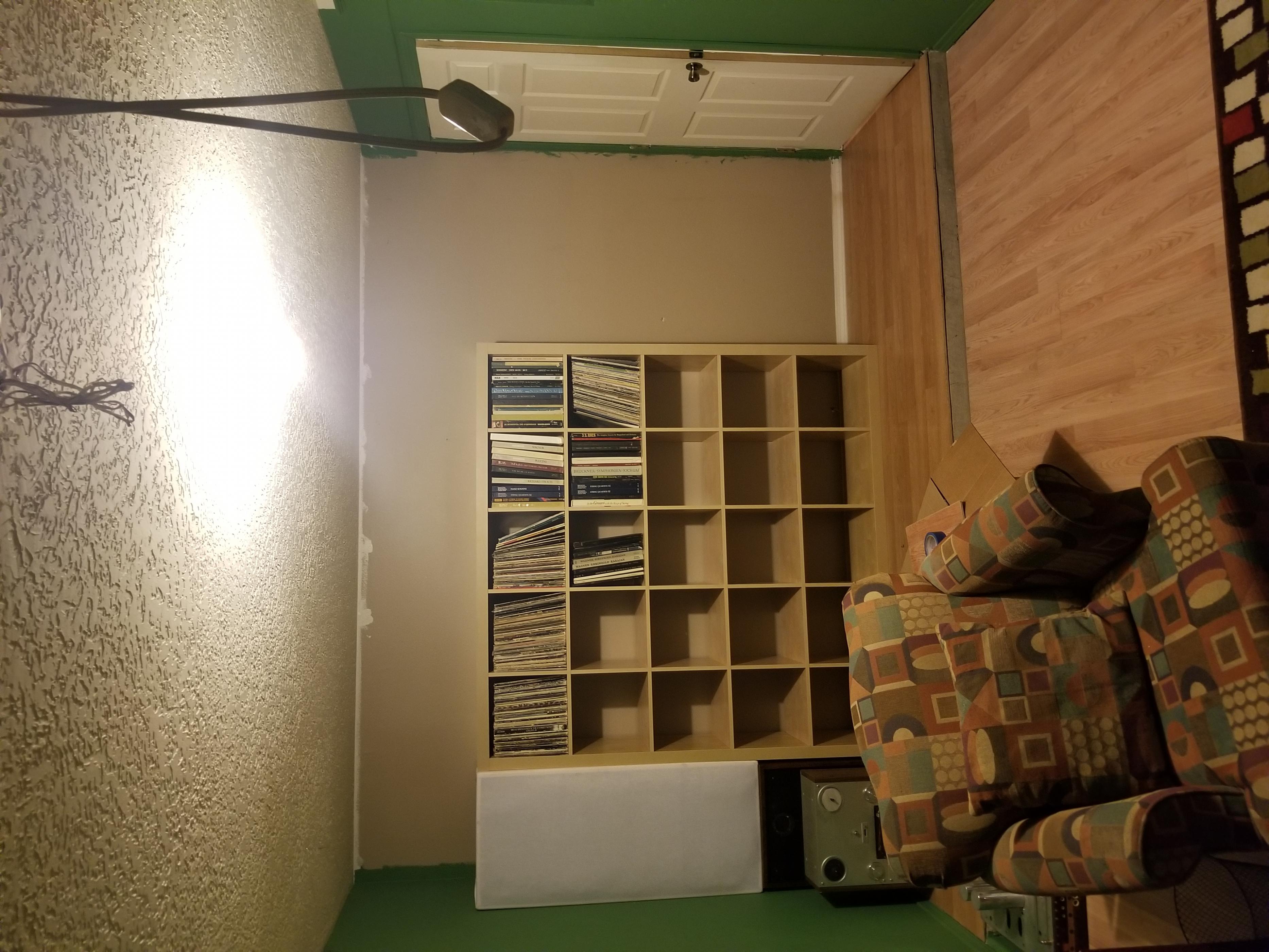

The first reflection point I'm doing is only for the highs. It was just a mention. I have two subs in the front corners with superchuck bass traps on top of them up to the ceiling. In the back of the room I have two subs in the up against the back wall and a foot in from the side wall. those are sided by 8" thick bass traps that go up to the ceiling and across the top of the record shelf. There is about 6" of space behind them.
I only have one seat in the room but as an old bass player, 4 subs is what I wanted to ensure good low end response with the added benefit of leveling the signal around the room.
