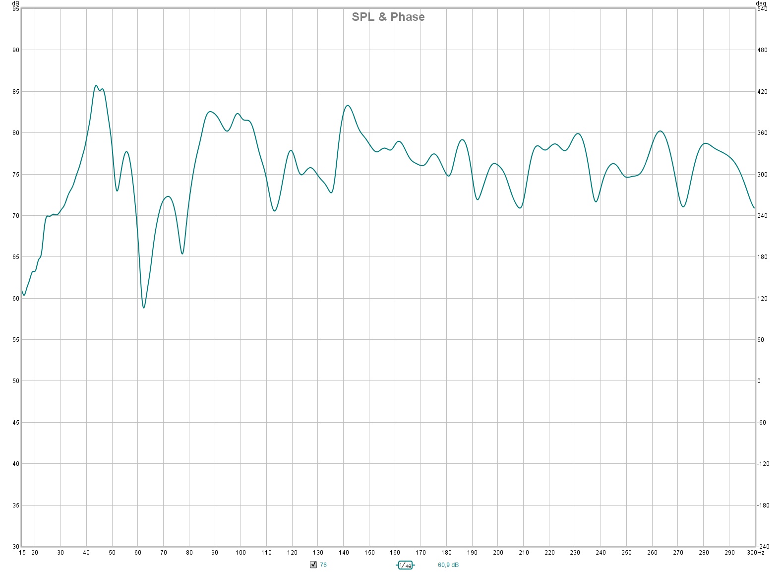

It took me about 4 hours once I had the measurement system setup (that takes a lot of time.) I measure each sub and the mains and use EQ to smooth each independently. I was doing this in real time looking at the traces. Then I sum them up. I try flipping phases to get to the smoothest response without a lot of deep holes. Then I try to correct the sum with overall EQ (all sources.) If this doesn't get me where I want I might go back and tweak each individual sub.
By switching phases you mean changing it from 0 to 180?
Since I can't EQ all sources at once I'll have to set the same EQ settings at all subs and if that won't do I can tweak each sub individually.
Here is my ugly stereo response. A starting point. I'm not positive but you guys gave me some good guidance.

What do you think of the response I shown? Solvable with three or more subs?
It's typical.
"Solvable" - not sure what that means here. I can guarantee that with more subs - more degrees of freedom - the situation can be improved.
