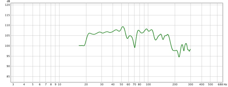

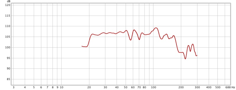

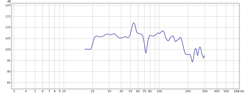

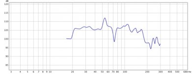

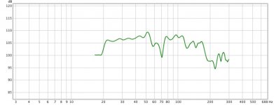

So I have a smallish music room and at the far end is a wide clothes closet* with sliding doors (which can be slid over half the opening... for those who are geometry challenged). Below we have results for a mic at my listening chair withe door(s) slid to the left, right, and middle. 5 dB/line
Even displayed this way, pretty dramatic differences.
Actually, my real point is that moving subs around, adjusting what can be adjusted, and measuring the results (and then EQing) is the way to go.
BTW, since the waves are bouncing around the room, adding stuffing in any odd place (like attached to the underside of a table or behind a couch) can be helpful.
Ben
Ummm, plus or minus 2.5 dB from 19 Hz to crossover.... not bad, eh (as long as I remember to keep the closet open on the left side)
