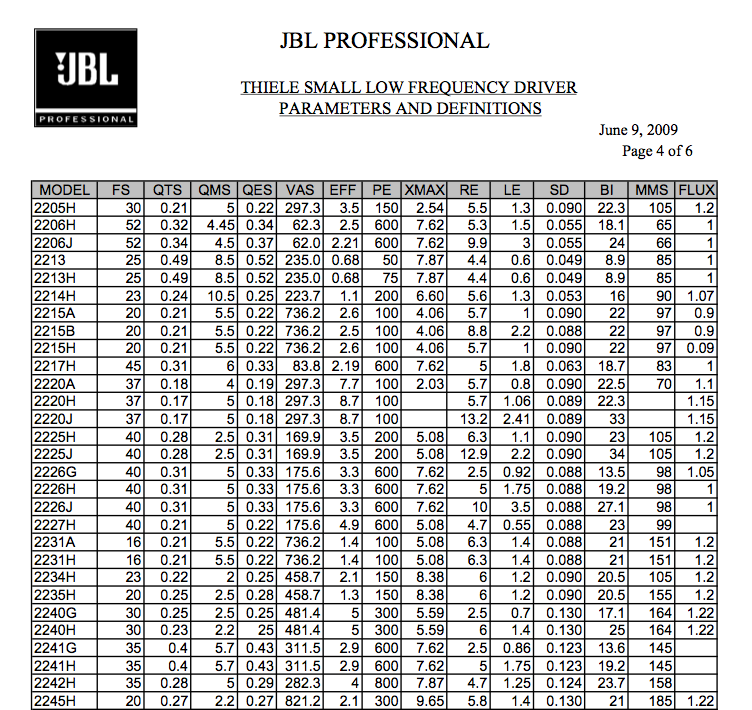

A bit off-topic, but how does the JBL 2242H compare to the B&C 18SW115? The 2242H had higher sensitivity and require less power. But also needs a bigger cabinet to reach same lows. Anything else?Thermal modulation is not always proportional to the inverse square of the efficiency.
In testing a pair of Lab 12" compared to a BC 18SW115-4 (18 inch) in a tapped horn, the Lab 12" were almost 3 dB more efficient, but the 18SW115 was able to dissipate the heat from the voice coil much better, so it had much better ultimate dynamic range.
At high power, the 3 dB advantage the Lab 12"s had succumbed to thermal compression, and the 18SW115 was able to put out more SPL, showing virtually no thermal change from one watt to 1500 watts of sine wave, double the AES rating.
The pair of Lab 12"s, each getting about 400 watts sine wave, were quite hot to the touch, while the 18SW115 barely rose over the ambient temperature with 1500 watts.
Had I not done the high power tests, I would have concluded the B&C was overpriced compared to the Lab 12".
Having done the tests, I consider the 18SW115 a bargain, at least it was before the price of Neodymium went through the roof. Fortunately, B&C has come up with the ceramic magnet 18TBW100, nearly the equivalent of the 18SW115, kind of like a giant big brother to the 12TBX100 you are using.
Art
The JBL 2242H has only 7.87mm Xmax compared to the BC18SW115's 15mm Xmax, and 800 watt power handling compared to 1500.A bit off-topic, but how does the JBL 2242H compare to the B&C 18SW115? The 2242H had higher sensitivity and require less power. But also needs a bigger cabinet to reach same lows. Anything else?
That means you would need almost two 2242H to equal the output of one BC18SW115.
Of course, if you subscribe to the multiple location sub approach, and don't need 122-128 dB output per sub, both these drivers are overkill.
It's definitely true that the specs favor ,b&c, and I can personally say that the 12" and the 21" in the TBX line are beasts sounding great even at high spl so I'm sure the 18 neo version is too. However, I have worked with the 2241H(G) for about 9 years and I love it(read: slightly biased). It has been the most reliable subwoofer driver for me. I've only messed around with the 2242 but it has the same motor structure but with 9mm of xmax compared to the 7.6 of the 2241(though Art may be citing his direct measurement not the spec sheet.). My experience, and the numerous papers I like that JBL has put out, has led me to believe that JBL often understates its it's power handling.
Less than a year ago I drove some sr4719xs with dual 2241s(reconed) with over 2000w each to the point where I heard the vc former touching(euphemism) the back plate. Naturally practically toppled the entire crowd of people on my way to adjust, but held it at just a bit inside what we can call xlim. This was probably right around 2000w. Amazed at the new found power handling I kept this up for 3-4 nights a week for 3 months. The only failure I had was one broken lead wire that was easily repaired.

I have not measured the 2241 or 2242, just going from the JBL TS spec sheet, which shows 7.62mm Xmax for the 2241, 7.87mm for the 2242.
I have measured the BC18SW115-4, it definitely has 15mm Xmax with distortion under 10%. It also will not "bottom out" with 120 volts (about 3600 watts) of sine/square wave, as I found out three times in a row when I made a testing mistake.
Art
