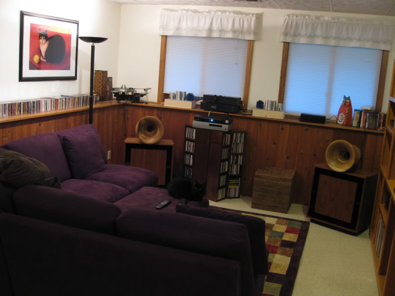

Here is a pic of a friend of mine's set up like what I am trying to do.

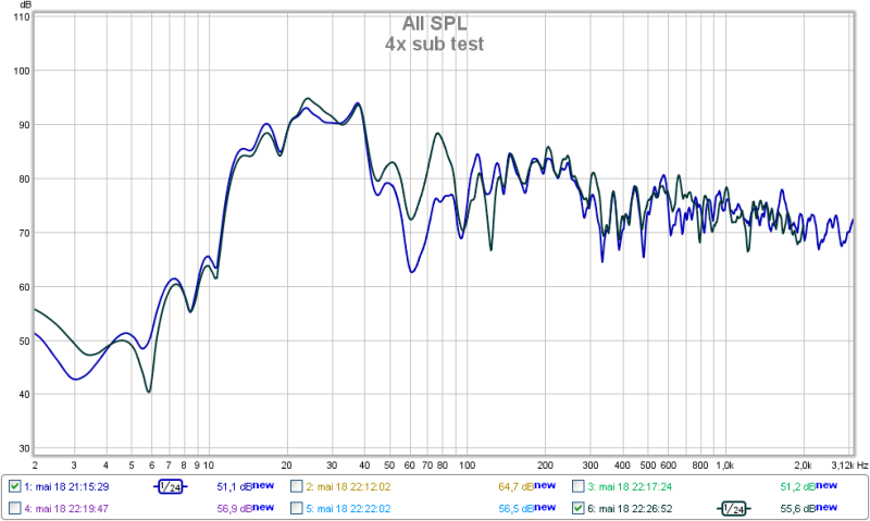

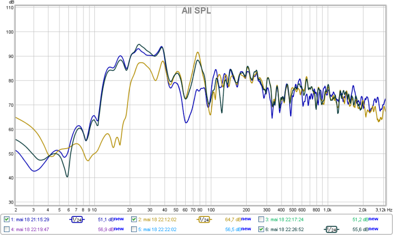

How does it perform - a simple test
Well, how does the Multiple Sub approach perform?
I measured to verify what can relatively easily be achieved by using 4 small subs located using a simple and fast method.
The blue line is a set-up with 2 smaller subwoofers located in the front, close to the mains.
The black line is where I added two Even Smaller subs, located to try fill in the 60Hz null.
attachment.php
As you can see, there is a significant improvement, even though the response is yet far from flat.
The brown line is with 2 Even Smaller subs only.
attachment.php
I listened to this set-up only briefly now, but the improved preformance in the mid bass especially is very noticeable, as bass drums now has much improved attack, and the bass sounds more balanced.
Listening impressions will however always be very subjective, so you should not rely to much on what I think I am hearing - trust the measurements instead.
Location Method for Additional Even Smaller Subs:
I placed one sub in the LP, 60Hz sine on, real-time spectrum anayser, and then took a trip around the room with the mic in my hand, searching for spots where the 60Hz was strong.
You could do just as good using your ears, as there is a clearly audible difference between the bad and the good locations.
This way I found that the front left corner and the rear left corner were good locations with spare room to accomodate an even smaller sub.
Further improvements:
Obviously one could try to improve the room by adding bass absorbers and resonators, you can also see from the measurements that then additional subs did little to remove the peaks and the dips - they only lifted the weak area between 50-100Hz.
Also I think there may be potential in having dedicated DSPs on each sub.
Here I would first remove everything below 40Hz from the Even Smaller.., that could make the response flatter, and it would gain headroom as those too small subs would be relieved.
Hmm.. may be I should try this some day, the DSP is readily available..
